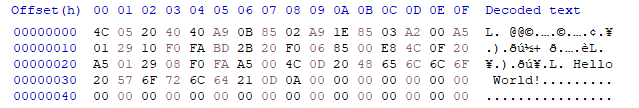

And can you also tell us please what assembler you're using. Also, what do you use to load the AE29f2008-12 with the file produced by the assembler? And what sort of file is it?
I'm using ca65. This is my Makefile
SOURCES = kernel.s
%.o: %.s
        ca65 --cpu 6502 -o $@ -l $(@:.o=.lst) $<
all: kernel
kernel: $(SOURCES:.s=.o)
        cl65 --cpu 6502 -C kernel.cfg -t none -o $@ $^
clean:
        rm -f kernel *.o *.lst
The result is a binary named just as "kernel". I opened this file on HxD program and I'vo got this result. I thinking that is ok.

The 6551 has /CS1 (active low) and CS0 (active high). Presumably you've tied CS0 high?
So you have an assembled object file. How is that getting into the ROM? And given that you have a 2KB address range mapped to the ROM, why is your image 8KB long?
It is a good question .. :roll: But in this case, the 6507 doesn't ignore the rest oh unused ROM?
Chromatix
Joined: 21 May 2018
Re: Writing in EEPROM and reading by 6502
Post by Chromatix »
It does. So think about exactly what vector addresses it's reading, and what happens next.

Hi guys,
I was thinking here, the 6502 processor has as the RESET VECTOR the address FFFC (1111 1111 1111 1100) and FFFD (1111 1111 1111 1101), both needing 16 bits for correct addressing?
Since 6507 has only 12 bits of address, it is correct to state that in this case, the RESET VECTOR would be the FFC addresses (1111 1111 1100) and FFD (1111 1111 1101)?
Chromatix
Joined: 21 May 2018
Post by Chromatix »
Right, the highest 4 bits are simply discarded before they reach the outside world, and the ROM will see them as whatever you've strapped them to. So again, think about where in the ROM the CPU will read its vectors from, and whether your image matches up with that. (Hint: it doesn't.)
