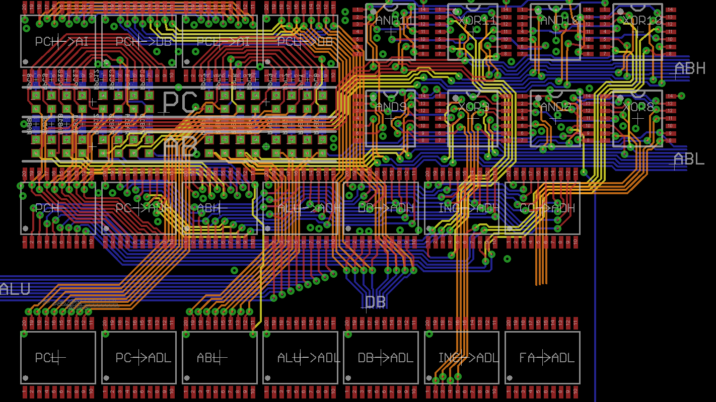

Upper part of the address bus logic done, plus part of lower part. The remaining lower part are the ICs in the bottom row. I've moved that row up a little bit. It could be moved up a little more, but I want to keep some room for wide ground strips and space for some GND vias. I still need to clean up details, and hook up the control signals.
I've marked a few buses going in/out of this area. The AB/DB buses go out to the FPGA, and the ALU bus goes to output of ALU (to the left). The DB/ALU buses also need to go to lower part of address bus.
Lower part of address bus isn't nearly as crowded, so should go a bit quicker.
