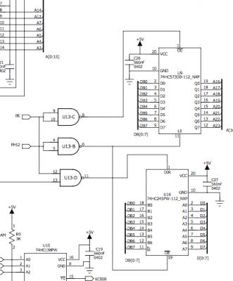

PostPosted: Sat Jan 26, 2019 6:13 pm
And this immediately leads to another point: don't treat the WDC datasheet as gospel. They have often contained errors (some of which have since been corrected), and that diagram is one of them.
The first and most serious problem is that the enable signal to the latch (the '573 or '373) doesn't include the RDY signal. If the RDY signal is driven externally to provide a wait-state, then this circuit may corrupt the high address bits during Phi1 of a wait-state cycle, because the CPU is in fact held in Phi2 state when RDY is low. So that NOT gate must be augmented with something to incorporate the RDY signal.
The second problem, less serious, is that the bidirectional bus driver (the '245) is not required in most designs. You could reasonably leave it in if using the Phi1 phase for video scanout or other DMA purposes, but in that case you'd also need it with a 6502, and it's not specific to handling the high address bits of the '816. In designs where it's *not* needed, it's potentially a performance liability.

PostPosted: Sun Jan 27, 2019 12:07 am
Posts: 1004
It's only a serious problem if you're using the RDY signal externally to provide a wait-state. If you're not, you're not.
It's adequate for many systems. They use a very similar (though not identical) circuit on their '816 board that they sell, and the don't do anything with RDY in that circuit either.
