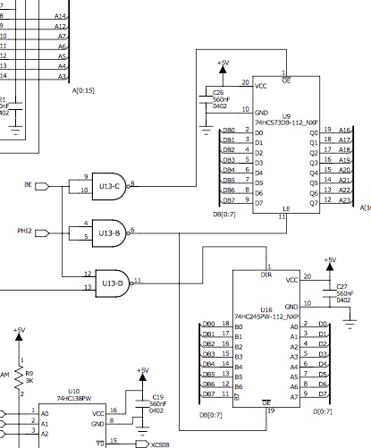

backspace119 wrote:
I've heavily considered using the '816, although there are 2 issues. 1: I've heard something about the address lines being multiplexed on the high 8 bits to get the 24 bit bus while remaining pin compatible with the 6502, I'm not exactly sure how to work with this. 2: iirc the 816 is capable of higher speeds, which I'm not sure I'd be able to give it, not really an issue, just worried I wouldn't get everything I could out of it
WDC has a simple circuit with 2 chips (a 74573 or 74373 and a 74525) plus an inverter that demuxes the Data and Address bus. Page 44 of the datasheet.
Re: 65XX SBC general help and color display help needed
And this immediately leads to another point: don't treat the WDC datasheet as gospel. They have often contained errors (some of which have since been corrected), and that diagram is one of them.
The first and most serious problem is that the enable signal to the latch (the '573 or '373) doesn't include the RDY signal. If the RDY signal is driven externally to provide a wait-state, then this circuit may corrupt the high address bits during Phi1 of a wait-state cycle, because the CPU is in fact held in Phi2 state when RDY is low. So that NOT gate must be augmented with something to incorporate the RDY signal.
The second problem, less serious, is that the bidirectional bus driver (the '245) is not required in most designs. You could reasonably leave it in if using the Phi1 phase for video scanout or other DMA purposes, but in that case you'd also need it with a 6502, and it's not specific to handling the high address bits of the '816. In designs where it's *not* needed, it's potentially a performance liability.
It's adequate for many systems. They use a very similar (though not identical) circuit on their '816 board that they sell, and the don't do anything with RDY in that circuit either.
