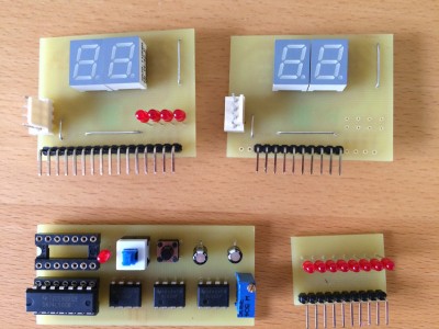

Ax2013 wrote:

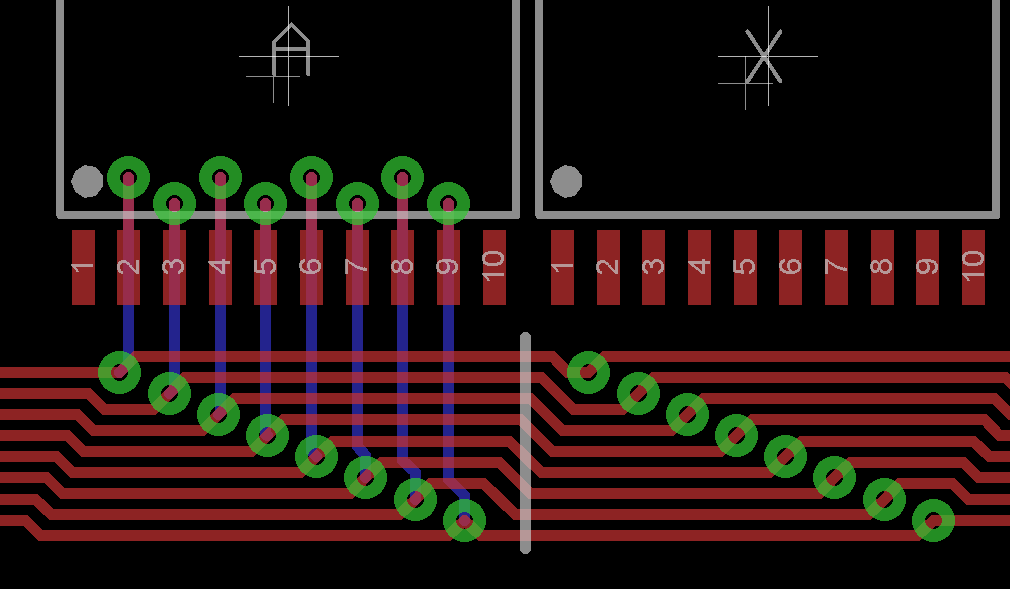

LOL, I was just thinking this morning that it might be cool to have 10 pin header connectors on some signals, so you could plug in a little board with display, in addition to putting LEDs on the main board.
And then i just look through your thread and see this:

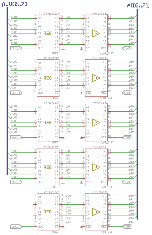

More schematics! The registers A, X, Y, S and M, corresponding to top left corner of block diagram.
Not too exciting, I'm afraid. Still need to insert the blinkenlights inbetween the register and the buffer.

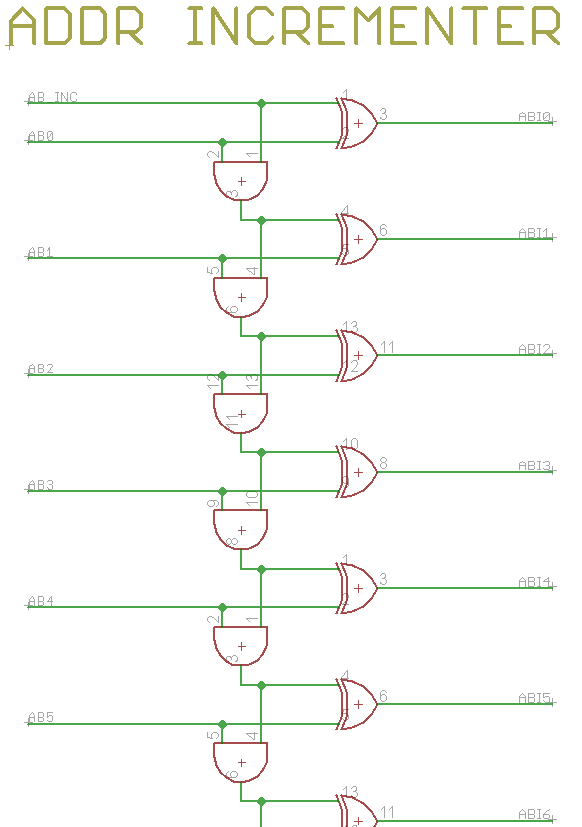

And here's the address incrementer (same pattern continues for 16 stages).
Still need to figure out best gate/pin swaps.

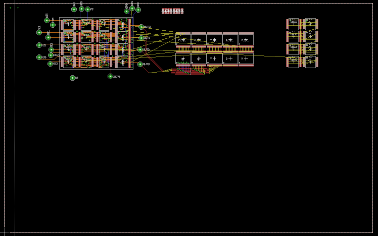

Picture of Eurocard with all components so far on it. Half of the ALU on the left, registers and buffers in the middle, and incrementer on the right. Looks like datapath should fit comfortably on half the board.

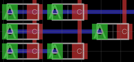

Idea for PLA implementation. Use a diode shape with a regular SMD pad, and a pad with a small via.
You can run vertical wires on one side, and horizontal on the other. Density is 0.75 mm/diode vertically, and about 1.8 mm horizontally based on 0402 diodes.

Is there any hazard to having a pad coincident with a via?
 Post subject: Re: Yet another TTL 6502
PostPosted: Tue Jan 08, 2019 8:20 pm
Yes, the via can soak up the solder, or if the via is closed at one end, then the hot air can expand and create voids.
But nothing that can't be fixed with a hand iron.
PostPosted: Tue Jan 08, 2019 8:26 pm
Posts: 8546
If you assemble by hand, it's not a problem. I did that on my memory modules. The problem comes with automated assembly when they use a silkscreen to squeegee the solderpaste on, and a bunch of the solderpaste goes through the hole and makes a mess. Recently however, assembly houses who can afford the investment are going to a process that's more like inkjetting the solderpaste on, which avoids this problem, or at least minimizes it. (The main reason for the process is that it avoids having to make the screens, and I expect it is also more efficient in production in other ways too.) Another way around it is if you want to pay the extra, they can plug the hole after thru-plating it, and they plate over the plug so you can't even see there's a via under it, by there's a continuous smooth solderable pad there.

When I get to the PLA design, I'll first work out how much lines I need. If necessary, I can use this technique. If I don't need the density, I could do the via-in-pad trick with 0603. I've done that before and it worked well.
0402 that close together is a challange for rework with a hand iron me think. Perhaps hot air might do.
The solder soaking could be limited (but not fully prevented) by using blind vias instead of regular ones.
PostPosted: Wed Jan 09, 2019 4:29 am
Hot air tends to blow those things away. If the problem is only the one pad, it's not so hard because the component is held in place on the other side.
Another option is to fill up the vias myself. If they are all in a grid, I can just rub some paste in the holes without making a mess.
But we'll see. I don't think I have a very large amount of control signals. Also, most of the control signals can be slow, so I can perhaps make a clever solution with a smaller PLA, and some additional logic to combine various outputs. Or use a couple of smaller PLAs. Or use a different state encoding, perhaps with more bits, to make other things easier.
