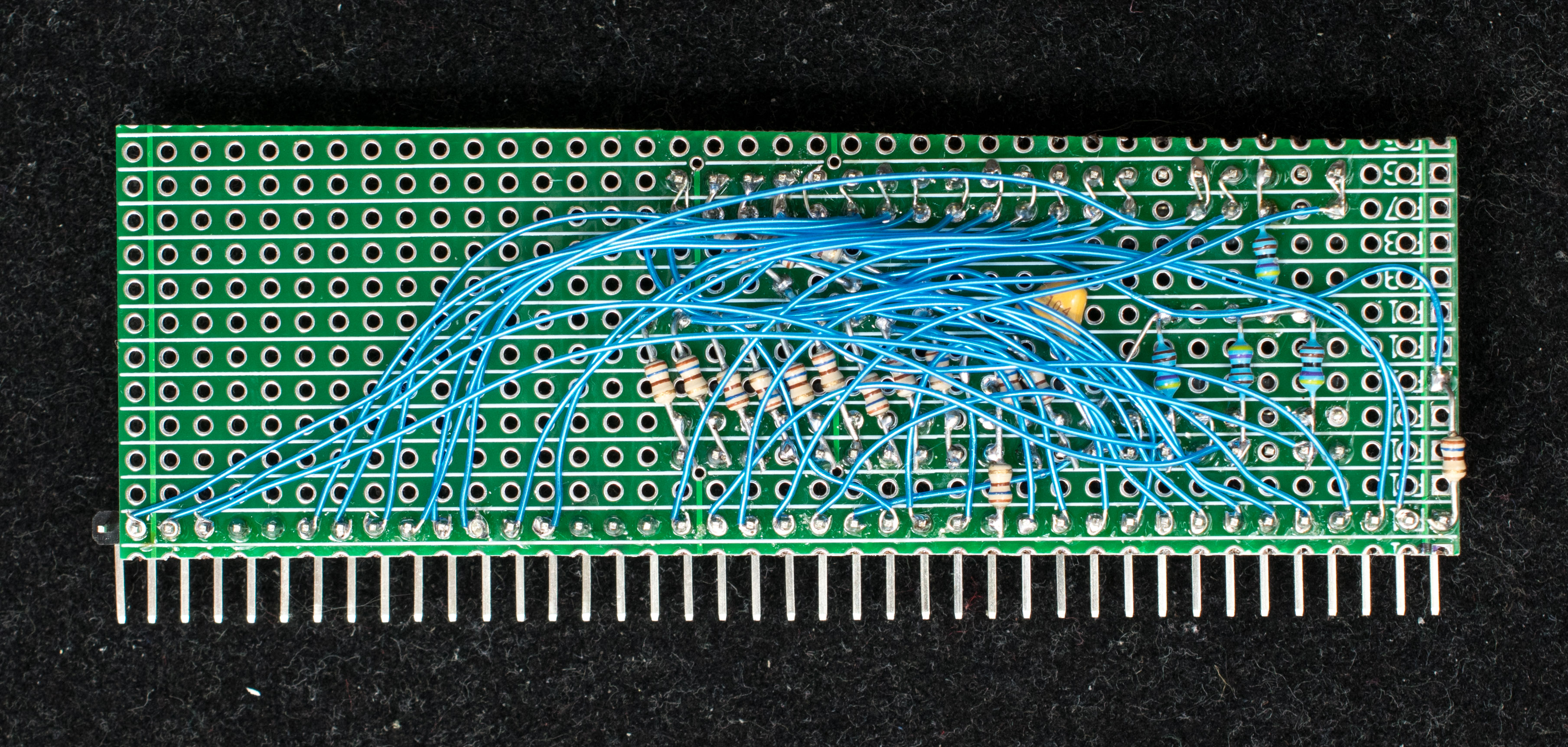

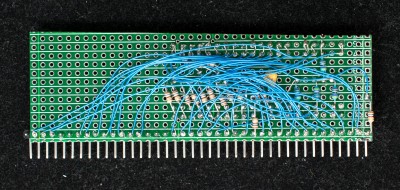

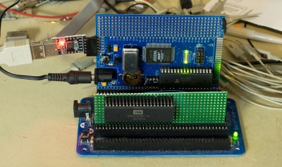

The G8PP platform is designed to accommodate varieties of 8-bit/16-bit processors from 1970's. I have 6 processors in mind: 6502, Z80, 8085, 6809, 68008 and 32008. I've already done the Z80 and 6502 but didn't really want to wire up a single-board G8PP board for every processor, so instead of building all-in-one single-board prototype, I decided I should emulate the RC2014 approach where there are multiple simple CPU boards and a common G8PP baseline board connected via a backplane.
Because each CPU has different control signals and timing requirements, the backplane signal assignments will change depending on the processor used. The addresses and data are the same, so are power/ground, clock, reset, and interrupt. The five Z-80 specific control signals and three spare signals of RC2014 are re-assigned depending on the specific processor. Each processor board is quite simple consists of unbuffered CPU signals connected directly to the 40-pin RC2014 connector.
The common board is the G8PP in baseline configuration. It provides the RESET, clock, battery-backed 512K paged RAM, serial port with bootstrap function, compact flash interface and an Altera EPM7128S CPLD. It also has a prototype area to accommodate additional functions such as RTC, SPI, I2C, etc. The CPLD can be reprogrammed to support different processor's control signals. Such two-board solution has enough functionalities to get CP/M running for the Z80/8085/68008 processors.
Since I've just finished the 6502, I tried out the multi-boards-with-backplane concept on 6502. This is a working configuration with RC2014 Backplane-5.
File comment: Schematic of G8PP in baseline configuration

File comment: 6502 CPU board & G8PP baseline on RC2014 backplane
