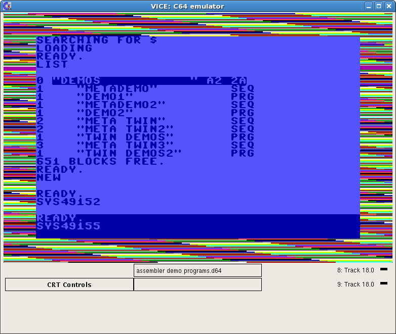

I made some improvements to my metacompiler. With INCLUDE , it can take this sequential file from a C64 disk and compile it with no Forth, no headers, just the assembly code. It then prompts for a filename and spits out a binary to the disk. The demo does what some programs meant to be called from BASIC does, SYS 49152 does one thing and SYS 49155 does another.
HEX  START
C000 ORIGIN
SUB TWIN.DEMOS
   AHEAD,
      0 # LDA,  TAX,
      10 # LDY,
      BEGIN,
         D020 STA,  CLC,  1 # ADC,
      CS-DUP 0= UNTIL,  // CONTINUE
         INX,
         DEY,
      0= UNTIL,
      RTS,
   THEN,
   0 # LDY,  FC STY,
   7 # LDA,  FD STA,
   4 # LDA,  FE STA,
   E8 # LDY,
   BEGIN,
      DEY,
      FC )Y LDA,  80 # EOR,
      FC )Y STA,
      0 # CPY,
      FD DEC,  FE DEC,
   0= UNTIL,
   RTS,
END-CODE
TSAVE
