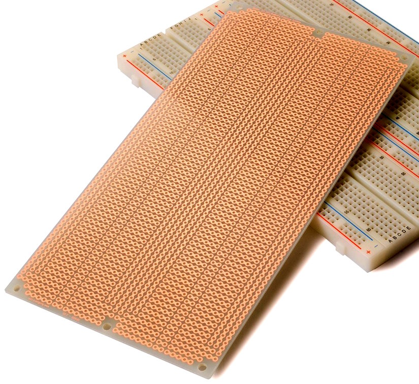

I inherited a few of those boards, but have only used them for tiny stuff. What I like about that kind is that you can set how long you want each trace—although I've always wondered if there was an easy way to cut lots of them like you would need to to make a board like you show here.

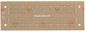

I've used scores of Radio Shack 276-170 solder-type breadboards over the years for analog stuff:
It duplicates the pattern on the solderless breadboards they've sold.

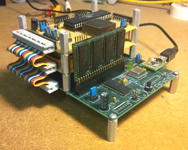

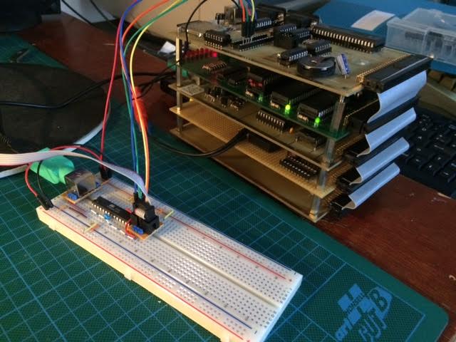

Reusable modules are great. Goals for a home-made computer tend to quickly become too lofty to carry them out in your lifetime—or change faster than you can build. It helps to have various sections ready-made (hence my memory modules, and other tiny ones I hope to offer). For my own use, I have a lot of reusable tiny analog modules so I don't have to keep re-building them for every breadboard. This is about one-third of them:
YES!
This is a great idea and one I have used a lot, especially in microcontroller work. Saves so much time, effort and mess. Works with digital stuff too.

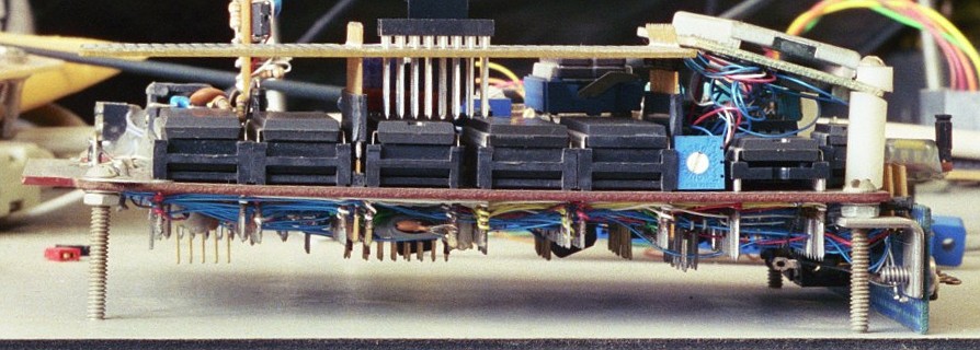

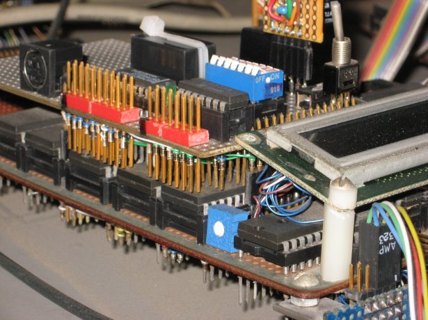

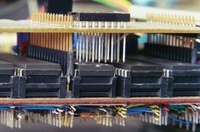

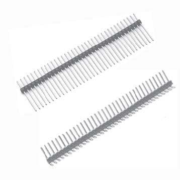

Here's another, for pin headers of .025" square posts with a standard .230" length at one end and longer pins on the other end. I used these for the mezzanine on my workbench computer, both on the mezzanine shown here (before there was anything on it), and down on the main board where the long end of the pins were used for wire-wrapping (between the 40-pin DIP sockets) and I soldered a socket to the shorter end:
The second row is near the right edge of the above picture, and blurry. This following picture shows it slightly better, behind the blue trimmer which is for adjusting the LCD viewing angle:
Here are some Mouser links to single-row ones:
.235" at one end, .410" at the other end
.235" at one end, .610" at the other end
.235" at one end, .910" at the other end
They're kind of expensive, but if you're only doing one-off projects, the time they save you is well worth their price.
You can also get dual-row ones which are good for plugging IDCs onto. This picture shows a couple with red insulators (after the same mezzanine had some circuitry built onto it:

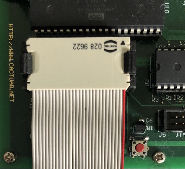

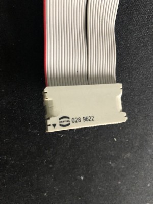

Daryl's SBC4 is another instance of the book-of-pages approach. ( Probably that's where Seymour got the idea! :P )
Seriously, I like the fact that the "book" can be spread open to grant access to both sides of any individual board. :!:
Furthermore, ribbon cable + IDC's are easier to design and build with, compared with connectors soldered into a rigid backplane. Cheaper, too.
(Of course, it's strongly recommended that ground lines be interspersed with the signal lines, regardless of whether your "backplane" is flexible or rigid.)
