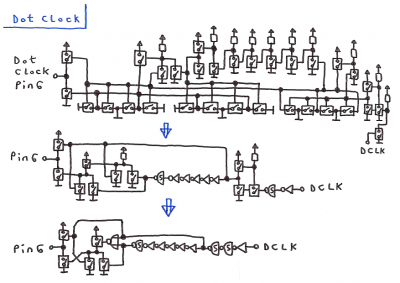

DCLK then goes to the Dot Clock output buffer...
...where some creative tinkering with propagation delay and duty cycle also seems to be done.
Dang: looks like DCLK actually is low_active, please change/fix this when drawing a clean set of schematics.

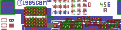

From what I gathered so far, there is some dead\unused circuitry in the 8701R2,
with Pin 4 as input, and Pin 10, 11 as outputs.
The datasheet only tells you, that Pin 4 is GND and that Pin 10, 11 are NC,
and it basically seems to be right.
To me, the whole thing looks like a "conceptual test run" for some chrominance modulator circuitry.
See, there was some empty space on the 8701 silicon, 8701 had unused pins, and color clock was present in the 8701 anyway.
8701 probably was manufactured in a HMOS-2 process.
IMHO adding some test circuitry for something to be built later with a HMOS-2 process to an 8701 and disabling it
in a later revision of the chip might be cheaper than designing an entire chip for "rocket testing" and then packaging it.

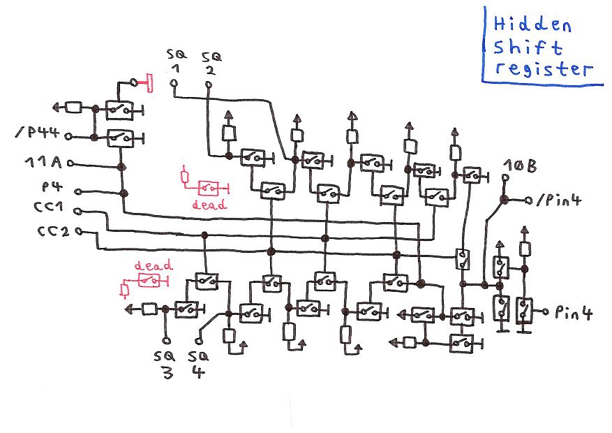

There are two shift registers, which were clocked with that clock generator:
Two dead FETs which seem to be leftovers from a previous revision of the silicon.
Also, we have a FET where the gate probably wasn't connected to GND_Osc from the start.

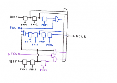

pulse delayer\stretcher drawn a bit differently:

Then we have a LFSR counter which counts 7 steps for NTSC and 9 steps for PAL.
The counter is feeding three big logic gates (and some smaller stuff not shown in the picture at the gate inputs).
One of the gates clears the counter with the 'dinA' signal.
The other two gates generate the signals '#3P' and '#OP', which are active for only one counter step.
Those two signals then are delayed/stretched, then ORed together (actually, it's a big NOR gate instead of an OR),
to get that ca. 8MHz dot clock. (I'm simplifying things here a bit).
The resulting signal isn't symmetrical: 3T high and 4T low for NTSC, and 4T high and 5T low for PAL.
And that's why we have a little bit of trick circuitry in the dot clock output buffer which is "supposed" to make the dot clock "nearly" symmetrical.
The circuitry is a kludge, of course, because the "delta t" time delay at the input of the final OR gate is not different for PAL and for NTSC.
//it isn't an OR gate in the silicon, of course, I'm simplifying things a lot here.
