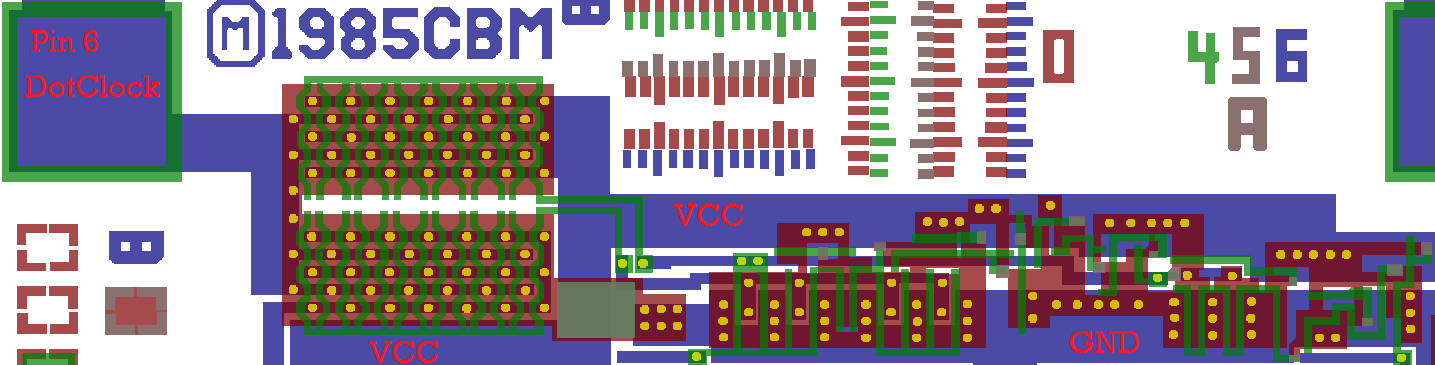

C64: 8701R2 clock generator chip dissected
Re: C64: 8701R2 clock generator chip dissected
DCLK then goes to the Dot Clock output buffer...
...where some creative tinkering with propagation delay and duty cycle also seems to be done.
Dang: looks like DCLK actually is low_active, please change/fix this when drawing a clean set of schematics.

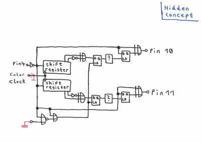

We are through with the official part now...
But wait: there is a defunct bonus level hidden inside that old video game.
Here be dragons.
From what I gathered so far, there is some dead\unused circuitry in the 8701R2,
with Pin 4 as input, and Pin 10, 11 as outputs.
The datasheet only tells you, that Pin 4 is GND and that Pin 10, 11 are NC,
and it basically seems to be right.
To me, the whole thing looks like a "conceptual test run" for some chrominance modulator circuitry.
See, there was some empty space on the 8701 silicon, 8701 had unused pins, and color clock was present in the 8701 anyway.
8701 probably was manufactured in a HMOS-2 process.
IMHO adding some test circuitry for something to be built later with a HMOS-2 process to an 8701 and disabling it
in a later revision of the chip might be cheaper than designing an entire chip for "rocket testing" and then packaging it.
Somebody please check, which came first:
8071 manufactured in a HMOS-2 process, or a CRT controller (like the VIC-II) manufactured in a HMOS-2 process.
To me, those boxes labeled with a question mark don't make much sense. Some open traces in there.
And I would strongly recommend to check if some buried contacts are missing there in the polygonized images.
Edit: shift register is build from switches and inverters. Felt a need to update the schematic after counting those inverters again.
We have a clock generator.
The input of the clock generator had been connected to the /color clock signal in a previous revision of the silicon,
but now it's tied to GND instead.
Means: the clock generator is dead.
There are two shift registers, which were clocked with that clock generator:
Two dead FETs which seem to be leftovers from a previous revision of the silicon.
Also, we have a FET where the gate probably wasn't connected to GND_Osc from the start.
At the output of every shift register, there is an XOR gate feeding a transparent latch:
Like I had said above:
to me the circuitry between the XOR_gates\latches and the output drivers for Pin 10, 11 doesn't make much sense.
I'm not even sure, if it had worked at all.
Maybe buried contacts are missing in the polygonized images, because they are really hard to spot in the microscopic pictures.
Some traces in that area which go to nowhere, maybe some part of the circuitry went removed before revision 2.
Maybe the circuitry has never worked at all, who knows...
...And that's why I didn't see the need to waste any more time and effort with it.
But the output drivers for Pin 10, 11 just seem to be XOR gates with boosted outputs:
They are placed differently on the silicon to make better use of the space available,
but to me the circuitry for the Pin 10 and Pin 11 output drivers looks identical.

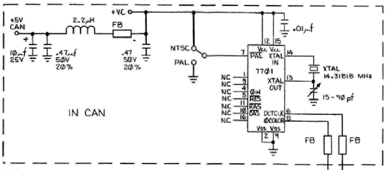

And now for a (very simplified) block diagram of the 8701R2:
We have an oscillator with an external crystal.
// In theory, it could be possible to leave pin 13 open, and to feed a clock signal generated by a TTL "metal can" oscillator through, let's say a 100Ohm resistor, into pin 14.
Oscillator input is feeding the color clock output buffer which emits the color clock at pin 8.
Oscillator input also is feeding a clock doubler, which then feeds that clock generator generating the PHI1 and PHI2 signals used for clocking "the rest" of the 8701 latches.
//Note, that "delta t" here is differently for NTSC and for PAL.
Then we have a LFSR counter which counts 7 steps for NTSC and 9 steps for PAL.
The counter is feeding three big logic gates (and some smaller stuff not shown in the picture at the gate inputs).
One of the gates clears the counter with the 'dinA' signal.
The other two gates generate the signals '#3P' and '#OP', which are active for only one counter step.
Those two signals then are delayed/stretched, then ORed together (actually, it's a big NOR gate instead of an OR),
to get that ca. 8MHz dot clock. (I'm simplifying things here a bit).

I don't know about the 8701, but in the 7701 it is for /RAS and /CAS generation. This is evident in the c64_plus_schematics.zip archive that can be found on Zimmers.
But as every video chip Commodore made after the MAX machine could generate /RAS and /CAS themselves I don't think this feature was ever used.
Hi itsP, and welcome to our forum
Thanks for digging out the thread for solving this old riddle.
RAS\CAS generation is the most likely explanation.
It's always sort of an adventure to dig into these old chips,
they sometimes contain some odd/unexpected stuff.
From the fragments of the unused/dead circuitry,
it was hard to guess what the intention of the designers had been...
