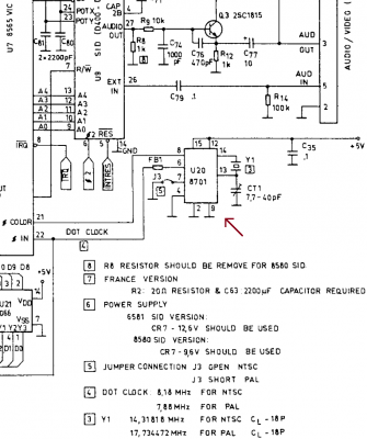

This thread is about the innards of the 8701R2 (revision 2) clock generator chip (used in the C64).
For instance, it was used in C64 motherboard 250469 rev. B:

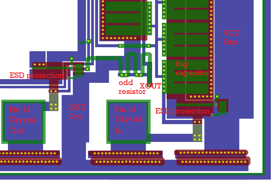

Second picture: (South to Nord)
Two pads for connecting the external crystal, Input and output.
ESD protection for these pads.
An oddly shaped resistor in the Crystal output signal before it goes to the output pad,
and some part of the big capacitor connected to the Crystal input pad.
Note, that ESD protection for the output pad is connected to GND instead of GND_Osc to simplify the chip layout.
About that oddly shaped resistor in the oscillator output
(PolySilicon "snake" nailed to a metal trace with vias):
I think the designers wanted to be able to increase the resistance without changing the layout by just removing vias, starting from West to East.

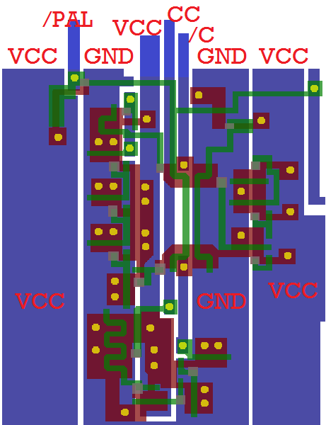

When following the /color signal, we enter an area which (from the logic design point of view)
only contains 4 superbuffers:

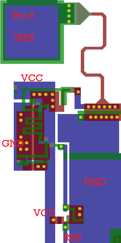

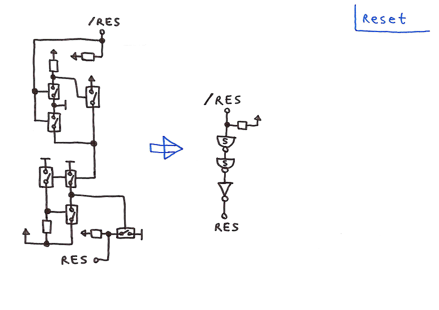

I nearly forgot:
Pin 5 is the /RES input, low_active reset signal for the shift register which works as a counter for generating the Dot Clock.
Since there is a pullup resistor inside the chip for Pin 5, Dot Clock generation will work when the pin is not connected (outside the chip).

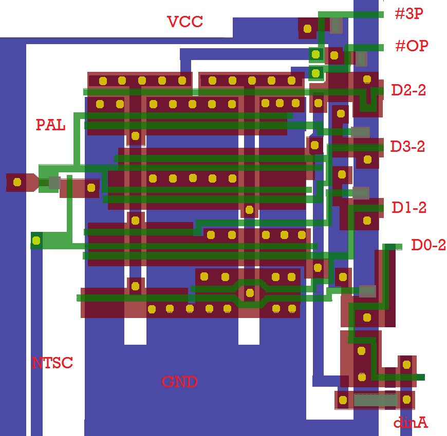

Second, we have a shift register which works as a counter.
Edit: error fixed, there were two latches too many in 8701_cnt2_3.
