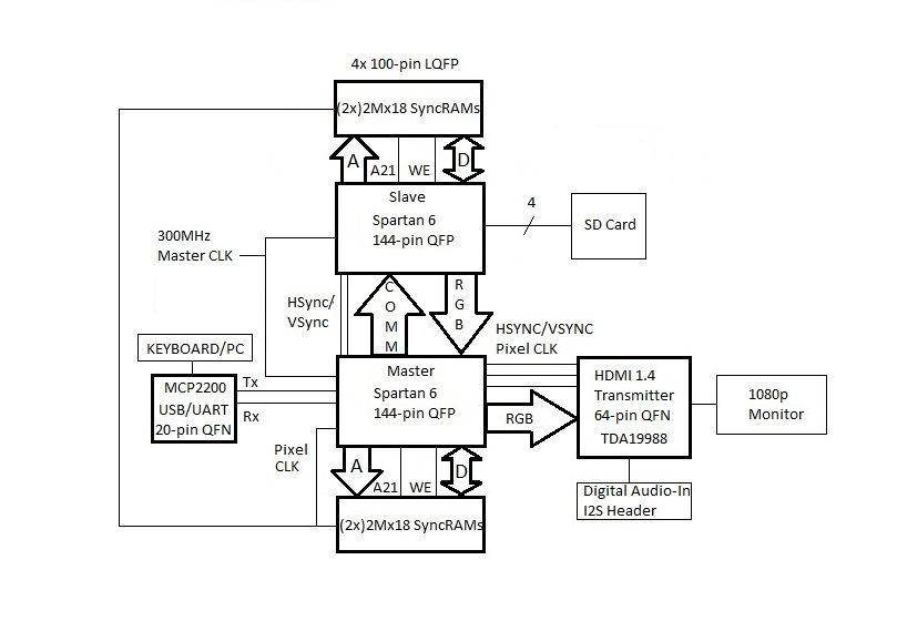

Sorry for the slow progress but I finally got around to the availability of I/O pins on the bottom Master Spartan 6. Great news is that there should be about 22 pins available for the communications port going to the Slave Spartan 6. Wide enough to place a 4M address...
All this is for future development purposes as I'll be concentrating initially on the 65Org16 Assembler, not graphic state machines except for maybe character magnification. But if I spend the time and $$ on the board design I would like it to have as much potential as possible with those IC's so please bear with me at this development stage.
A few changes to the General Layout:
1) Master and Slave Spartan's are labelled and keyboard/PC interface is attached to the Master.
2) The MCP2200 USB to UART has replaced the FT232. Using the VQFN package, 5mmx5mm.
3) HDMI Transmitter has been relabelled. I still have yet to show programming connections from the slave Spartan 6 to this IC. Another QFN package.
4) There is now a common pixel clock among all the SyncRAMs so everything is guaranteed to be synchronized.
5) SDHC has been chosen for large/fast file transfers. It's looking like a SPI core? I hope I can do this!

Block diagram looks nice. (Do we need buffers\level_translators between FPGA and SD card ?)
BTW: It's a pity, that TDA19988, ADV7511 and TFP410 have different pinouts\packages. (Because availability of these chips may vary.)
PostPosted: Thu Aug 30, 2018 1:28 pm
One nice thing about Xilinx FPGAs is you can spec the I/O voltage levels per pin. For those SyncRAMs that I was able to find, I have to set those I/O pins at 2.5V. For the TDA19988 interface, those I/O pins have to be 1.8V. Most everything else will be 3.3V which is max output voltage. You can also specify slew rate as Fast or Slow and also spec output current per pin.
The ADV7511 looks nice but has 100 pins vs 64. The TI part looks like it's geared for DVI connections, 3 of them which is interesting.

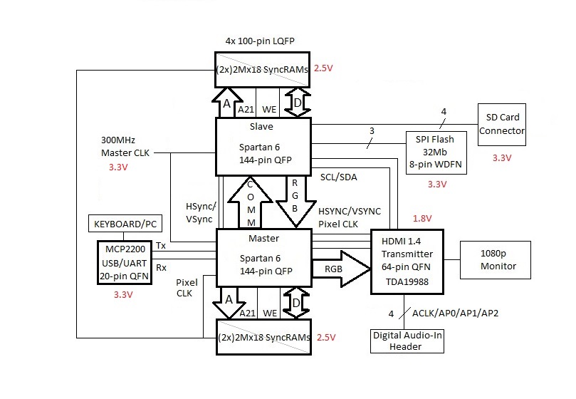

This is probably going to be the last block diag I work from in order to start the board routing. Will be 4 layer, size yet to be determined. I'll show my setup on how to solder QFN packages and individual SMD cap's and resistors when that time comes!
Last major addition was the 32Mb SPI FLASH for non-volatile storage. Will try to find one larger in size, but this one is only $4.50US. Why not add it? All I/O is just about Max'd out on both Spartan 6's.

I started to panic a little today with all those different voltages. My last project, everything was using the Xilinx 3.3V LVTTL spec. I was reading the UG381 IOB spec today and for this project I'll be using the LVCMOS spec which allows 1.2V, 1.5V, 1.8V, 2.5V and 3.3V. It's sort of difficult to read but I believe any pin per IOB can be assigned any of those voltages, as long as the entire IOB is using the LVCMOS spec. Can anyone confirm this?
In preparation for my worst fears, I made most everything a 1.8V standard, the SyncRAMs are capable of this. The UG381 guide also mentioned to use LVCMOS when performing FPGA to FPGA communication so I'm confident there.
I'm going to run a project through ISE and experiment with the constraints file in order to see if it generates any errors.
Also, I may lose a few pins on the Inter FPGA Comm channel. There are some multi-function pins that are best left unused for 100% reliability. Still doing research.
