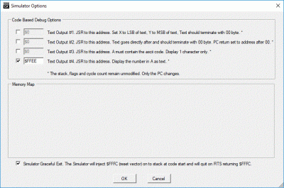

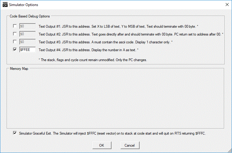

Not got that (yet) for input, but I do have something similar output-wise. I have simulator options which cause JSRs to specified addresses to be intercepted and display things in the assembler output window. Here's a screen shot. Got to admit the descriptive text needs a bit of work (as does the layout - all being rearranged atm), but I hope you get the gist. These special modes can be enabled by command in the source code as well as in the GUI:
Syntax:
SimOptText <mode> <status> <intercept address>
E.g.
SimOptText 4 Enable $FFEE
With regards the I/O mapping:
I think having this would be handy for trying basic I/O stuff so am proceeding with VIAs and will then look at ACIAs.
So far I've built some structures for up to 4 VIAs, adding in an abstraction layer for RAM read and writes so I can intercept stuff forIO, ROM, etc and have implemented partial access to VIA registers.
No GUI, timer, etc. stuff for VIA interaction and still got to do the IRQ stuff. Getting there.
