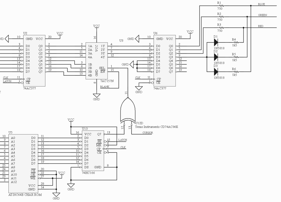

The AC '377s have come in today so I'm going to try them out soon, since I don't have any 163s etc on hand I'll just try another 377 at the output
Since I could only get the 377 in SOIC-20 space is no huge concern
Does this look right?
I think BLANK and CURSOR will need to go through a flop in the cpld as they would otherwise come almost 1 character-time early, of course another option is to change the counter match values but the good thing about the CPLD is that I can change that quickly and easily.
:edit: Corrected the diagram, the '157 is AC and the 166 is unfortunately HC as I wasn't able to find any 166's in AC logic
PostPosted: Mon Aug 27, 2018 3:40 am
Looks good! :)
Yet another option for BLANK and CURSOR is to delay them using the unused sections of the new '377.
Edit: oops, bad idea :oops: That '377 updates once per pixel. You want BLANK and CURSOR to update once per character.
Probably the best choice is to change the counter match values, as you say.

Yeah actually I might route BLANK and CURSOR through the '377 because it'll use less resources in the CPLD and those flip-flops are free
I had a look for AHC,ACT etc on element14, mouser & Digikey but didn't find anything. I suppose if the HC isn't fast enough I can probably use a '299 which is available in AC but we will see how I go I guess
PostPosted: Mon Aug 27, 2018 4:47 am
'AC299 is a good idea. But my suggestion about unused '377 sections isn't. See the edit to my previous post. :|

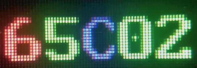

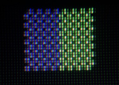

It works! Looks really good too!
I had to swap the A/B inputs on the mux (I was using the inverted Q on the old shift register because it made for a cleaner schematic) but that's cool.
PostPosted: Tue Aug 28, 2018 12:05 am
Nice to hear about your success! :)
Are you using 'HC166, then? And did the CURSOR and BLANK signals get sorted out?
PostPosted: Tue Aug 28, 2018 12:27 am
Posts: 172
Location: Sweden
Yeah using a HC166 and it looks good so far. I'll create some test characters with one pixel on the left/right etc to be sure but it's noticeably sharper and no edge artefacts like I was seeing before

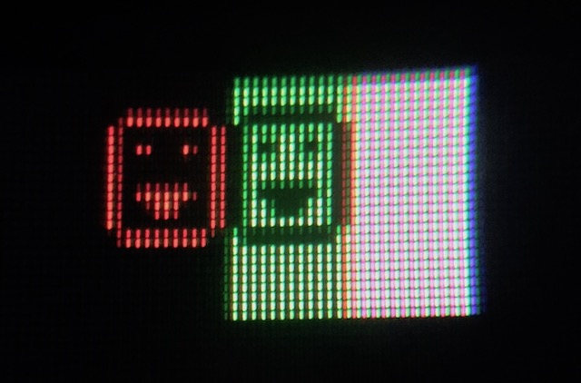

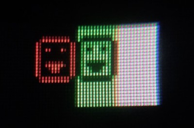

Yep after doing some tests it appears to be working perfectly
Here's some shots from the monitor. I wish I had a CRT hanging around as I'm sure it'd look better without LCD scaling
