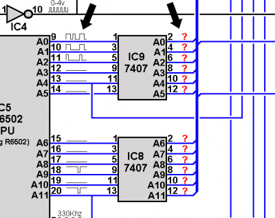

On another topic, here's something easy you can check, Sergio. The signal on pin 2 of IC9 should be much the same as the signal on pin 1 -- and likewise for every signal passing through IC9 and IC8. If any signal fails to reproduce then it could indicate IC7/8 defective, or a short in any of the six memory chips or the connections to their address inputs.

I'm not 100% convinced those tiny images can be blown up and interpreted as literal truth like the readout of a logic analyzer.
That is why I haven't try to interpret these drawings in depth. It is too easy to get a time shift between different measures.
What puzzles me is the "no activity" of the SY6502 and the R65C02. The SY6502 (I assume it is the original CPU) may be dead. But why should the CMOS one don't work at least a few cycles? The only reason I see is it stays in RESET. (The R65C02 does not provide signals like BE or /ML so it should run.)
A 40/60% clock is simply a violation of the specifications of the datasheets - at least for the SY6502. Further it narrows the address setup window for the VIA to nearly null. I never played with the duty cycle of PHI0. I don't know if there are CPU internals start to behave weird under such circumstances. Using a 50/50% clock simply would cease this possible cause of errors.

There are few address busses with no activity at all. [...] All those pulses are absolute static, I mean, there are no dynamic activity (like data flowing) in any bus.
Sergio, if I understand properly then you mean there is a pattern of pulses but the pattern never changes, is that right? And, is it true the main pattern is 6 clock cycles long, and that SYNC has a pattern of going high once every three cycles? I would like to double check this, please (as well as the signals on IC9 and IC8 I mentioned in my previous post).

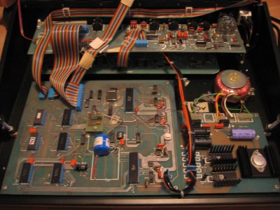

More photos here.

And thanks Jeff for the pictures! What a waste of space :shock: Today such vast pcb's would cost a fortune.
PostPosted: Mon Aug 27, 2018 7:01 am
Posts: 1429
PCB material looks high quality indeed, IMHO the problem can't be caused by a hairline crack in a PCB trace.

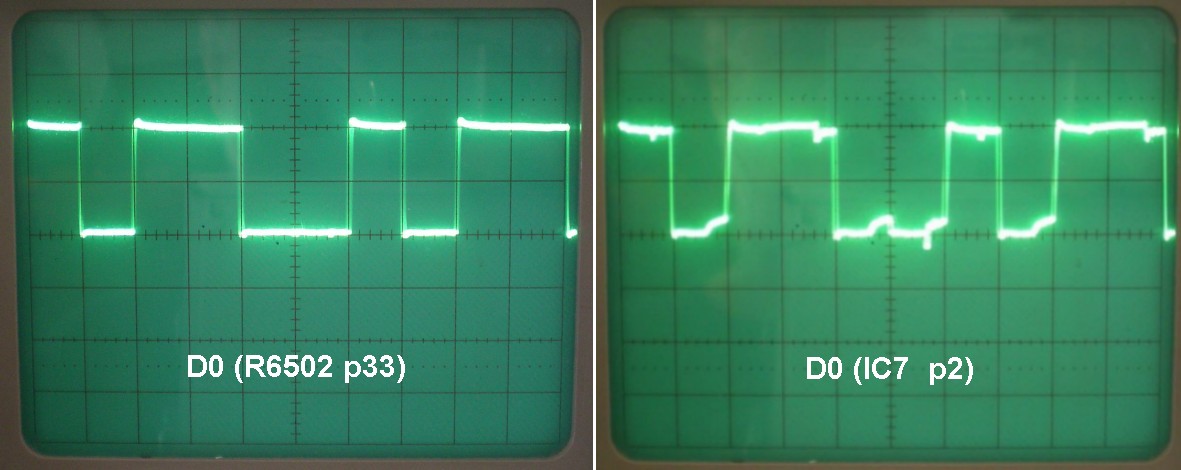

- The F3 input connected to NMI pin has clean +5v on power-up occurs, and after the RESET time it acquires a very high amount of digital noise around those +5v (maybe 0,5 to 0,7v amplitude of noise).
- In the VIA, PA0 to PA7 are in high level with no activity at all. CS1 shows one pulse cycle each 6 clock cycles (similar to A2 address bus waveform) after the RESET time. CS2 shows the same behavior of CPU's NMI pin described above.
- I've tested the continuity of 40pins flat cable ("F" connector) and they are OK. The three 16pins flat cables were tested a lot of times. In fact I've soldered one end of each of them to the smallest related board, to reduce a 50% the contact problems of those unreliable 16pins IC-format connectors.

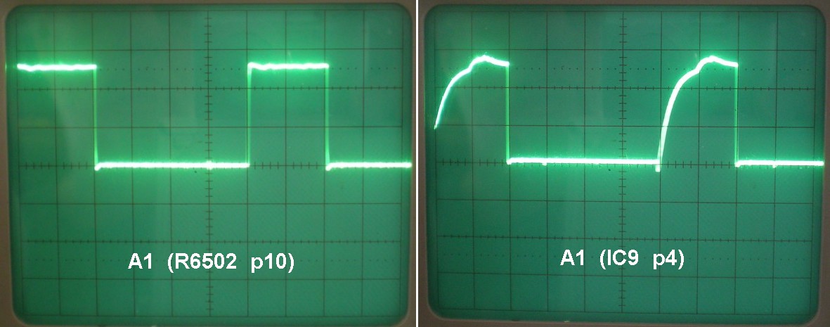

- About the buffers on the address bus outputs (IC8 & IC9) and the transceivers on the data bus ones (IC7), I did some oscilloscope photos to show you the signal of those busses before and after those stages. The distortion shown in A1 is the same in A0, A2, and the rest of active address busses.
Same happens with data busses. Distortion seen in D0 is the same in rest of data busses. That distortion is entering by the pin 1 (DIR) of IC7, and cames from R/W signal in the segment between the pin 22 of VIA and pin 4 of IC22, but not before that inverter.
- I observed that one cycle in all the busses are equivalent to 6 cycles of 1Mhz clock.
- I don't have a logic analyzer, however, the readouts in all the busses are very statics, like I shown in the schematic.
I'm trying to be as accurate as possible in my observations, I hope it helps to give you some panorama of this dead machine.

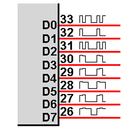

( It looks as if it should be possible to read the successive bus values from the drawing by repeatedly drawing a vertical line and assembling those 8 bits into a byte. Do that 6 times and you have the entire 6-cycle sequence. But the bytes spell out a sequence that no 6502 in its right mind would ever perform! :) Here's why it's nonsense. The waveforms for the individual bits have gotten skewed, timewise -- they don't line up with one another, horizontally. We see they're all shown as beginning with a rising edge, and that seems like a clue. I believe the oscilloscope was set to trigger on the signal that's being observed -- not on an independent, unvarying signal that can serve as a reference. )
Following up on Chromatix's suggestion, here's what I think appears on the address bus and data bus for each cycle of the 6-cycle pattern. Anyone who's curious can print the values in binary then vertically read each column to verify the sequence matches the corresponding waveform (or a skewed version thereof) from the drawing. I haven't checked the actual sequences but the number of 1's in each of the eight columns is as it should be.
  • $FA00 - $A6 - opcode of a LDX z-pg instruction
  • $FA01 - $01 - operand for the LDX
  • $0001 - $01 - here's where the CPU tries to read location $0001, but no device responds
  • $FA02 - $D0 - opcode of a BNE
  • $FA03 - $FC - operand of the BNE
  • $FA04 - $A9 - a "dead cycle" fetch performed as the CPU digests the branch taken
It's doubtful whether this loop at $FA00 is what the CPU ought to be executing. With no RAM, all bets are off! But at least the CPU seems to be behaving rationally, and I find that reassuring with respect to the question about clock duty cycle. (If the behavior were irrational, that could plausibly be the result of seriously bad duty cycle.) But if a 1 MHz oscillator can be obtained then maybe it's a good idea to install it anyway.

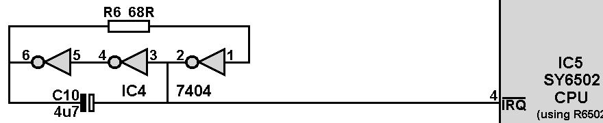

Sergio, to me the connections for IC4 (7404) in the schematics look odd.
Starting to wonder, why C10 (4u7) is connected to two output pins of IC4.
Please check if the schematics are correct there.
Would be interesting to know, what the frequency and the duty cycle
of the square wave signal at the /IRQ input of the CPU looks like.
If something goes wrong there, the CPU might go into an "infinite loop".
BTW: PCBs look amazingly clean for a battery leakage, good job on that !

Agreed, it's worth measuring the IRQ input waveform.
If that were a simple RC delay - and it isn't - the time constant is about 0.3mS, which would make for a frequency of about 3kHz. It's going to be very imprecise, but presumably is used for keyboard scanning or display refresh, which is not too timing critical.

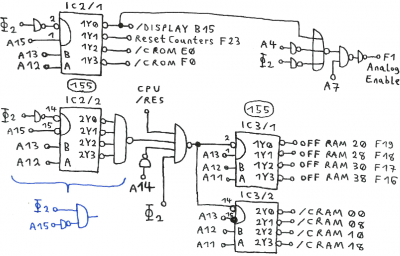

Now for that address decoder:
0000.0xxx.xxxx.xxxx  $0000..$07FF  /CRAM_00
0000.1xxx.xxxx.xxxx  $0800..$0FFF  /CRAM_08
0001.0xxx.xxxx.xxxx  $1000..$17FF  /CRAM_10
0001.1xxx.xxxx.xxxx  $1800..$1FFF  /CRAM_18
0010.0xxx.xxxx.xxxx  $2000..$27FF  OFF_RAM_20 F19
0010.1xxx.xxxx.xxxx  $2800..$2FFF  OFF_RAM_28 F18
0011.0xxx.xxxx.xxxx  $3000..$37FF  OFF_RAM_30 F17
0011.1xxx.xxxx.xxxx  $3800..$3FFF  OFF_RAM_38 F16
01xx.xxxx.xxxx.xxxx  $4000..$7FFF  empty space
1x00.xxxx.xxxx.xxxx  $8000..$8FFF, $C000..$CFFF  /DISPLAY B15
1x01.xxxx.xxxx.xxxx  $9000..$9FFF, $D000..$DFFF  ResetCounters F23
1x10.xxxx.xxxx.xxxx  $A000..$AFFF, $E000..$EFFF  /CROM_E0
1x11.xxxx.xxxx.xxxx  $B000..$BFFF, $F000..$FFFF  /CROM_FO
1x00.xxxx.1xx1.xxxx  $8x9x, $8xBx, $8xDx, $8xFx, $Cx9x, $CxBx, $CxDx, $CxFx  AnalogEnable F1
Sorry for the poor quality of the picture:
