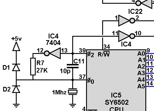

The crystal clock circuit has a very rare configuration, with one of the crystal legs connected to ground. I never seen such crystal connection in any other microcontroller environment. Have you understand is a coherent crystal circuit? (I've attached that part of the circuitry)

That crystal oscillator circuit uses the parallel resonance mode. If the crystal would be placed parallel to R27 (but with a different resistor value) then this is the far more common series resonance mode.
I second Garth - if there is no stable signal at IC4p10 then try a new crystal. They sometimes cease to work. If this still doesn't help, try a "new" CPU.

The 1Mhz clock is present in both pins (37 & 39) but in the 37 one it is very weak. I need to set my oscilloscope test probe in "x10" to measure it (maybe reaches 3.3volts). So, I don`t know if the clock generator is fully reliable or not.
I will perform the measurements you are suggesting me... basing in the RC6502AP.

The "weak" signal on p37 is OK (BTW use always 10:1 mode, although 1 MHz isn't really much the probes capacitance might destroy the signals integrity too much). Important is a stable 1 MHz clock nearly 50% on and off at p39. If that works with NMOS and CMOS CPUs that should be fine.

If you're willing and able to make modifications, then disconnecting pin 37 from the circuit and injecting a nice clean 5V 1MHz clock might be worth doing. (That's 0V to 5V, not 5V peak-to-peak! Edit: I mean, a digital signal, not one which swings both sides of zero.)
If it does turn out that the crystal + R + C + inverter is failing to make a good clock, and otherwise all is well, then patching in a crystal can oscillator might be a good move - again, if you're happy to make changes.

Do you think I would need to try with a most reliable crystal clock circuit, as it shown in the SY6502 datasheet (fig.2)

The 60/40% duty cycle of PHI2 (CPU,p39) is not very well, perhaps you should use a different oscillator (a can osc. or that circuit you suggested) to achieve 50/50% somewhat better.
