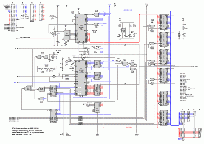

I've attached the full CPU board scheme (fig.1). It was re-drawn by me, because the original one looked like a caveman painting.
In addition, I drawn the most exactly representations of digital waveforms presents in all I/Os of the R6502AP I'm using now. There are few address busses with no activity at all. BTW, the data busses pulses goes from 0 to 4v, and the address ones 0-5v.
All those pulses are absolute static, I mean, there are no dynamic activity (like data flowing) in any bus.
If I use the CMOS version, R65C02, or the original SY6502, there are no activity at all in address and data busses (except for 1Mhz in pin 39).
Years ago I've changed the sockets by mechanized-holes ones, the electrolytic caps and all TTL chips are news (and socketed, too). I've been suffering too much time with this machine, so I had time to make all this replacements.

Thank you for posting this schematic - great job! Your measure of the voltages does look very well, these values appears "normal" to me. I don't think that there is something broken.
There are some interesting (or strange) details in that schematic :)
I wonder why they have two reset circuitries - one for the CPU around IC24 and one for the VIA (IC12) using a 555 that can be triggered by a pushbutton? But I assume you have verified that both RESet signals start with "0" and the turn to "1" briefly past power on.
There is an alien signal called "F3". It is connected to the "/NMI" input (p6) of the CPU. It is necessary that this signal is "1" during the start procedure - if possible disconnect it until some more activity is achieved. There is R26 that pulls this line up to 5V. So just disconnect F3 from whatever there is attached.
The 60/40% duty cycle of PHI2 (CPU,p39) is not very well, perhaps you should use a different oscillator (a can osc. or that circuit you suggested) to achieve 50/50% somewhat better.
There is a battery (or accumulator) to pull up the /CS of each RAM. Again I assume you have checked this being working or replaced it already.
Replacing old sockets and electrolytic caps you have done already - good.
Have you a tool to read out the contents of the EPROMs ? IC21 should deliver at least the first two bytes (the so called RESET VECTOR) for the CPU, so it knows where the main program is located. The addresses are $FFFC (low part of the program start address) and $FFFD (high part). They are fetched from the EPROM immediately one after another. And then they are used to fetch the first instruction. This address should be somewhere in the range from $E000 up to $FFF8 as that is where the EPROMs are placed. Perhaps you can figure out what is going on during these first 10.. clocks after CPU /RES is "1".

Great job on the schematic! I'm particularly interested in the waveforms you included here. I can't be certain but I believe these waveforms may be normal.
It is common for a program to execute a loop when it is waiting for something, such as a certain condition detected in one of the devices attached to the CPU. The CPU is always fetching instructions, and in this case I suspect the instructions cause it to read from an attached device then examine the result. If the result indicates more waiting is necessary then the program loops backwards and repeats itself. This explains why A3 ... A8 have no activity. It's just the same few instructions that get fetched again and again, plus a read from the attached device.
Here is a slightly different theory. It's possible the attached device is supposed to trigger an interrupt, and the associated program -- the Interrupt Service Routine -- is supposed to leave a message of some kind in Random Access Memory. But until that happens the main program will keep examining memory, waiting for the message to appear. I know it may sound strange, but the CPU sends a message to itself -- that's quite common. So, you'll see the same few instructions that get fetched again and again, plus a read from RAM.
Anyway, I suspect that certain basic functions are OK, such as the oscillator, the CPU and the power supply. I think the fault may be associated with one of the attached devices such as the 6522 VIA. For example:
  • the device may not be getting a chip-select signal from the memory decoder
  • the device may be getting a chip-select but failing to respond (ie, it is defective)
  • the device itself may be waiting for a signal from some other device
What sort of waveform is present on the chip-select input of the VIA? If it seems to pulse low once during every sequence on A2 ... A0 then that confirms the program is polling the VIA.
Are you familiar with how the SDS6 percussion sequencer should respond when it's functioning properly? Can you speculate what the program may be waiting for? If you imagine what is supposed to happen then maybe that will be a clue.

As best I can work out from the data lines, the CPU is not repeatedly resetting or interrupting (SYNC every 3 cycles is too often for that), but is being told to execute LDA $81 repeatedly. LDA zp is the only opcode formed by the observed signal sequence that takes 3 cycles to execute; the others are SED (1 byte, 2 cycles), STA izx (2 bytes, 6 cycles), the illegal $FF which should apparently take 7 cycles, and BRK which forces an interrupt and takes 7 cycles. If R/W was monitored, I could be more sure.
However, the A7 line never goes high, and it should while executing LDA $81. Moreover, the low-order address lines are not cycling in a sensible sequence for consecutive 2-byte instruction fetches every 3 cycles. So *something* weird is happening here.
I wouldn't worry too much about the 60/40 duty cycle on the clock; it's only 1MHz, and probably did that from new given the simplistic design of the oscillator. At higher speeds you'd probably want something cleaner, sure, but 60/40 was probably considered good enough back then.
You could try wiring up the CPU to execute NOPs (opcode $EA) outside of the faulty machine, as a way to verify that it really works.
