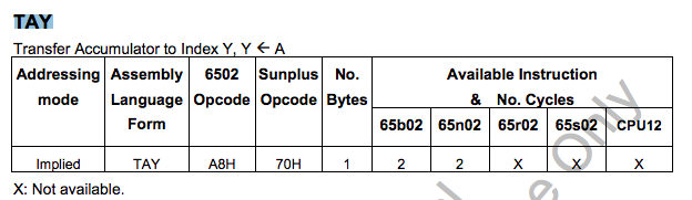

...but I just fail to spot an instruction set where the Y register is missing.
Yes, see for example TAY, the instruction has cycle counts for two flavours of core but an X for the reduced flavours.

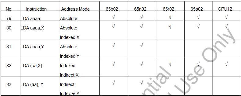

When taking a closer look at the addressing modes for LDA...
Aha: _all_ variations of LDY are missing for 65r02, 65s02 and CPU12... plus quite a few other instructions.
