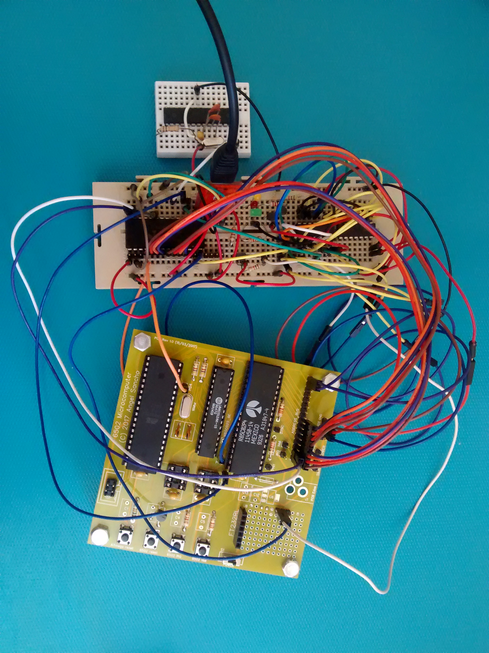

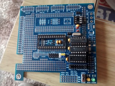

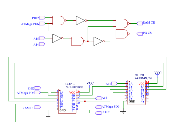

Hi,
The 65c51 arrived yesterday and it is running fine! :D
For the moment, as I don't have some glue logic IC's yet (74HC30 and 74HC138) to do Daryl's SBC 2.5 address decoding and now I am only using one I/O IC I am using the one that Garth shows in his primer, modified for my system:
I have tried it up to 4Mhz and it works well, despite the mess of long wires I have and that the 65c51 it's a 2Mhz part.
The bootstrap code I'm using is that simple:
.org        $8000
BOOT_START = $E800 ; start of atmega mapped ROM
BOOT_END   = $0000 ; end of atmega mapped ROM+1
STZ         $8888         ; tell ATMega we are at boot start point
BOOTSTRAP_INI
        LDA     #<BOOT_START
        STA     $E2
        LDA     #>BOOT_START
        STA     $E3
        LDY     #<BOOT_END
        LDX     #>BOOT_END
BOOTSTRAP_LOOP
        LDA     ($E2)        ; read from ROM
        STA     ($E2)        ; write to RAM
        INC     $E2
        BNE     BOOTSTRAP_LOOP2
        INC     $E3
BOOTSTRAP_LOOP2
        CPY     $E2
        BNE     BOOTSTRAP_LOOP
        CPX     $E3
        BNE     BOOTSTRAP_LOOP
        STZ     $8889          ; tell ATMega we finished
        JMP     ($FFFC)        ; jump to reset
The ATMega have virtually mapped this code into their flash in $8000 and Daryl's SBC monitor into $E800, during the boot process the atmega drive phi2 manually and controls the glue logic so all the read from bootstrap and ROM ranges are made to it, and all the writes to $E800-$FFFF are made to RAM, all the rest are ignored and the 65C02 is feeded with NOP if it issues a read from any other memory range.
Once the boot is complete the ATMega enable permanently his glue logic output and puts his OC1A output (it is the phi0 input of 65C02) into CTC mode at 4Mhz frequency and enter in a endless loop doing nothing.
By the way I have upgraded the reset circuit with a DS1813.
I'm very happy that although I had not this updates in mind when I built the sbc it adapted very well without doing changes to the original board, I'm waiting impatiently for the rest of the pieces to continue.

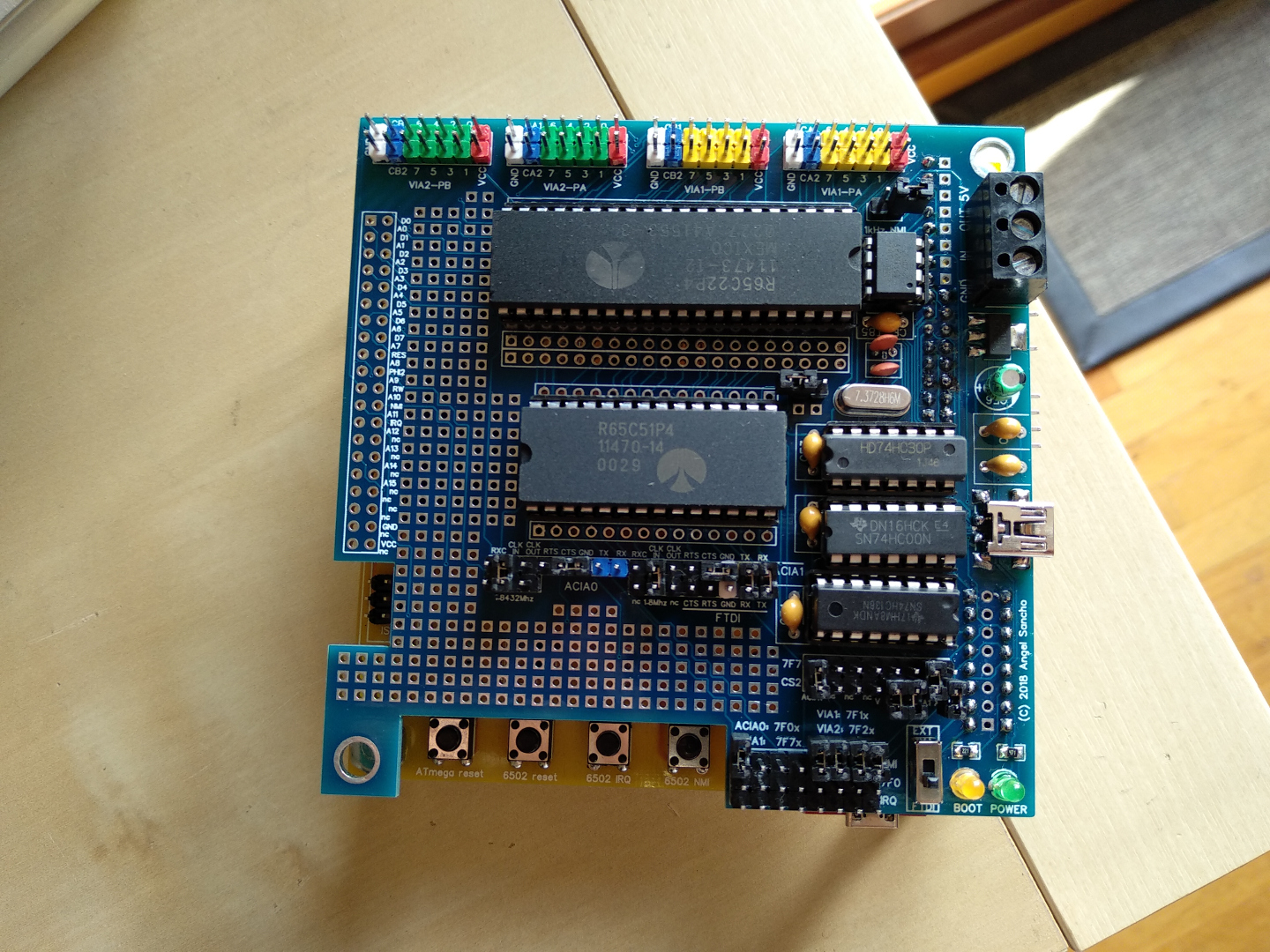

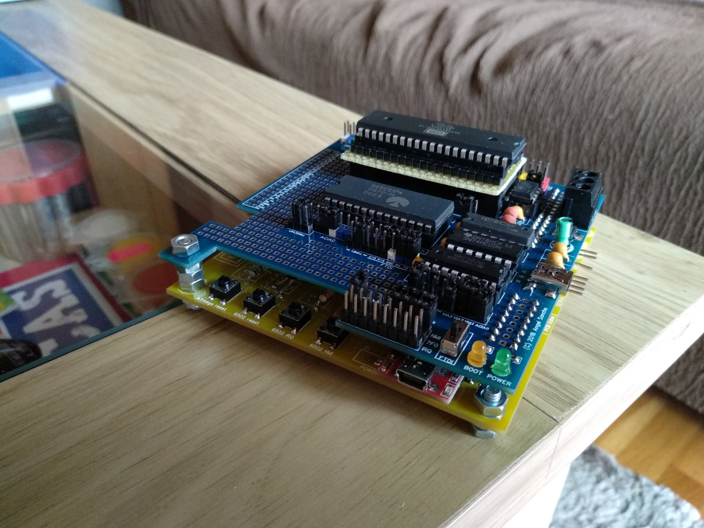

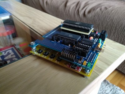

Hi,

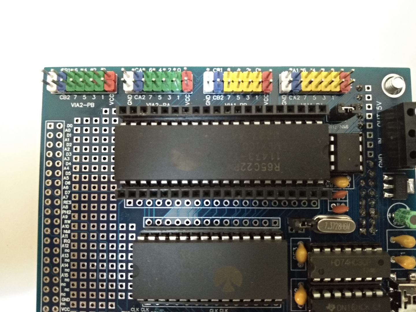

Finally the new PCB has arrived! It connects to the existing board using some pin headers
The new expansion board have these:
- Up to three 65C22, stacked, the last one don't have the i/o ports populated on the PCB, so I have to put it on their own perfboard
- Up to two 65C51, stacked too, one for main com through the FTDI, but it have all the i/o pins populated so can use it for whatever I need
- It have pin headers to use jumpers for all the IC interrupts (to use both with IRQ or NMI) and IC select
- Switch to select main power source: from the FTDI or external micro-USB/screw connector (this one have an AMS1117-5.0 to use >5.0V source)
I used an ATtiny85 to generate the clock for the ACIA and I put a jumper on the PCB to select 1.8432Mhz or 3.6864Mhz, so I can use it up to 230400bps using 16x
The ATtiny85 also generates a 100Hz signal on an other output pin so I can use it as a jiffy clock, also with a jumper to the 65C02 NMI to select it or not.
As you can see in the photos I have stacked the 65C22 and 65C51 to save space, also put the capacitors and resistors under them.
The glue logic it's more or less the same that Daryl uses in their SBC-2, only with some mods for my boot scheme using the ATMega, all the system run in RAM and the I/O uses only 256 bytes of address space.
At one edge of the board I put pads for the address and data bus, interrupts, phi2, r/w and all the signals needed if I want to expand it a bit more, and all the other pads you see are for use it as a perfboard to put custom common use circuits as i2c or spi.
It is working perfectly at 4Mhz using 4Mhz Rockwell parts and one WDC W65C22S
Good summer!
PostPosted: Tue Jul 03, 2018 3:35 pm
Posts: 660
Location: North-Germany
Interesting stack technique. When I thinking about stacking two 6522 I always think OH NO! because of the heat - but that was back then when these parts are NMOS only.
And your colored headers - really neat. :)

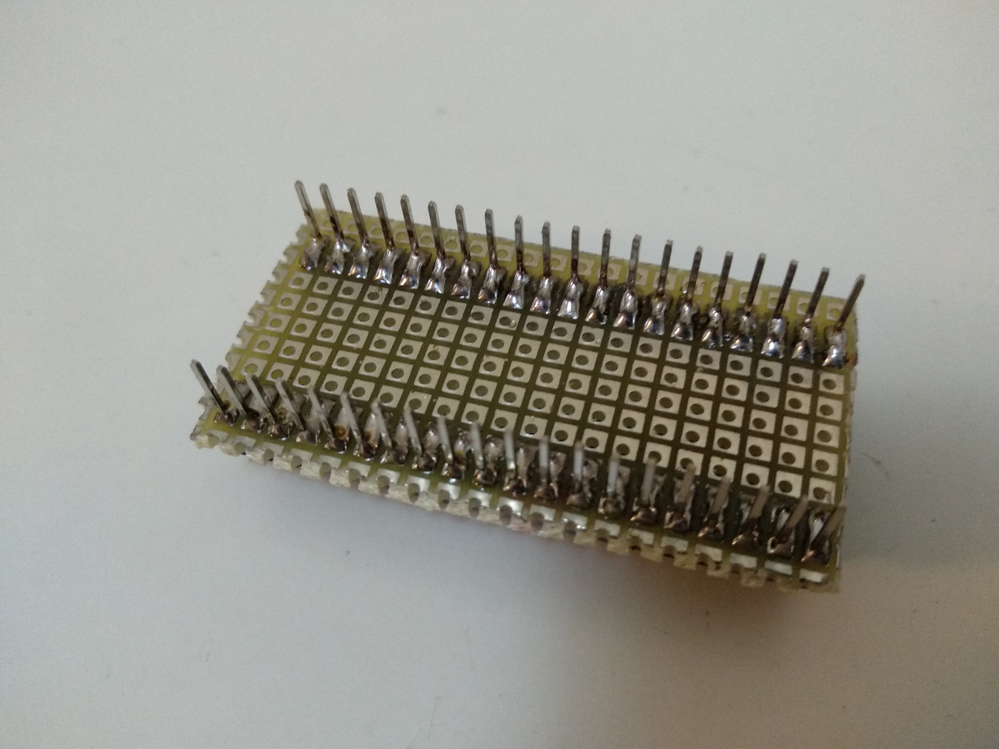

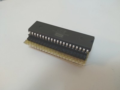

I don't quite understand the stacking. How are you segregating the signals to the chips? Typically, when things are stacked, you see little jumper wires and what not to distinguish the few pins, but I don't see anything like that here.
PostPosted: Tue Jul 03, 2018 6:13 pm
The upper 6522 is mounted on a tiny daughterboard, on which the socket appears to be slightly offset from the header it's standing on.
PostPosted: Tue Jul 03, 2018 8:40 pm
Posts: 1004
Oh, I see.
On the first picture we see the space for the chip, and then the extra pin rows next to them.
The daughter card plugs in to those extra holes, and mounts the chip.
PostPosted: Tue Jul 03, 2018 10:13 pm
Joined: Fri Mar 23, 2018 10:18 pm
Posts: 11
Location: Spain
Hi,
Sorry, I forgot to take some pictures
Yes, I simply soldered female headers on the pcb 0.1 inch wider and made a simple perfboard with the socket for the 6522 and pin headers to connect to it.
I pushed the male pins all the way so I can solder both the socket and pins on the same side of the perfboard and gain height to save the other IC.
Here are some pictures
