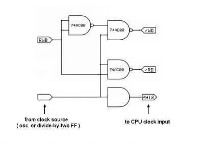

This means it is very necessary to have precisely timed /OE and /WE signals. The CPUs data hold time after write add a little "headroom" so a single gate (a fast one of course) delay would be compensated but not much more.
Knowing this I would recommend to use your clock generator
combined with Dr Jefylls suggestion
(One could use the Phi1 output and the fourth AC00 gate to generate the Phi2.)

OK ... so you want /QW to be !(phi2 & !RWB) and /QR t be !(Phi2 & RWB) as per the accepted logic. That should be easy to test and I can do it now.
Be right back....
Update:
Ahhh, the sweet feeling of egg on my face. Well, that works just dandy at 14MHz with or without the delay to the CPU (even with a 120ns ROM!!).
Thanks everyone. This has been a good experience.

edit: oops, your update makes this post semi-obsolete. I was going to ask for a drum roll to help build suspense! :)
If you'd still had trouble then the next step would've been this (or the equivalent):
But it won't be necessary unless the GAL is pretty darn slow. I agree with BDD's remark somewhere upthread. Generally speaking, getting a RAM to work shouldn't require extraordinary measures.
What is the opinion on the delay to the CPU? The timings look a lot better that way.
I presume you mean a delay like what's in the diagram above (right?). And I don't have an answer. Looks can be deceiving. What's more credible is an actual test. (Example: max achievable speed. Or, spikiness on the supply rails.) But if there's no demonstrable downside then yeah, go for the nice looking waveforms! :D

Great result! Is there any way, or any place, where we could capture what the hazard is and the knowledge as to how to make everything work? (Indeed, now we have an answer, does it turn out that there's anything missing or misleading in the common references?)
PostPosted: Tue Jun 19, 2018 7:09 pm
BillO wrote:
It just makes sense that a 0ns effective delay would be better. No?
Well, I've had enough humbling experiences to become cautious about unsupported conclusions. For example, the effective delay might not be what it seems. Scoping the inputs will show you when the chips are being told to do stuff, but it doesn't reveal how promptly they respond. All that said, here's my take. (Using the CPU clock as our reference, let's speak as though it's the /RD and /WR signals which are being advanced or retarded.)
Advancing /RD and /WR means there's less time for the memories to do their job, so that places a limit on the "early" side. Delaying /RD and /WR means they may still be active after the cycle ends and CPU has begun presenting a new address, and obviously that limits how late things can be (you don't want any spurious accesses).
Another question to ask is, which set of symptoms might might be hardest to detect and thus cause the most grief? (Assuming, I mean, that you prefer "seat-of-the-pants"ing it and/or overclocking, as opposed to a rigorous study of all the propagation times.)
