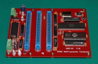

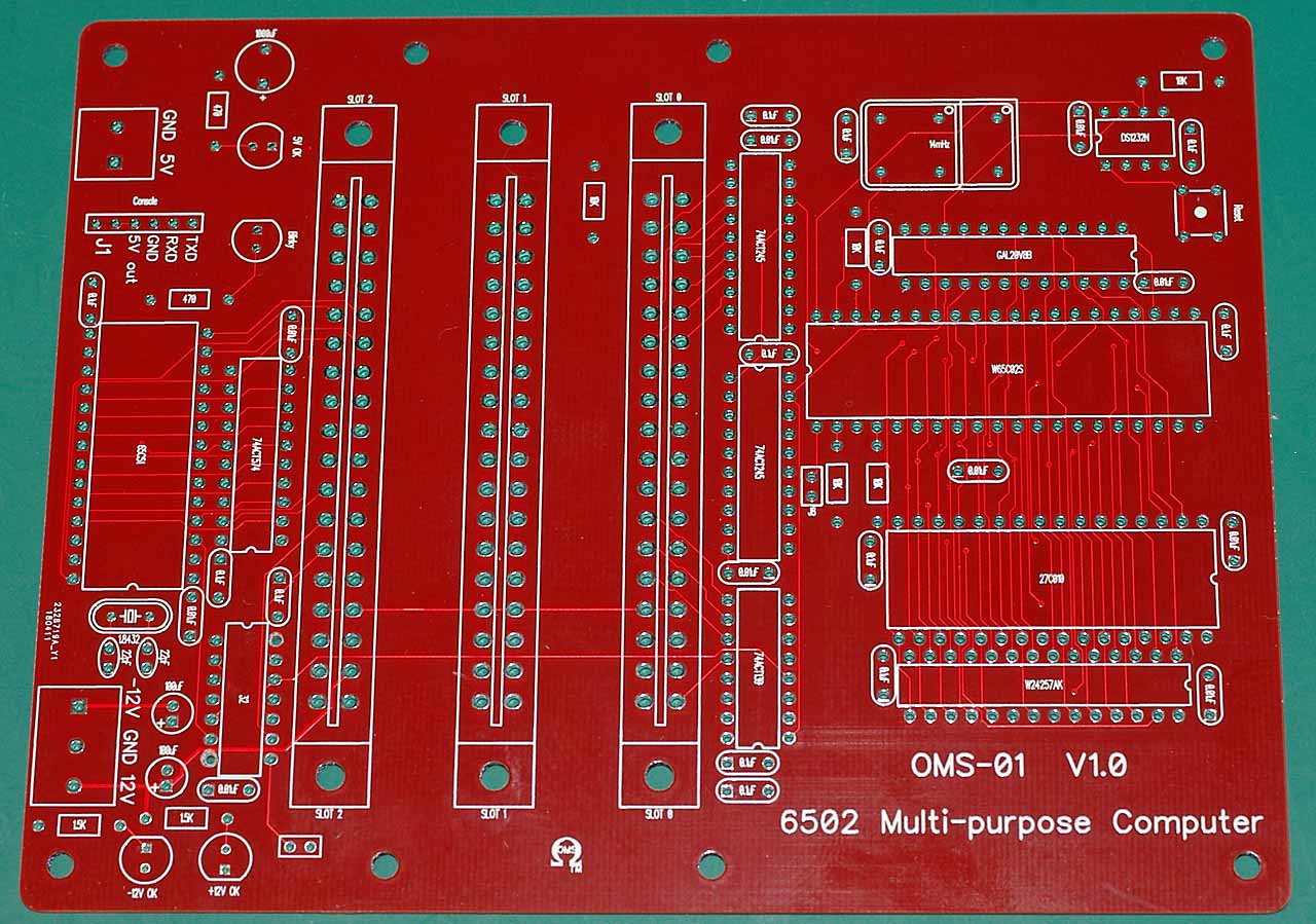

Wow! OSHPArk are even more expensive than ExpressPCB - and it takes 12 days.
My last order to JLCPCB was a 4-layer board of 30.5 sq. in. with my choice of solder mask (I choose red). They sent me 6 of these for $59 and there was an additional $13 for shipping. They shipped them in 3 days and it took another 6 days for them to get to me.
That same order from OSHPark would have cost me $610 and possibly have taken much longer for delivery as I live in Canada.

Re: Express PCB Plus and BGA's
I can't fault them. They are as good as anything I have ever had made.
Here are two shots of the aforementioned board: And here it is built up:
