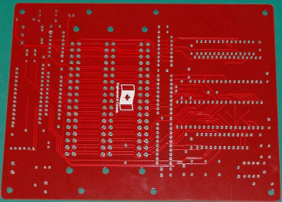

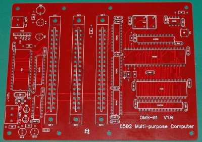

My last order to JLCPCB was a 4-layer board of 30.5 sq. in. with my choice of solder mask (I choose red). They sent me 6 of these for $59 and there was an additional $13 for shipping. They shipped them in 3 days and it took another 6 days for them to get to me.
That same order from OSHPark would have cost me $610 and possibly have taken much longer for delivery as I live in Canada.

Interesting, I never even bothered to pay attention to OSHPark's costs since my boards were never very big (never more than $15 to $20 for 3 boards). A 30 sq. in. board would certainly make me think twice though. I'll have to look into JLCPCB. I wonder how their quality compares to OSHPark?
PostPosted: Thu May 17, 2018 9:27 pm
Posts: 1005
I can't fault them. They are as good as anything I have ever had made.
Here are two shots of the aforementioned board:

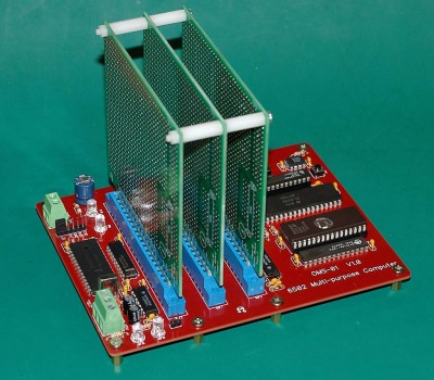

And here it is built up:
