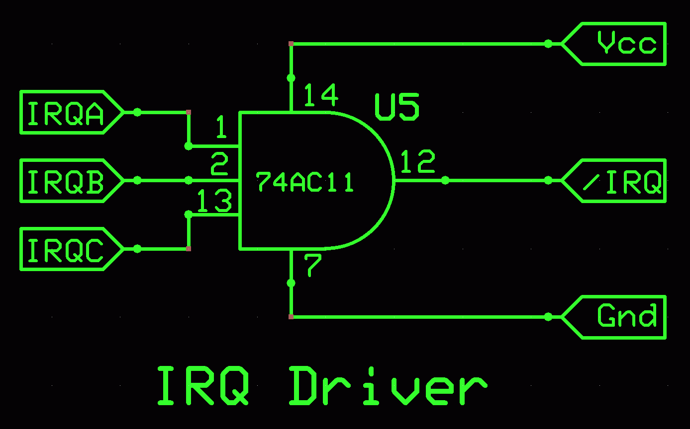

If the machine's crash rate is unchanged at slightly high and slightly low VDD, it's more likely to be a digital problem, otherwise more likely to be a timing problem.
Both POC V2.0 and V2.1 behave in a similar fashion, although V2.1 seems to be a little more prone to having its apple cart upset. I have both of them powered off the same power supply, which also has POC V1.1 connected. V1.1 is rock solid. Ergo the power supply is not a likely culprit, which conclusion is bolstered by the five volt output being 5.02 volts.
Although V2.0 and V2.1 are somewhat different designs they share a lot of common elements. Both are equipped with the same amount of RAM, same amount of ROM, both have four serial I/O channels and both use a Microchip (Atmel) ATF1504AS CPLD for glue logic. The RAM and ROM is wired into the system in the same way with both units, and many other design elements are adaptations of what has already been proven in V1.1.
The principle differences between V2.0 and V2.1 are:
  1. V2.0 uses a quadruple UART (QUART) for serial I/O. V2.1 uses two dual UARTs (DUART). The pair of DUARTs theoretically contributes slightly more to bus loading.

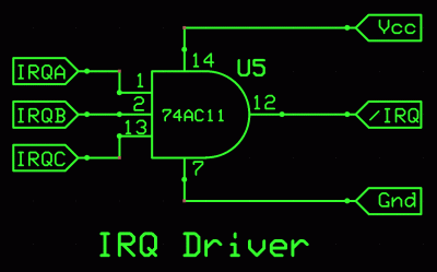

  2. V2.0 uses a basic wired-OR IRQ circuit that is identical to that used in V1.1. V2.1 uses a triple input AND gate to drive the MPU's IRQB input high or low, with each gate input wired to a separate interrupt source.
    File comment: POC V2.1 Enhanced IRQ Circuit
    Not shown in the above are the pullup resistors attached to each of U5's inputs.

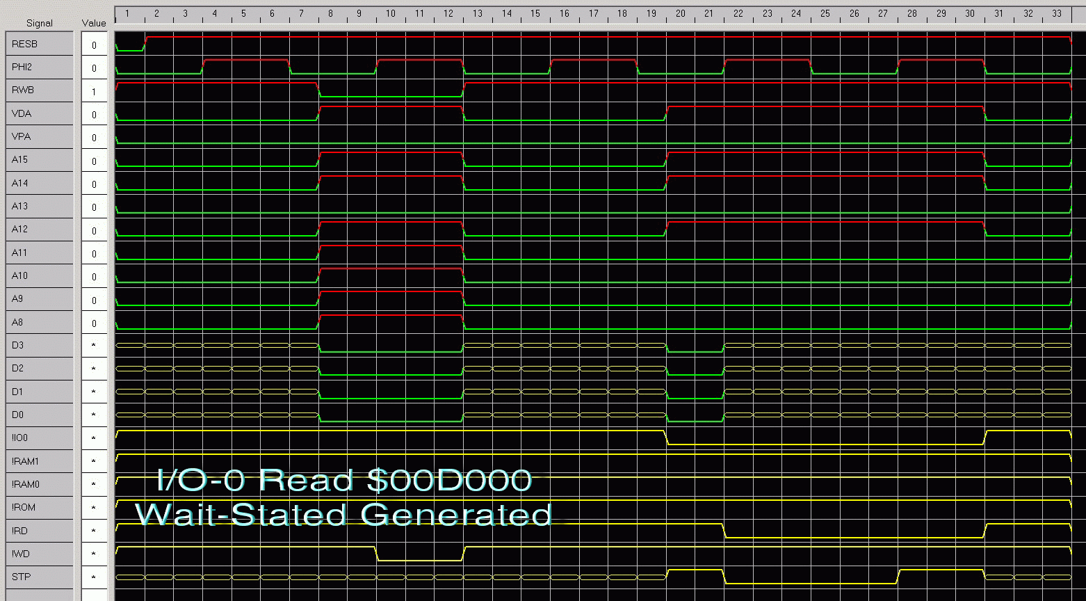

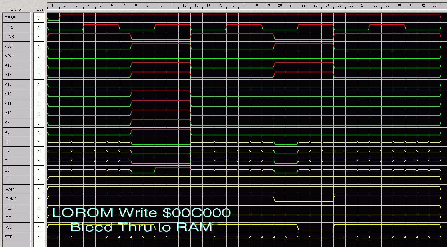

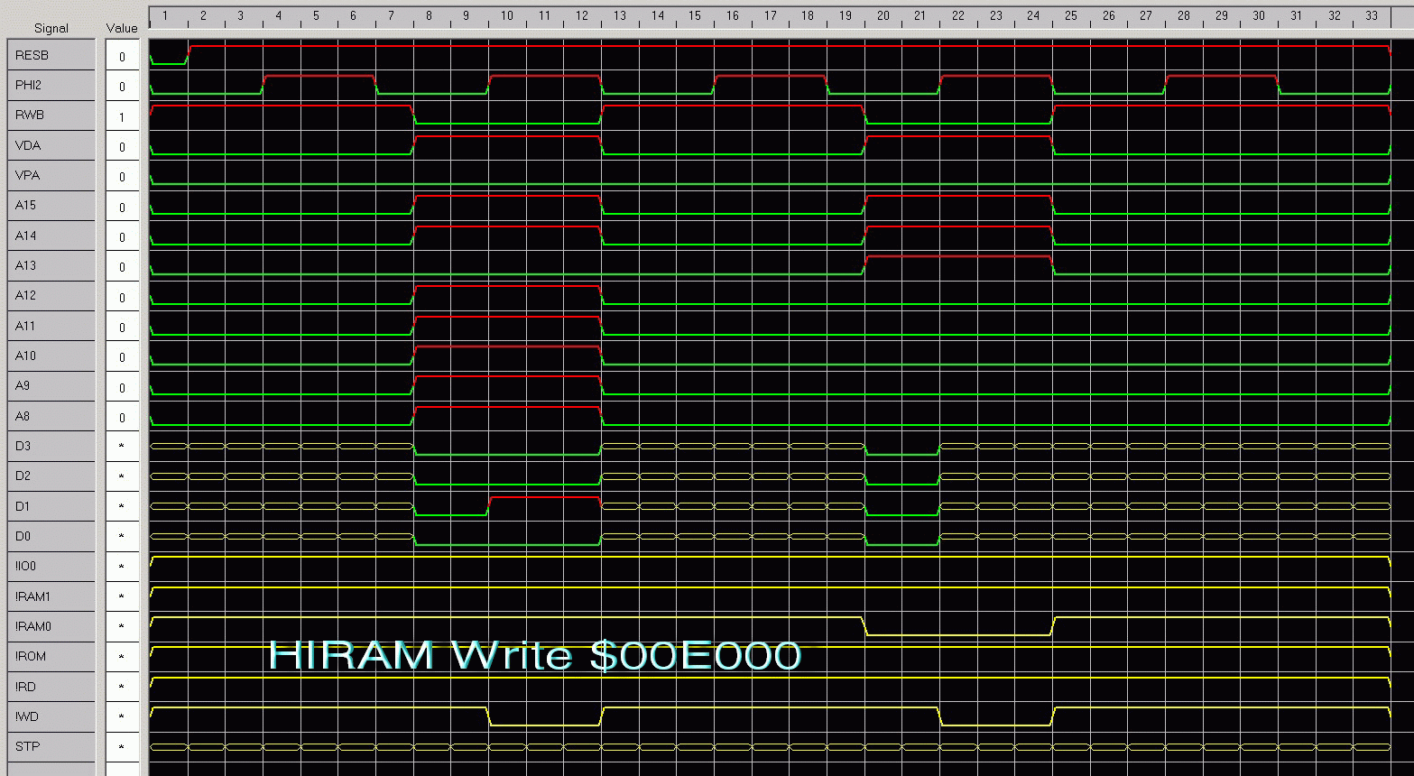

Comments about timing have caused me to revisit the CPLD code to see if I may have inadvertently set up a race condition that is causing instability. I did see some aspects to the way in which chip selects are determined that could be improved, and ended up doing a significant amount of editing to the logic for V2.0. V2.0 is a better guinea pig for testing at this point because the I/O chip selects are simpler than those of V2.1.
Anyhow, after a number of studying, editing, studying, editing... cycles, I ran simulations on all important logic features, the graphs of which will follow.

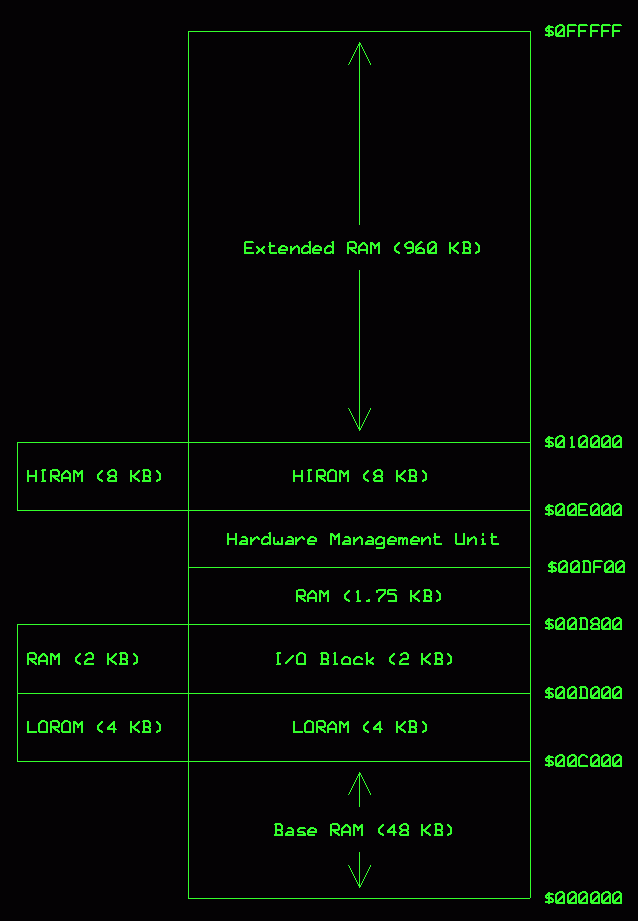

By way of explanation, POC V2 has the following architecture:
File comment: POC V2 Memory Map

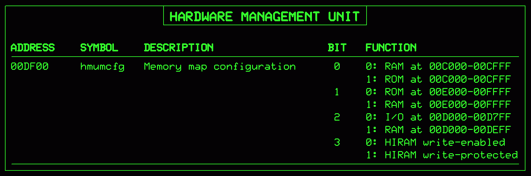

At power-on or reset, the memory map exposes ROM at $00E000-$00FFFF—referred to as HIROM, and I/O at $00D000-$00D7FF—this is the default memory map. The "hardware management unit" (HMU), which is a virtual device inside the CPLD that is addressable at $00DFxx (the lower eight bits of the address aren't decoded), can modify the memory map as follows:
File comment: Hardware Management Unit
In the above, HIRAM ("high RAM") refers to RAM at $00E000-$00FFFF.
At power-on or reset, all bits in the HMU are cleared, which causes the default memory map to be selected and write-protection of HIRAM to be turned off. Another feature is a write to ROM will "bleed through" to RAM at the same address. This feature makes it possible to shadow the relatively slow (55ns) ROM into much faster SRAM (10ns).

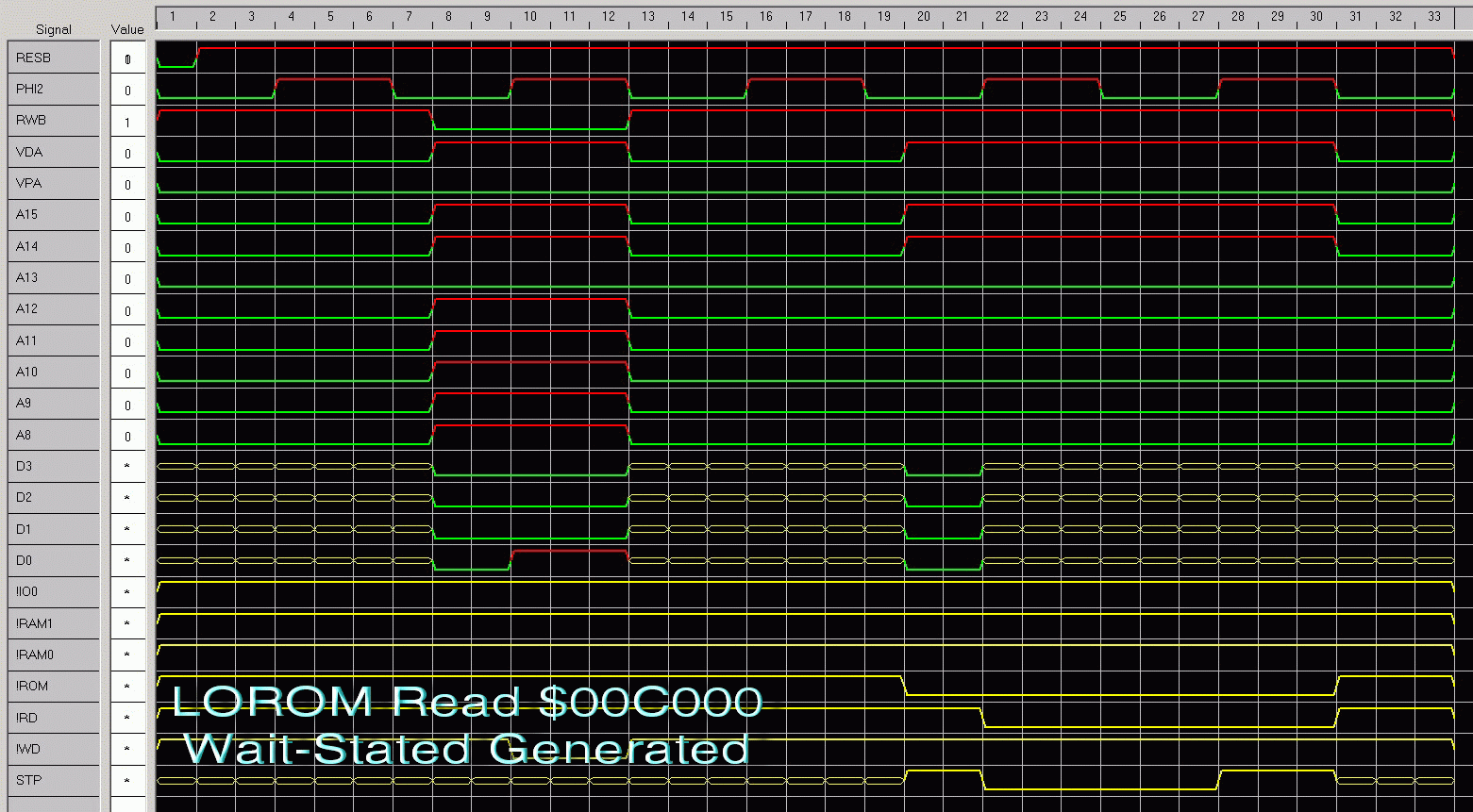

Next, I will present images of the simulations I did on the logic. These will run to several posts, due to the limit on the number of images that can be attached to one post.
File comment: Read from "base RAM" at $000000
In the above, a read operation has been performed from "base RAM," which is RAM from $000000-$00BFFF. The read operation starts at vector 19 on the fall of Ø2 (second from the topmost row). At vector 20, the MPU places an address on the bus, VDA goes high and the CPLD reads D0-D3 for the bank bits, which are %0000. So the decoded address is $000000. RAM0, which is the SRAM mapped in from $000000-$07FFFF (512KB), is selected. All of this happens while Ø2 is still low, as the CPLD has a 10ns rating.
At vector 22, Ø2 goes high and the CPLD asserts the /RD (read data) line. RAM0 responds by driving the data bus, which can't be illustrated in this simulation, since it only represents what the CPLD is doing. At vector 24, Ø2 goes low once more and the read operation ends.

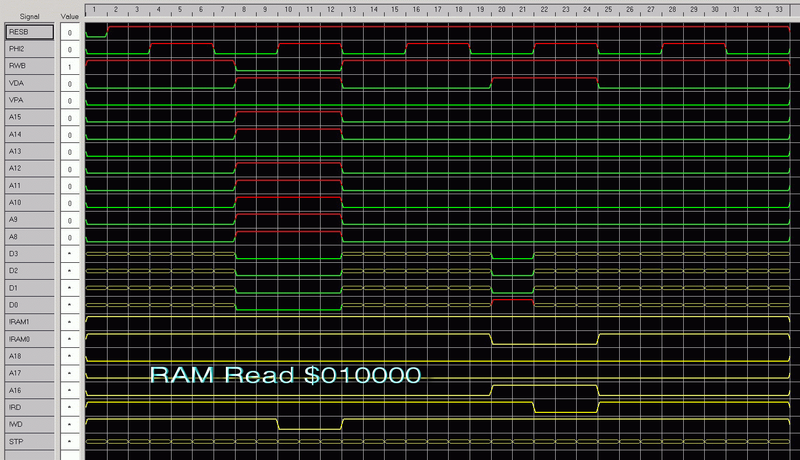

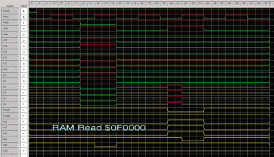

File comment: Read from "extended RAM" at $010000
In the above, a read operation has been performed from "extended RAM" at $010000. The sequence is identical to the previous, except the bank bits at vector 20 are %0001, which the CPLD decodes as $010000. RAM0 is selected, since the decoded address is in the range $000000-$07FFFF.

File comment: Read from "extended RAM" at $080000
In the above, a read operation has been performed from "extended RAM" at $080000. The sequence is identical to the previous one, except the bank bits at vector 20 are %1000, which the CPLD decodes as $080000. RAM1 is selected, since the decoded address is in the range $080000-$0FFFFF.

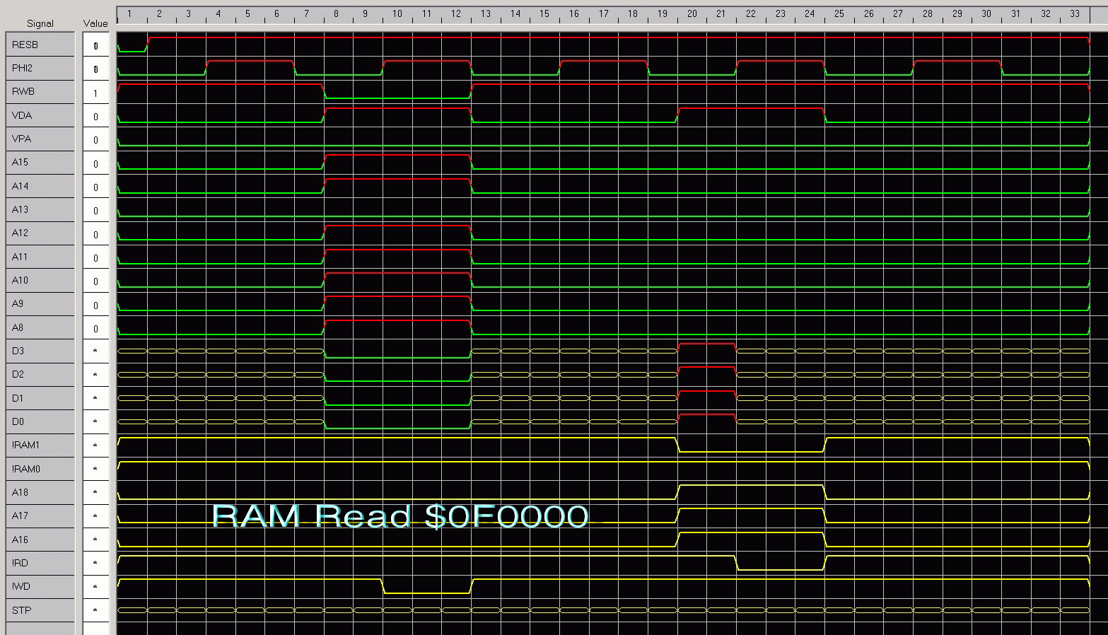

File comment: Read from "extended RAM" at $0F0000
In the above, a read operation has been performed from "extended RAM" at $0F0000. The sequence is identical to the previous one, except the bank bits at vector 20 are %1111, which the CPLD decodes as $0F0000. RAM1 is selected, since the decoded address is in the range $080000-$0FFFFF.

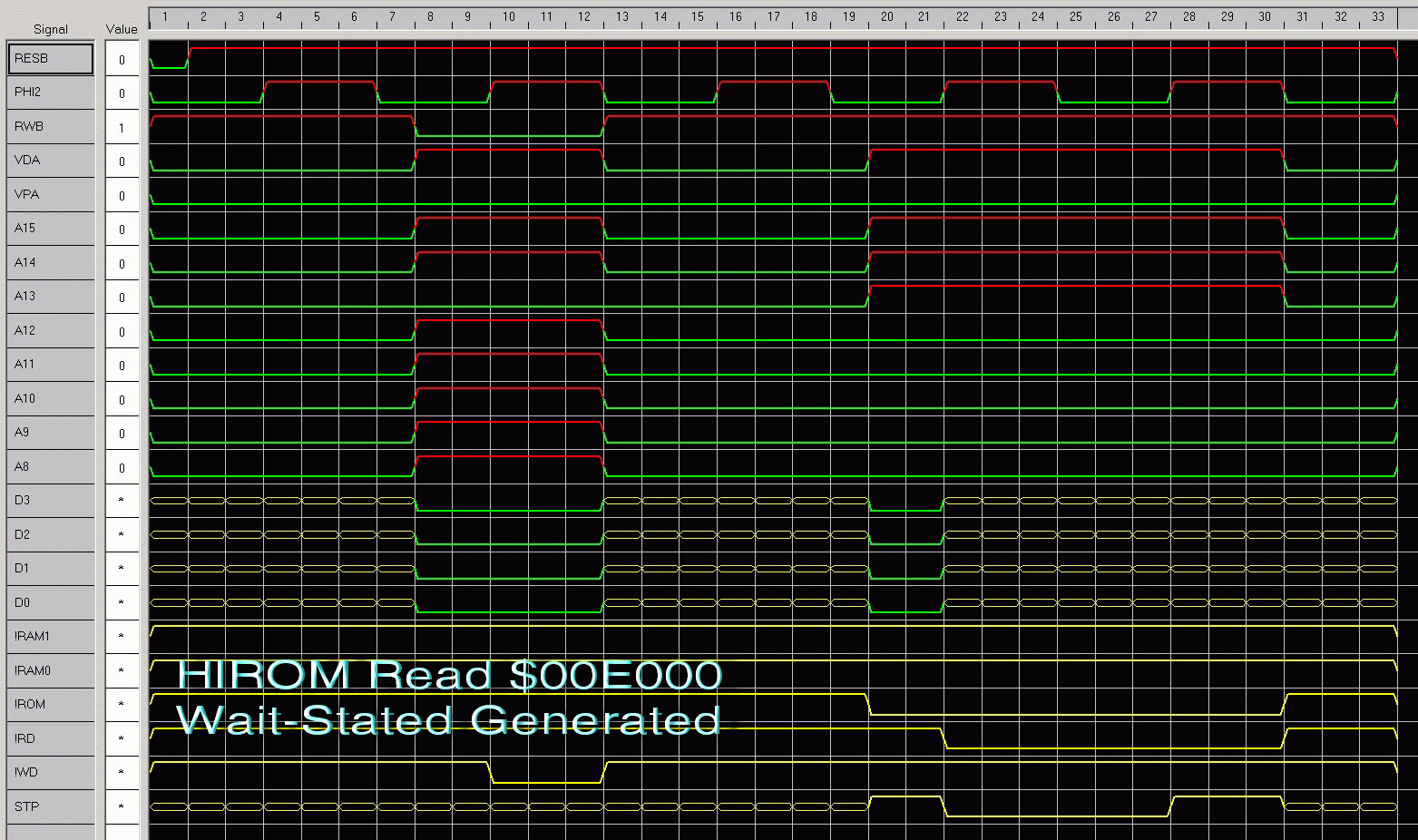

File comment: Read from "high ROM" at $00E000
In the above, a read operation has been performed from "high ROM" (HIROM) at $00E000. When the CPLD decodes the address at vector 20 and determines it is ROM, it will activate the wait-state logic. At vector 20, the ROM is selected and the CPLD's STP ("stop") output is brought out of high-Z and is driven high. STP is wired to the MPU's RDY pin. While STP is in the high-Z state an external 3.3K pullup resistor keeps RDY high.
At vector 22 when Ø2 goes high, /RD will go low, as will STP and, of course, RDY. According to the 65C816's data sheet, RDY will be sampled at the fall of Ø2, which would be at vector 25. The CPLD maintains the state of all outputs under its control until the next rise of Ø2, which is at vector 28. At that time, STP goes high, which drives RDY high, ending the wait-state. The read operation is finished at vector 31 on the fall of Ø2. Also, STP returns to the high-Z state, leaving the pullup resistor to keep RDY high.

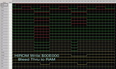

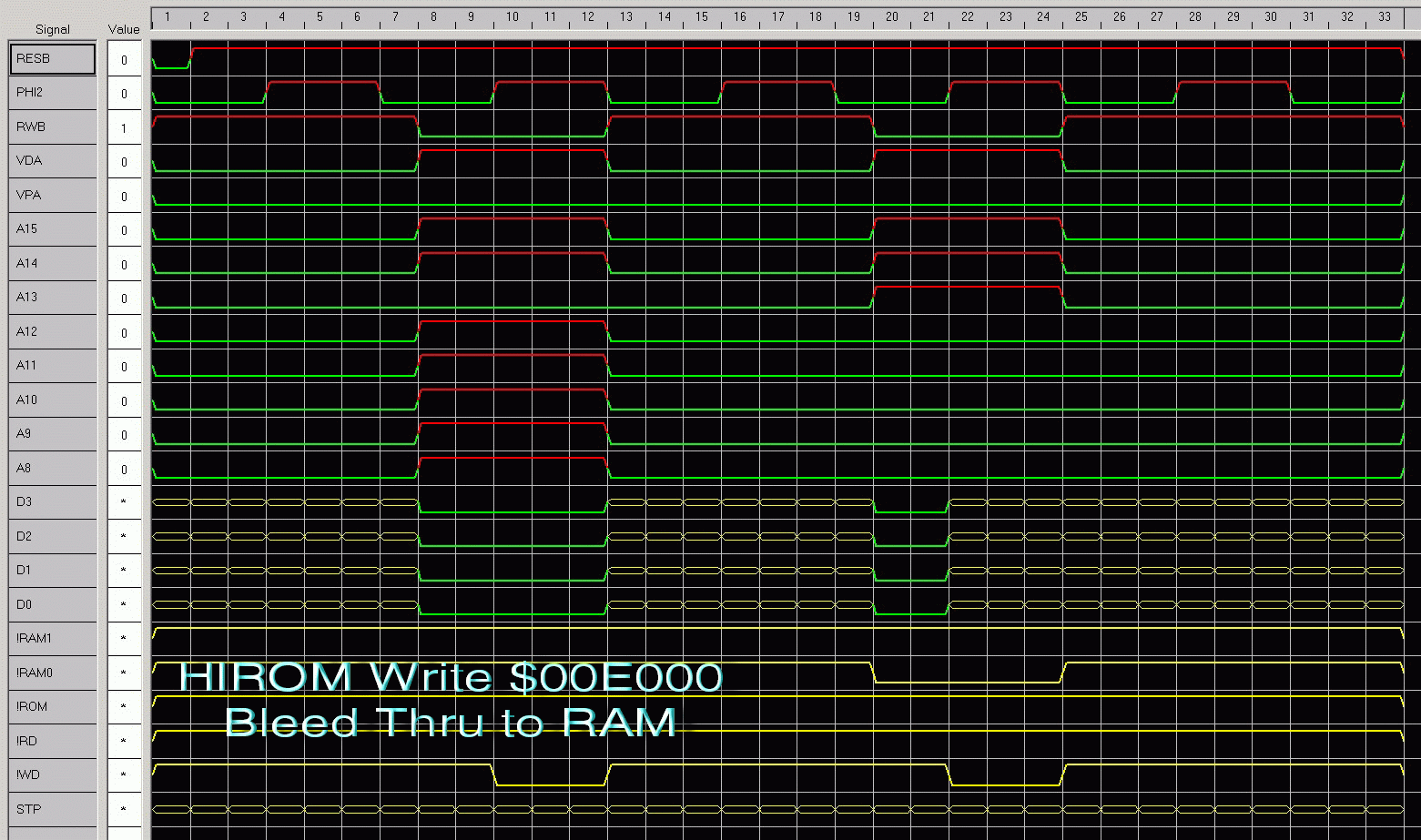

File comment: Write to "high ROM" at $00E000
In the above, a write operation has been performed on HIROM at $00E000. However, the CPLD logic instead selects RAM0, which causes it to be written at the same address. RAM requires no wait-state, so the write operation is over in one cycle, even though the write is to ROM.
File comment: Write to "high RAM" at $00E000.
In the above, a write operation has been performed on "high RAM" (HIRAM) at $00E000. Where this differs from the previous operation is prior to the write to RAM, the HIROM/HIRAM bit in the HMU is set. The HMU setup begins at vector 7 with $00DF00 being placed on the address bus at vector 8. At vector 10, a write to the HMU sets bit 1, which replaces HIROM with HIRAM. Although the HMU is technically in the I/O address block ($00D000-$00DFFF), no wait-stating is required.
Once the HMU has been configured, the write sequence to RAM occurs starting at vector 19, with RAM0 being selected.

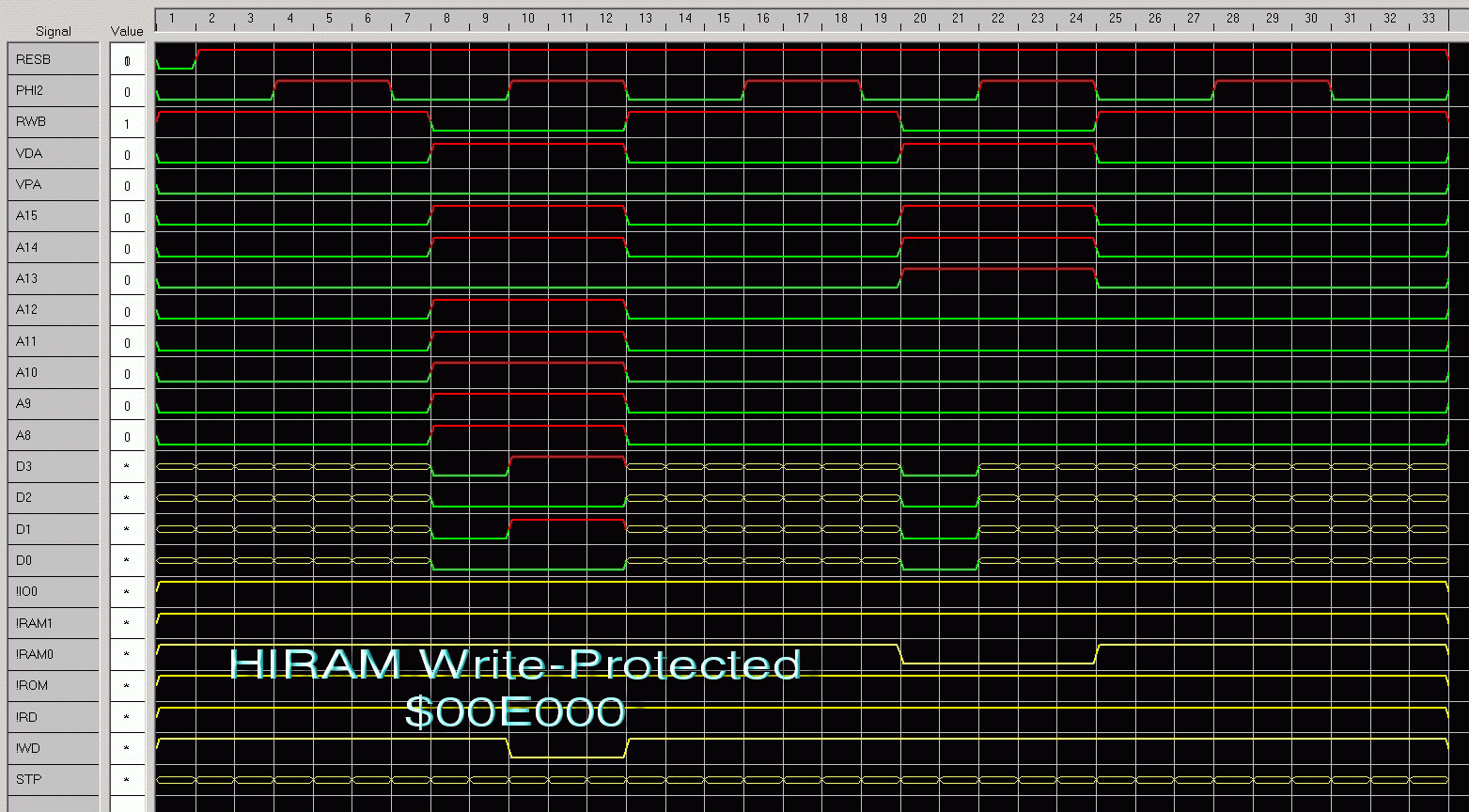

File comment: "High RAM" write-protection at $00E000
In the above, a write operation has been attempted on HIRAM at $00E000. However, write-protection was enabled by setting bit 3 in the HMU—also note bit 1 remains set to map out HIROM. Hence the CPLD logic will not assert /WD (write data) signal, which is wired to the SRAM's write-enable (/WE) input, and the write will fail.
File comment: Read from I/O device at $00D000
In the above, a read operation is performed on the I/O hardware at $00D000. All I/O hardware accesses are wait-stated, as can be seen in the simulation. I/O device 'A' (IO0, seventh row from the bottom) has been selected. In POC V2.0, that would be the QUART. In POC V2.1, one of the two DUARTs would be selected.

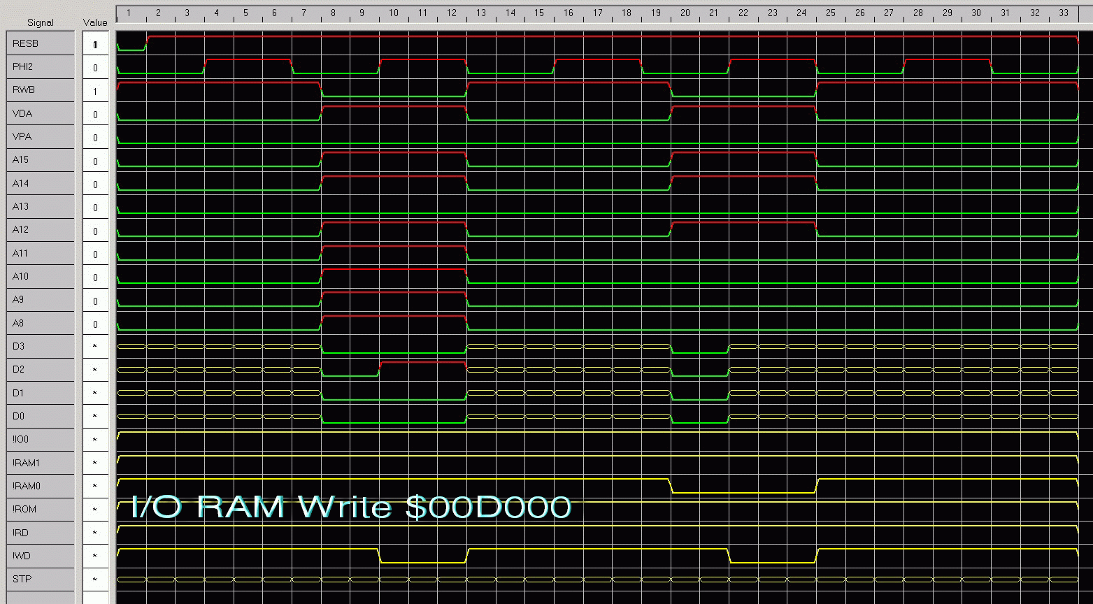

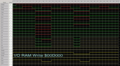

File comment: Read from RAM at $00D000
In the above, I/O hardware has been mapped out and replaced with RAM (IORAM) at the same address range. Bit 2 has been set in the HMU (vectors 7 thru 12, inclusive) and therefore RAM is written. Even though the address is in the I/O block, no wait-stating occurs.
File comment: Read from "low ROM" at $00C000
In the above, "low ROM" (LOROM) has been mapped in at $00C000 and a read operation is performed. Prior to the read, bit 0 in the HMU is set to map in the ROM. Operation is the same as reading from HIROM.

File comment: Write to "low ROM" at $00C000
In the above, "low ROM" (LOROM) has been mapped in at $00C000 and a write operation is performed. Prior to the read, bit 0 in the HMU is set to map in the ROM. However, as with HIROM, a write to LOROM bleeds through to LORAM at the same address. Unlike HIRAM, there is no provision for write-protecting LORAM—that may become a feature in a future design that has a larger CPLD.

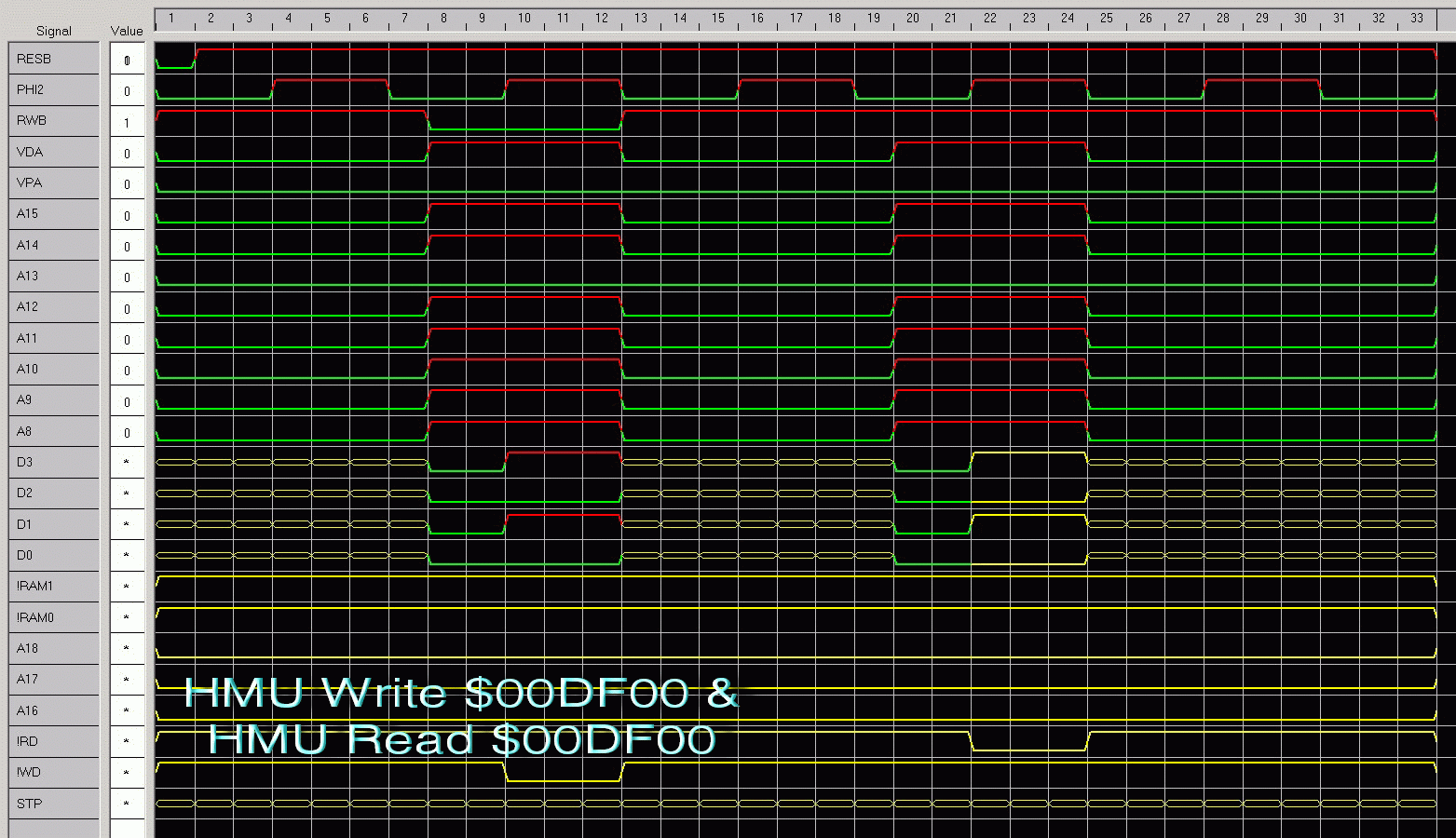

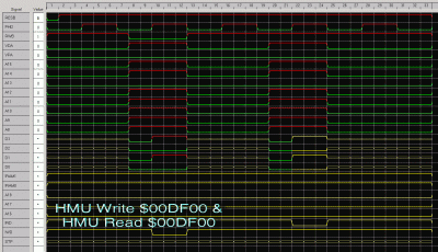

File comment: Write & read of HMU at $00DF00
In the above, the last of the simulation graphics, the HMU is written and then read back. The write occurs starting at vector 7 as before, whilst the read occurs starting at vector 19.
As the HMU is a four-bit register wired to D0-D3 on the data bus, D4-D7 are not driven when a read is performed on the HMU. In POC V2.0, that means D4-D7 float during a read. As all PCB traces have some amount of parasitic capacitance, odds are D4-D7 will retain what was last on them. Hence bits 4-7 will contain random values following a read. In POC V2.1, I added a 3.3K resistor array to bias the data lines up to Vcc, which means a read of the HMU will return with bits 4-7 always set. I don't know that it matters either way, but I figured I'd fool around with it and see if anything happens. As both machines exhibit similar issues, I suspect the biasing of the data bus is a "don't care" situation.
In creating the CPLD logic, I did my best to avoid any "gotchas" that are peculiar to the 65C816. All addresses are qualified by VDA and VPA, and reads and writes are qualified with Ø2. This is the same approach used in the design of POC V1.1, which has been 100 percent stable over long periods of operation. So I think I'm on the right track. I attached the CPLD code for POC V2.0 to the end of this post in case anyone wants to have a look and get a laugh. :D
Finally, the CPLD I am using in both units is rated 10ns pin-to-pin. I do make extensive use of buried nodes, both as logic aggregators and as registers. The wait-state "circuit" uses a D-flop, and the bank bits and HMU are implemented with latches. As use of buried nodes supposedly doesn't add to the 10ns prop delay claimed for the device (at least as I understand it), I believe I have more than adequate timing headroom in the CPLD. However, I also have a 7.5ns version that I will press into service if I continue to have issues after programming the new logic into the existing CPLD.

property   atmel {output_fast=off};
property   atmel {pin_keep=off};
property   atmel {preassign=keep};
property   atmel {security=off};
property   atmel {xor_synthesis=on};
PIN ASSIGNMENTS
pin     1 = RESB;                                 /* system reset          */
pin     2 = VPA;                                  /* valid program address */
pin     4 = !WD;                                  /* write data            */
pin     5 = !RD;                                  /* read data             */
pin     6 = D1;                                   /* data line             */
pin     8 = D2;                                   /* data line             */
pin     9 = D0;                                   /* data line             */
pin    11 = !IO1;                                 /* I/O device 'B' select */
pin    12 = !IO0;                                 /* I/O device 'A' select */
pin    14 = STP;                                  /* wait-state control    */
pin    16 = !IO2;                                 /* I/O device 'C' select */
pin    17 = !IO3;                                 /* I/O device 'D' select */
pin    18 = !IO4;                                 /* I/O device 'E' select */
pin    19 = A18;                                  /* address line          */
pin    20 = A16;                                  /* address line          */
pin    21 = A17;                                  /* address line          */
pin    24 = RWB;                                  /* read/write            */
pin    25 = A15;                                  /* address line          */
pin    26 = A14;                                  /* address line          */
pin    27 = !RAM1;                                /* RAM chip select       */
pin    28 = !RAM0;                                /* RAM chip select       */
pin    29 = !ROM;                                 /* ROM chip select       */
pin    31 = !RST;                                 /* inverted reset        */
pin    33 = D3;                                   /* data line             */
pin    34 = A12;                                  /* address line          */
pin    36 = A8;                                   /* address line          */
pin    37 = A9;                                   /* address line          */
pin    39 = A10;                                  /* address line          */
pin    40 = A11;                                  /* address line          */
pin    41 = A13;                                  /* address line          */
pin    43 = PHI2;                                 /* system clock          */
pin    44 = VDA;                                  /* valid data address    */
MACHINE ARCHITECTURE & HARDWARE MANAGEMENT UNIT DEFINTIONS
           +--------------------------+ $0FFFFF
           |  Extended RAM  (960 KB)  |
   +-------+--------------------------+ $010000
   | HIRAM |       HIROM (8 KB)       |
   +-------+--------------------------+ $00E000
           | Hardware Management Unit |
           +--------------------------+ $00DF00
           |      D8RAM (1.75 KB)     |
   +-------+--------------------------+ $00D800
   | IORAM |       IODEV (2 KB)       |
   +-------+--------------------------+ $00D000
   | LOROM |       LORAM (4 KB)       |
   +-------+--------------------------+ $00C000
           |      BASRAM (48 KB)      |
           +--------------------------+ $000000
                1 KB = 1024 bytes
  HMU
Register   Address   Register Description   Type  Bit  Function
hmumcfg    $00DF00   System configuration:   R/W   0   0: RAM at $00C000-$00CFFF (default)
                                                       1: ROM at $00C000-$00CFFF
                                                   1   0: ROM at $00E000-$00FFFF (default)
                                                       1: RAM at $00E000-$00FFFF
                                                   2   0: I/O at $00D000-$00D7FF (default)
                                                       1: RAM at $00D000-$00D7FF
                                                   3   0: HIRAM write-enabled    (default)
                                                       1: HIRAM write-protected
Notes:  1) Writing to ROM "bleeds through" to RAM at same address.  This behavior will be
           inhibited when writing to HIROM if HIRAM has been write-protected.
        2) The HMU itself is read/write & cannot be mapped out.
$DEFINE   cblkmap   hmumcfg0                      /* LORAM/LOROM control */
$DEFINE   dblkmap   hmumcfg2                      /* IODEV/IORAM control */
$DEFINE   eblkmap   hmumcfg1                      /* HIROM/HIRAM control */
$DEFINE   eblkctl   hmumcfg3                      /* HIRAM write control */
BURIED LOGIC DECLARATIONS
pinnode   = [blatch0..3];                         /* bank address registers               */
pinnode   = [hmumcfg0..3];                        /* hardware management unit registers   */
pinnode   = bank0;                                /* 1 = address is $000000-$00FFFF       */
pinnode   = basram;                               /* 1 = address is $000000-$00BFFF       */
pinnode   = bavalid;                              /* 1 = bank address valid               */
pinnode   = cblk;                                 /* 1 = address is $00C000-$00CFFF       */
pinnode   = dblk;                                 /* 1 = address is $00D000-$00DFFF       */
pinnode   = eblk;                                 /* 1 = address is $00E000-$00FFFF       */
pinnode   = extram;                               /* 1 = address is $010000-$07FFFF       */
pinnode   = hmusel;                               /* 1 = HMU being accessed               */
pinnode   = hiramwp;                              /* 1 = HIRAM write-protected            */
pinnode   = ioblk;                                /* 1 = I/O address space being accessed */
pinnode   = iosel;                                /* 1 = I/O device selected              */
pinnode   = mcfgsel;                              /* 1 = HMU configuration being accessed */
pinnode   = ramsel;                               /* 1 = RAM selected                     */
pinnode   = rhflag;                               /* 1 = data fetch on high clock         */
pinnode   = romsel;                               /* 1 = ROM selected                     */
pinnode   = wsext;                                /* 1 = hold bus & control states        */
pinnode   = vab;                                  /* 1 = address bus valid                */
pinnode   = wsff;                                 /* wait-state flip-flop                 */
pinnode   = wsflag;                               /* 1 = wait-state in progress           */
RESETS
$REPEAT i = [0..3]
    hmumcfg{i}.AR = !RESB;
$REPEND
wsff.AR   = !RESB;
INTERMEDIATE CONTROL LOGIC
vab       = VDA # VPA;                            /* true if valid address       */
rhflag    = RWB & PHI2;                           /* true if fetch on high clock */
bavalid   = vab & !PHI2;                          /* true if bank address valid  */
A16-A19 LATCHING LOGIC
[blatch0..3].LE = bavalid & !wsext;               /* open latches, unless in wait-state */
[blatch0..3].L  = [D0..3] & bavalid & !wsext;     /* capture bank, unless in wait-state */
bank0     = [blatch0..3]:'b'0000;                 /* true if bank = $00                 */
extram    = !bank0;                               /* true if bank != $00                */
MEMORY MAP BASIC LOGIC
basram    = bank0 & (!A15 # !A14);                /* $000000-$00BFFF */
cblk      = bank0 & A15 & A14 & !A13 & !A12;      /* $00C000-$00CFFF */
dblk      = bank0 & A15 & A14 & !A13 & A12;       /* $00D000-$00DFFF */
eblk      = bank0 & A15 & A14 & A13;              /* $00E000-$00FFFF */
ioblk     = dblk & !A11;                          /* $00D000-$00D7FF */
d8ram     = dblk & A11 & !(A10 & A9 & A8);        /* $00D800-$00DEFF */
hmu       = dblk & A11 & A10 & A9 & A8;           /* $00DF00-$00DFFF */
RAM SELECTION LOGIC
ramsel    = basram #                              /* select if BASRAM, or... */
            (cblk & (!RWB # !cblkmap)) #          /* LORAM if mapped, or...  */
            ioblk & dblkmap #                     /* IORAM if mapped, or...  */
            d8ram #                               /* D8RAM, or...            */
            eblk & (!RWB # eblkmap) #             /* HIRAM if mapped, or...  */
            extram;                               /* extended RAM            */
/* HIRAM write-protection rule... */
hiramwp   = eblk & eblkctl;                       /* true if HIRAM is write protected */
ROM SELECTION LOGIC
romsel    = RWB & ((cblk & cblkmap) #             /* C-ROM if mapped, or... */
            (eblk & !eblkmap));                   /* E-ROM if mapped        */
I/O DEVICES SELECTION LOGIC
iosel     = ioblk & !dblkmap;                     /* $00D0xx-$00DExx if mapped */
WAIT-STATE LOGIC
wsflag    = iosel # romsel;                       /* wait-state if I/O or ROM & enabled */
wsff.CK   = PHI2;
wsff.D    = !wsff & wsflag;
wsext     = PHI2 # wsff;                          /* 1 = wait-state in progress         */
OUTPUT STATEMENTS
[A16..18] = [blatch0..2] & vab;                   /* A16-A18 address bits               */
IO0       = iosel & vab & !A10 & !A9 & !A8;       /* I/O device 'A' select              */
IO1       = iosel & vab & !A10 & !A9 &  A8;       /* I/O device 'B' select              */
IO2       = iosel & vab & !A10 &  A9 & !A8;       /* I/O device 'C' select              */
IO3       = iosel & vab & !A10 &  A9 &  A8;       /* I/O device 'D' select              */
IO4       = iosel & vab &  A10 & !A9 & !A8;       /* I/O device 'E' select              */
RAM0      = ramsel & !blatch3 & vab;              /* RAM0 chip enable                   */
RAM1      = ramsel &  blatch3 & vab;              /* RAM1 chip enable                   */
RD        = wsext & RWB & vab;                    /* read                               */
STP       = !wsff;                                /* MPU wait-state                     */
STP.oe    = wsflag;                               /* active if wait-stating             */
ROM       = romsel & vab;                         /* ROM chip enable                    */
RST       = RESB;                                 /* inverted reset                     */
WD        = wsext & !RWB & !hiramwp & vab;        /* write, but not to protected HIRAM  */
HMU REGISTER READ/WRITE STATEMENTS
[D0..3].oe       = hmu & rhflag;                  /* enable output on D0-D3   */
[D0..3]          = hmu & [hmumcfg0..3] & rhflag;  /* HMU bit pattern on D0-D3 */
[hmumcfg0..3].LE = hmu & !RWB & PHI2;             /* open HMU latches         */
[hmumcfg0..3].L  = hmu & [D0..3] & !RWB & PHI2;   /* D0-D3 bit pattern on HMU */
/* * * * *   E N D   O F   F I L E   * * * * */

PostPosted: Wed May 23, 2018 8:16 am
Posts: 10938
Good to see all that information BDD, it might well help illuminate what's going on.
But for the record...
...my point was slightly different. It's not that there might be anything wrong with the power, but that adjusting power as a free parameter is a useful investigative tactic. It's a poor man's Schmoo, if you will. You can learn a lot from a Schmoo plot.
PostPosted: Wed May 23, 2018 8:27 am
Posts: 8389
Ironically, despite all the electronic stuff I do I don't have a variable power supply in my shop. Everything that I've designed has been powered with 3.3, 5, 12 or 24 volts, or some combination thereof. The 3.3, 5 and 12 volt power I get from a (slightly modified) PC power supply. I have a separate power supply I built for producing 24 volts.
Before I tinker with anything else, I'm going to reprogram POC V2.0's CPLD with the thoroughly simulated new code and see if that does anything for me. If not, then it's going to mean digging deeply into the hardware, first looking for the obvious (e.g., bad solder joints) and then the arcane.
PostPosted: Wed May 23, 2018 10:24 am
Posts: 452
Hi, a lot of info to try an absorb.
I note the CPLD is very fast < 10ns and on the graphs the timing is synchronous with phi02. Could it be that hold times are just barely being met ? Would it be possible to insert a few more ns delay on the output of the CPLD ? (another clock cycle depending on input clock ?).
http://www.finitron.ca
