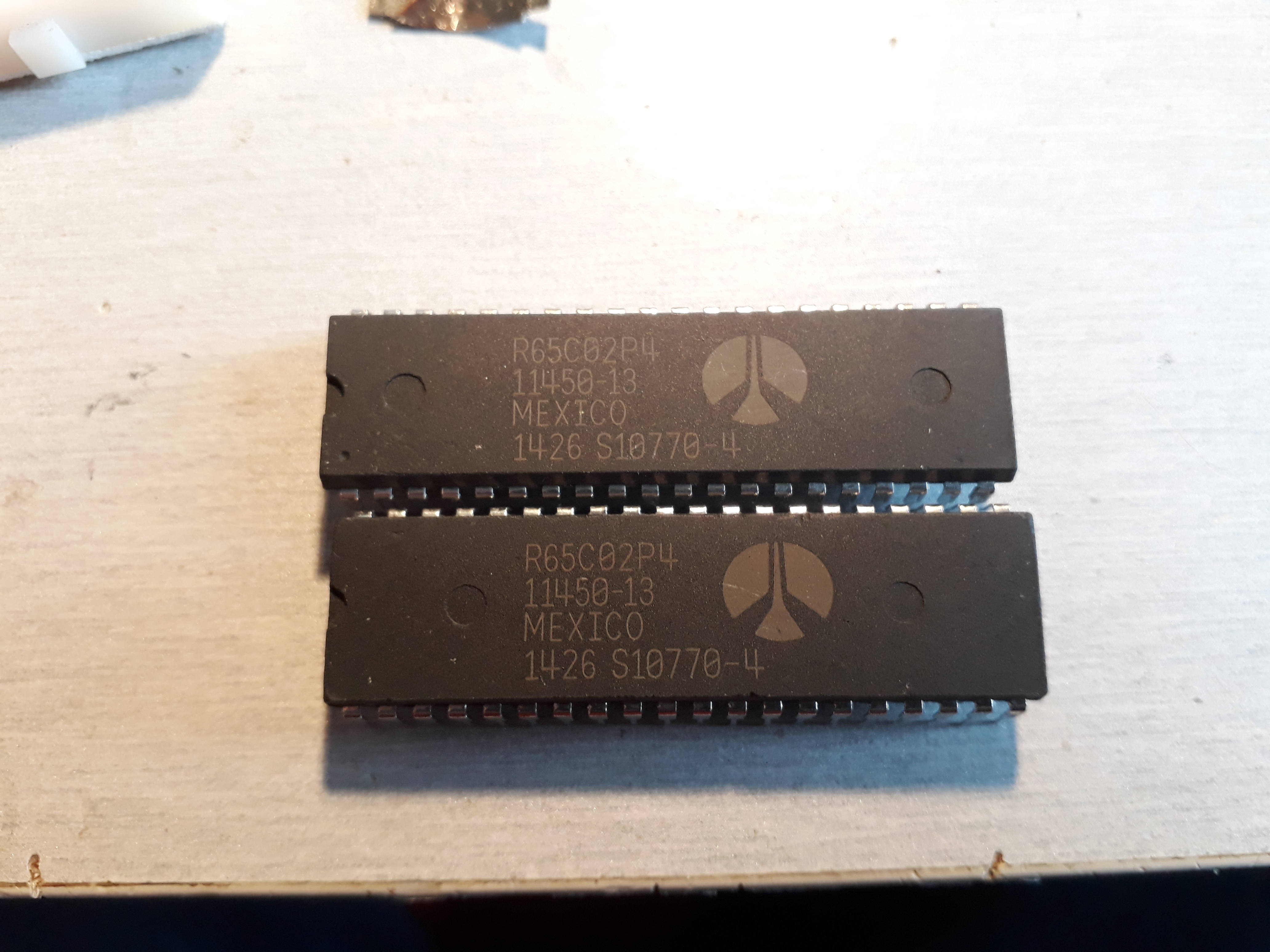

I'm looking forward getting at least two old, NOS R65C02 processors, at any speed. After having tried to get them on eBay and ending with a bunch of counterfeits, I'd rather get them somewhere else even if they're pricier. Could anybody suggest a thrustworthy place to get them?
It's not for a programming project, and I really need Rockwell-packaged R65C02s.
Thank you.

BillO wrote:
Query: How does one determine if the R65C02 you receive is a counterfeit?
The reason I ask is that I bought 4 R65C02P4 units off an eBay vendor in Hon Kong not long ago and they work perfectly.
You may want to build a simple Arduino tester like the one I made for the W65C02s I received from China: viewtopic.php?f=4&t=5141
Try running CMOS instructions like BRA or PHX, then extended Rockwell instructions (RMBx), then WDC instructions (WAI).
Aside from that, do some appearance checks like checking that the color of the IC on the bottom looks like that on the top (which for rebadged, they won't since they remove the upper part to re-etch another part number), that the packaging looks like Rockwell's (such as notch position and size) and that the internal serial code on the bottom matches that of other Rockwells.

Might it be true that chips advertised as Rockwells are unlikely to be counterfeit, simply because they have a lower market value? I'm only speculating. But if I saw chips on EBay advertised as being 14 MHz WDC parts I'd be more suspicious.
I am well aware that Rockwell can be counterfeit as well.
Otherwise these come from a parallel universe in which Rockwell still exist in 2014 :D
Do they work and are they CMOS?

BillO wrote:
I tested these with the tester I had made for the other fake 65C02s I had received, but that's before I found out I had the data pins wired backwards, and the only thing I am sure is that it did not write to stack on boot.
I'll try again this evening now that I've sorted that out.
 Post subject: Re: 65xx parts sources
PostPosted: Fri May 04, 2018 10:23 pm
Joined: Fri Apr 27, 2018 3:12 pm
Posts: 13
Location: Valencia, Spain
BillO wrote:
Apparently, they do work but they are not CMOS:
A:8001 D:00 R
A:0001 D:FE R SYNC
A:0001 D:FE R
A:0002 D:00 R
A:0001 D:FE R
A:0000 D:80 R
A:FFFC D:00 R
A:FFFD D:00 R
A:0000 D:80 R SYNC
A:0001 D:FE R
A:0002 D:00 R SYNC
This is the result of executing:
start:
BRA start
BRK
