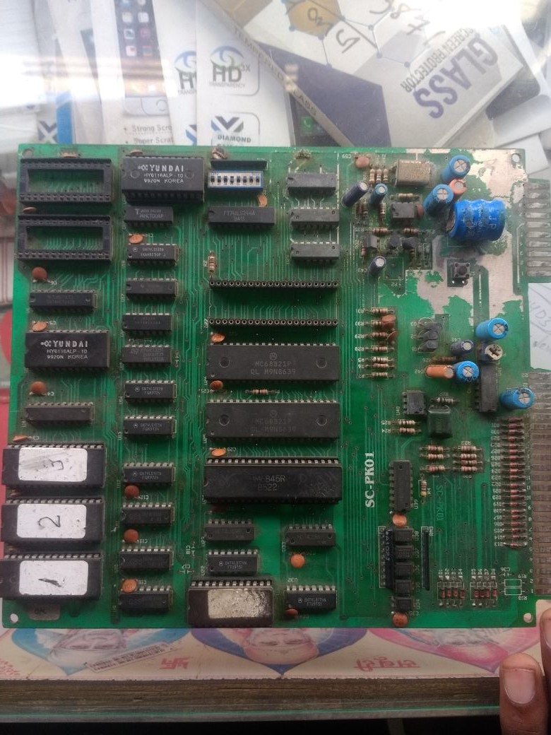

Welcome shivshankarq - do you have photos of your board?

Thanks for sharing! I can confirm that it looks like 6502 code in the 32k ROM image, because the last few bytes look like vectors, and with the ROM placed at 0 the reset vector points to this very normal reset routine:
6D36 A2FF       ldx #FF
6D38 9A         txs
6D39 D8         cld
6D3A 200060   ` jsr 6000
but beyond that, it's difficult. You'd need to find an emulator for the exact hardware, or to modify an existing emulator. Your PCB has the legend SC-PK01 and I can't find anything with that name.
The ROM image has about 20k of useful data (Edit: much less, just over 8k), so I guess the machine has 5 ROMs of 4k each, or something like that (Edit: no, much less according to the dump!). There's a 6845 which is a video output chip. I see a pair of 2k static RAMs: I'd expect one of those to be for video and the other for workspace.
Do you know the name of the product that contained the board, or the manufacturer?

Yes, It is "2 PAIR" game, Its coin operated video poker game
I don't know who is manufacturer,
You have any idea, How i can run this type games in PC ? you know any proper emulator which is fit for this type game?
or Any schematic of this type board means i am made from my local manufacture/supplier ?

There are a few similar machines which are covered by MAME - that's a free program you can run on the PC, which emulates thousands of arcades and coin-ops. You just need to get the ROMs from somewhere, figure out how to use MAME, and choose the right model of machine. I can't help with that, but there will be plenty of MAME support forums.
http://mamedev.org/release.html
(If you don't care too much precisely what game you run then MAME is certainly the answer.)
The more chip numbers you can see, the better - is there sound in this game? Can you find the number or name of the sound chip?
Can you clean the crystal (the metal can, top right) and read off the frequency? Could be 16MHz, could be something else.
Two machines which might be similar, but might not be identical:
Fun World / TAB / Impera
Series 7000 hardware.
65C02 + 2x PIAs + M6845 CRTC + AY8910
and
American Poker II (see here)
Do be careful visiting web sites about poker machines and ROMs for them - there will be scams and there could be malicious popups and similar.

Note that if what you have is a dump from an existing, standard arcade board ROM (I can't tell from the picture if that's what it is), then odds are that the game in question is already part of MAME. The interesting case would be if you believe you have some unique variant.
