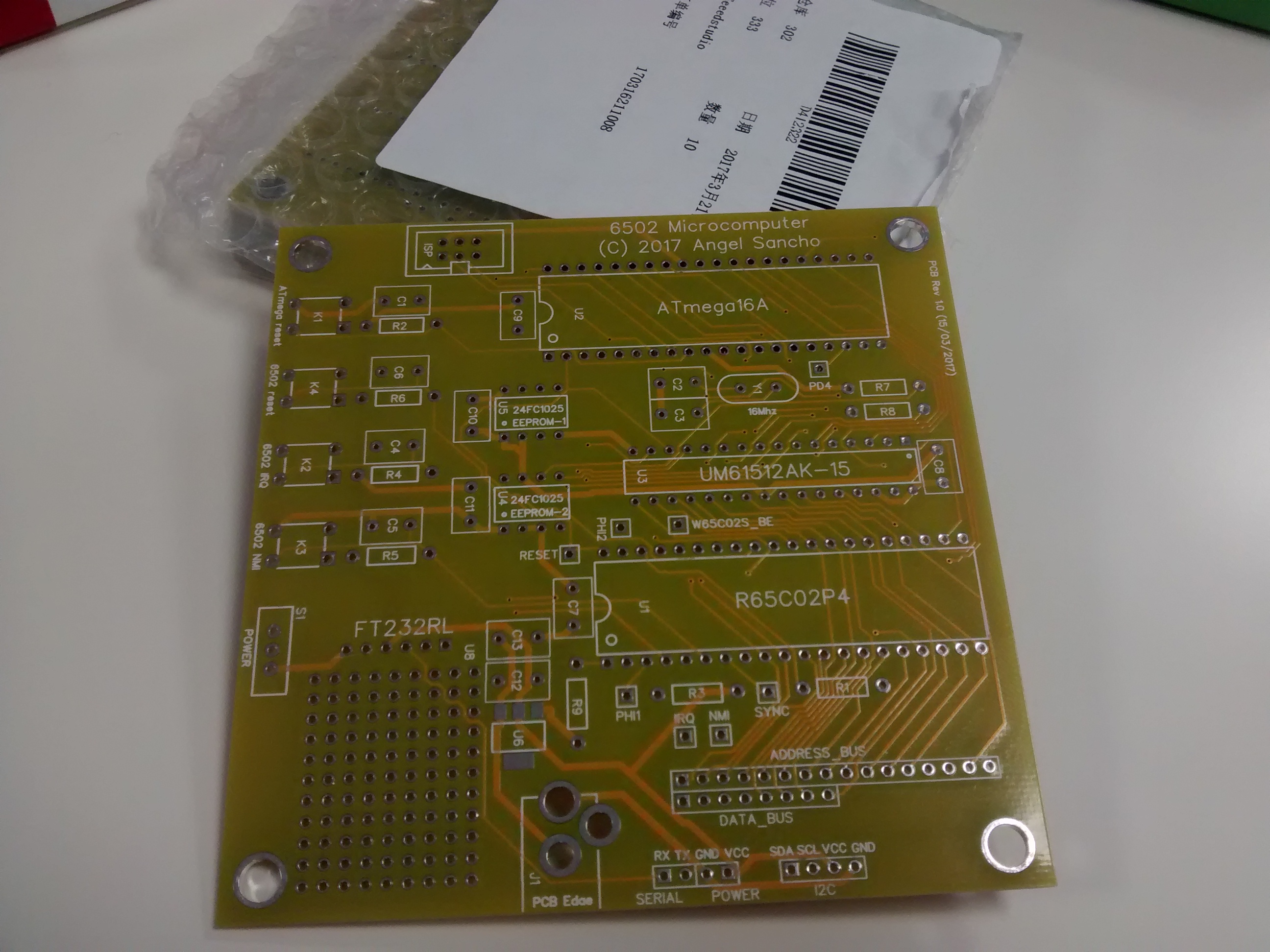

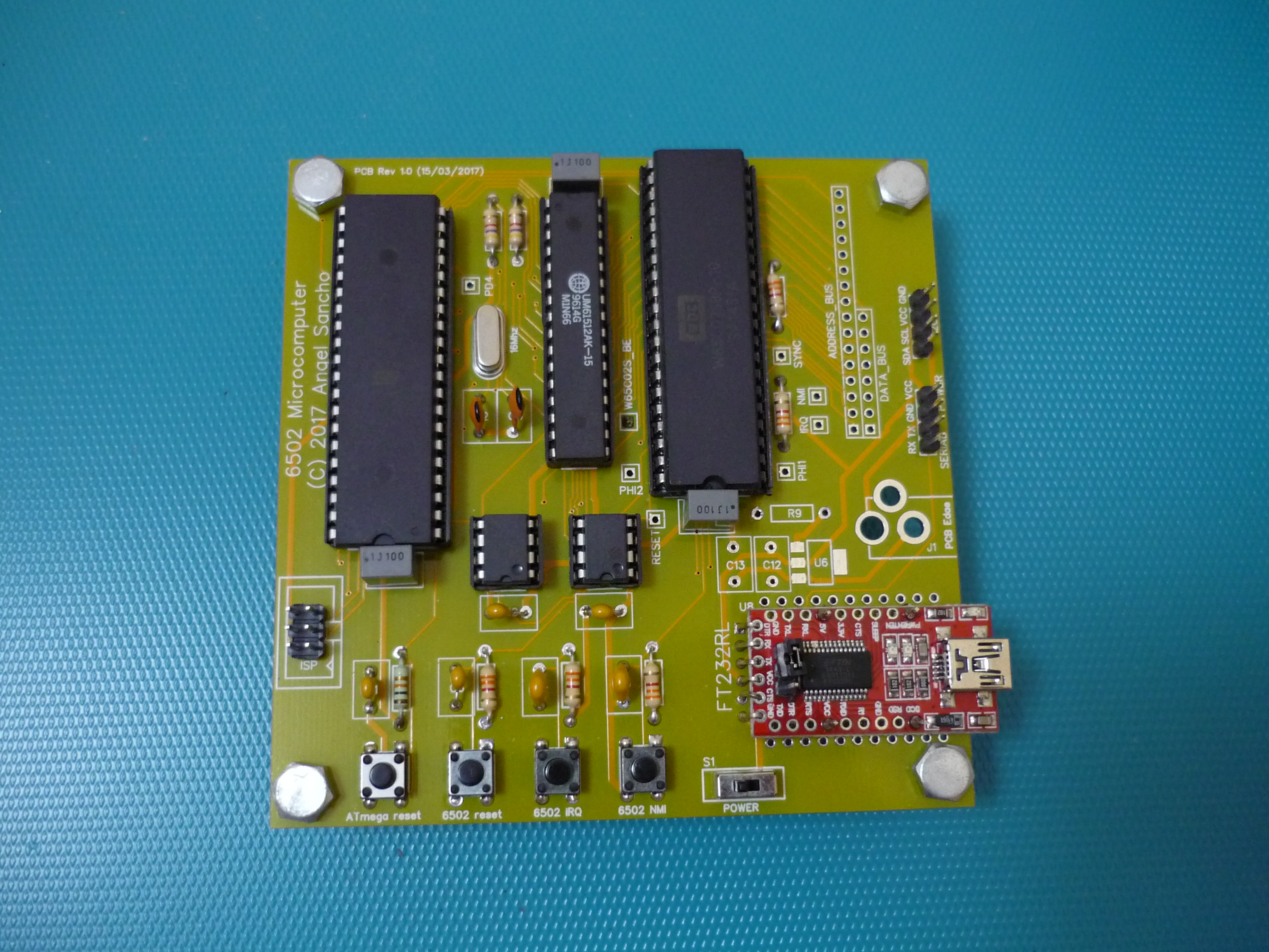

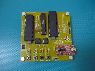

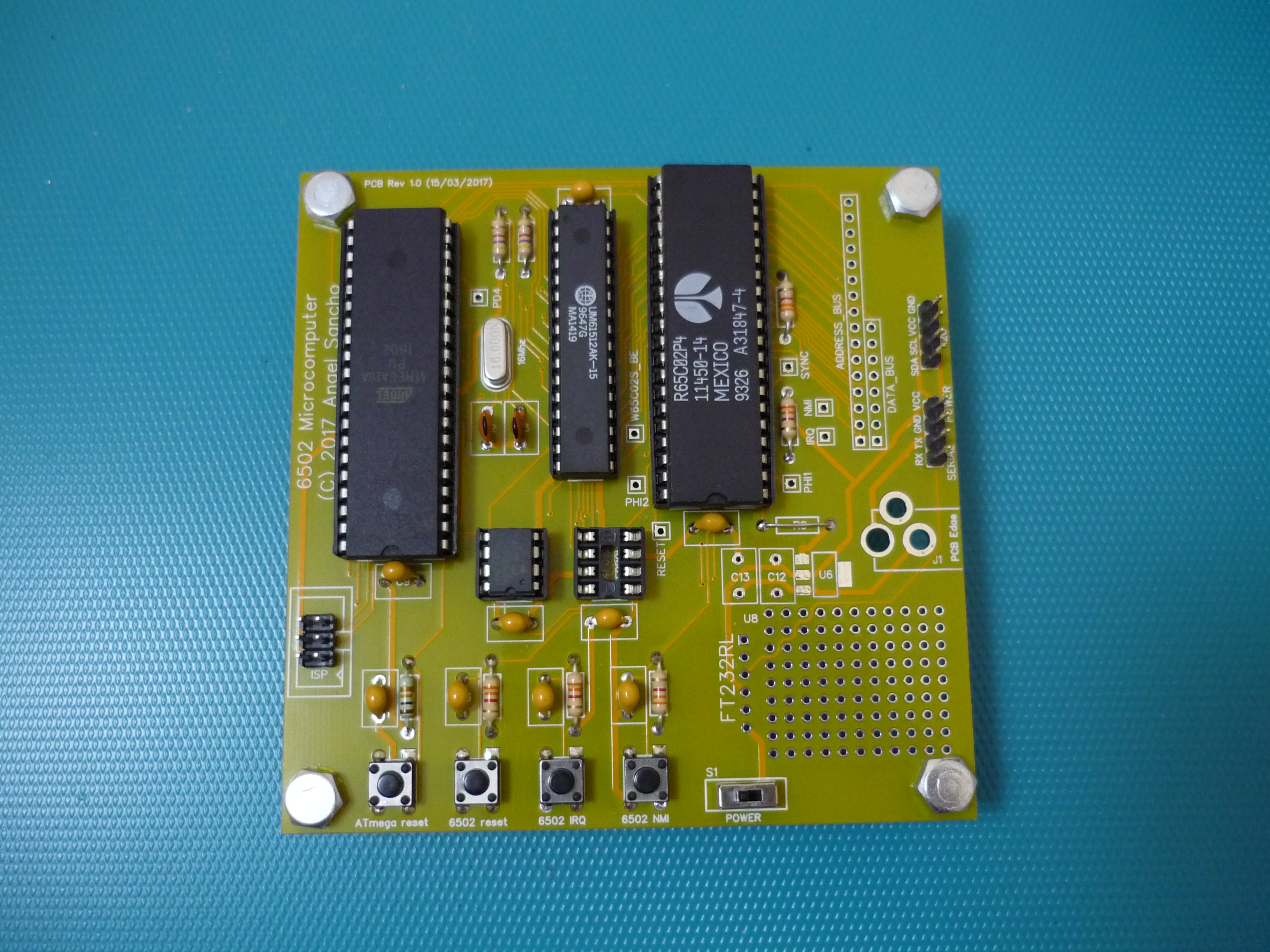

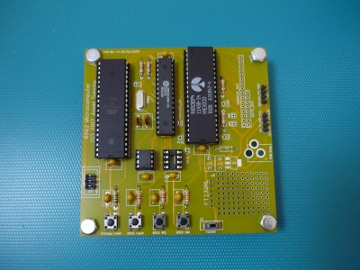

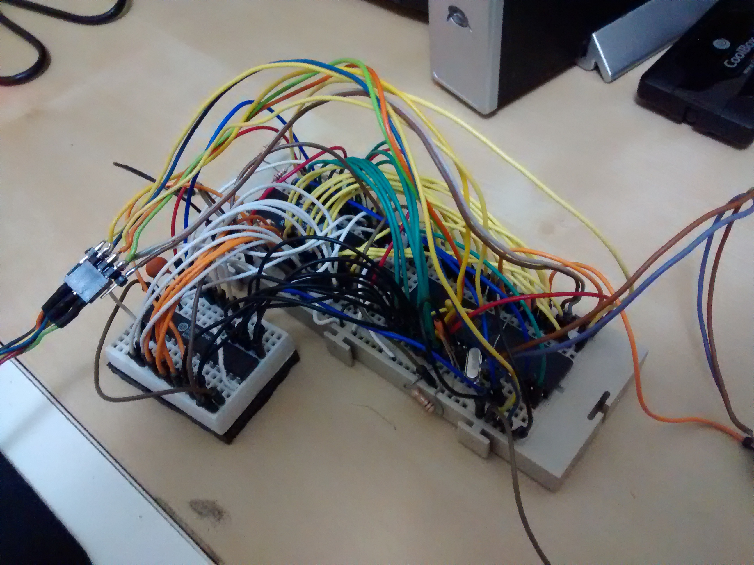

I developed it in a breadboard and finally I designed and ordered some PCB, I attach some photos including one of an ATMega16 16Mhz with Rockwell 65C02 version and one of an other using ATMega32 with 18.432Mhz crystal and the WDC 65C02, the small 8 pin IC's are i2c EEPROMS.
As the PCB has populated all the "important" buses and clock signals it can be relatively easy to drop out the ATMega and put on top an other PCB with common ACIA 6551, parallel EEPROM and some glue logic to make a more "real" computer, maybe next year :)

File comment: WDC 65C02 and ATMega32
File comment: Rockwell R65C02 and ATMega16
File comment: PCB's
File comment: early testing with breadboard
