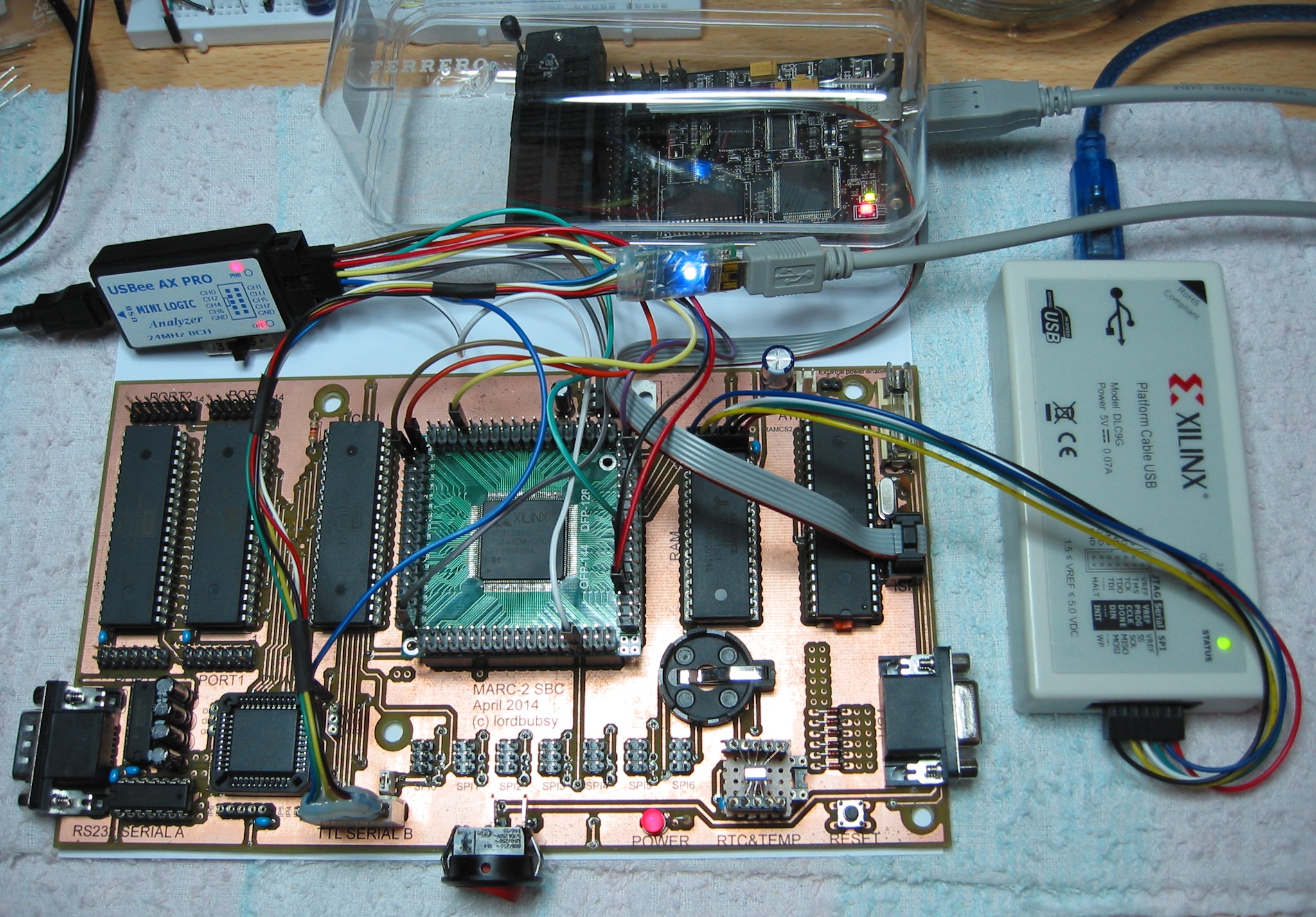

I've successfully combined 3.3V with 5V on MARC-2. The DUART, RAM and AVR are powered at 5V and the VIA's CPU and CPLD at 3.3V. while the CPLD has 5V tolerant I/O.
The IC's are from right to left:
ATMega1284P at 5V
512kB 55ns SRAM at 5V
XC95288XL TQ144 CPLD 3.3V with 5V tolerant I/O
WDC65C816S at 3.3V running stable at 7,3728MHz
2 x WDC65C22S at 3.3V
The lower left corner:
MAX232 at 5V
74HCT74 at 5V
SC26C92 at 5V
RV-3049-C2 at 5V (Real Time Clock with temperature sensor)
If the '816 accepted the 3.3V coming from the CPLD as a logical "1" while running at 5V, I'd be very happy, but unfortunately it doesn't. I'm still glad it runs at 7.3MHz though. I made several errors during the design, and even after building it I had to reroute the DUART's data lines to the right 5V RAM side of the CPLD.
It surely is about making compromises. But with this design I still have the opportunity to connect 5V devices to the expansion connector (around the CPLD).
