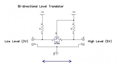

If you only need it for 1 or 2 lines and don't need blinding speed, you can make a bidirectional signal level translator with a little MOSFET like a 2N7000. I did a brief write-up on this a while back.
Signal Level Translation.doc [198.5 KiB]
Downloaded 157 times

Bill, what happens if you tri-state one side of that circuit? What does the output on the other side do?
PostPosted: Wed May 16, 2018 7:32 am
Posts: 660
Location: North-Germany
There are pullups one either side of the MOSFET. How can you tristate that?
PostPosted: Wed May 16, 2018 12:57 pm
Posts: 1007
Yes, they are only pull-ups, not totem poles. Like any line (/IRQ 0r /NMI for 6502 examples) that is pulled up with a resistor this line can be driven to whatever state you like, so the use of such a circuit is fine on a 3-state line. 3-state is only required for lines that have active (totem pole) pull-ups.
Just think about it for a while.
Here is an example: Lets say one side goes high-z so that the other side can take control of the line, then both sides will be pulled high until the controlling side asserts the line one way or the other. No conflict occurs.
