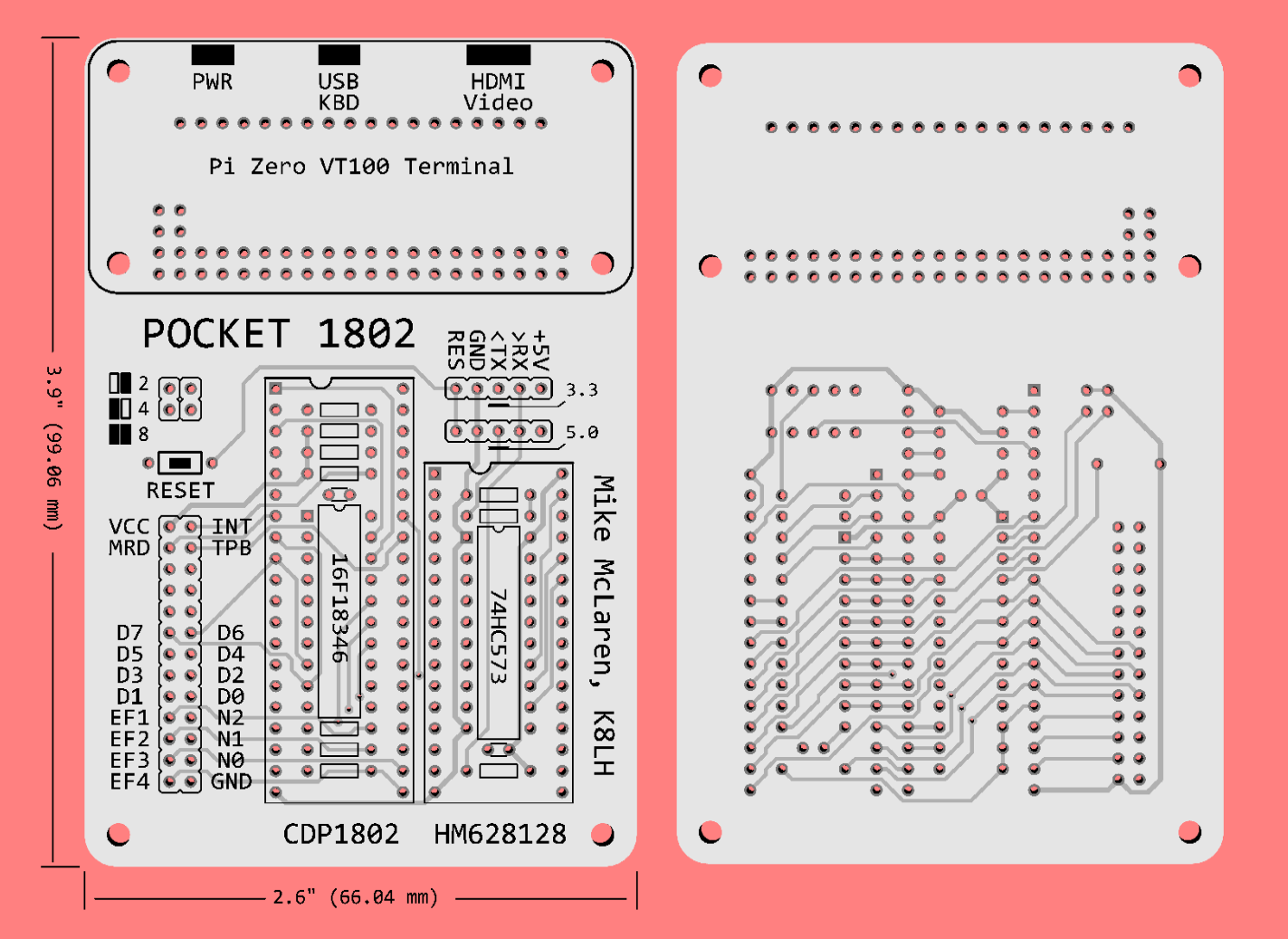

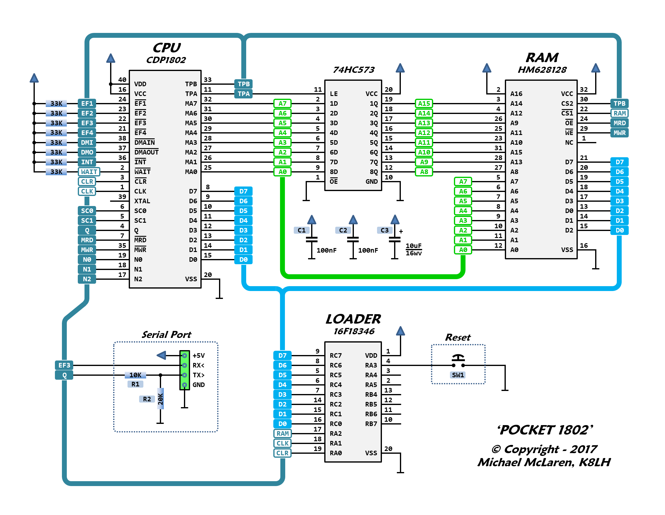

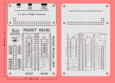

PostPosted: Tue Jan 16, 2018 4:31 pm
Posts: 589
You can also take control of the 65xx's I/O devices, since they read and write in the same way as RAM. :!: You could arrange to copy bytes from RAM to a UART, or vice versa -- IOW, a level-2 bootloader. Initializing the UART isn't a problem because that too can be faked with the cycle-by-cycle technique.
In fact, except for conditional branches the code-fake thing can do pretty well whatever you want! :mrgreen:
Bingo! As you mentioned, it's possible to extend the capabilities of a "blind loader", as I call it, to effectively have full "ROM Emulator" capability in 64K RAM-only system designs. That is, you could implement a "blind monitor" with memory view/edit, memory move, mini-Assembler, mini-Dis-Assembler, x-modem, flash, single-step, and go commands that doesn't require or take up any 65C02 address space.
Imagine, no more burning E/EPROMs as you develop and test your operating system code. Simply enter the "blind monitor" at startup and transfer your code via the 65C02 serial hardware into RAM (or use the mini-Assembler), issue "go" or "step" commands to test it, and use a "flash" command to copy it as a pseudo ROM image from RAM into microcontroller flash memory. Thereafter you would normally go directly into 65C02 operation with your monitor and operating system code in RAM after the "loader" operation, or you can choose to enter the "blind monitor" at startup.
All this capability using as little as 11 pins (8 data, 1 clock, 1 reset, and 1 RAM or Decoder enable) plus one pin on the microcontroller for a reset switch input. Coincidentally, these are pretty much the same eleven pins you identified long ago in this boot-loader post.
While I don't believe this is exactly what Mike (banedon) is looking for, I hope it provides some useful insights. I hope to order a PCB or two (examples below) to test this method more thoroughly in the near future.
Cheerful regards, Mike, K8LH

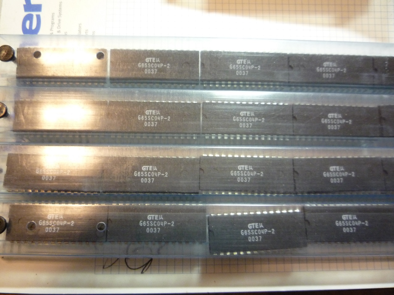

I'd love to try this method for a Tiny-BASIC computer using a CMOS 6504 (below), an 8K RAM, and a 65C51 or 63B50P ACIA. If you need a very small PCB you could place the narrow micro-controller and 8K RAM chips under the wide socketed CPU and ACIA chips.
