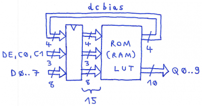

And now, I wanted to know.
When trying to translate the VHDL of Mike Field's 8b/10b encoder, I'm getting something like this (you better check for errors):
//Don't get confused: for the intermediade results, I had tried to stick with the DVI specification somehow.
D0..7 is a Byte which sets the color for one channel.
DE is display enable, if DE is LOW we are not in the visible part of the picture.
If DE is LOW, C0 and C1 of the blue channel seem to be the horizontal\vertical sync signals.
For DVI, C0 and C1 for the other two color channels are supposed to be LOW. //For HDMI, it's different.
Q0..9 is the encoder output which feeds the data inputs of a fast 10 Bit shift register.
The adder boxes labeled "HA" are half adders, basically an XOR gate and a AND gate,
sort of a habit when adding partial sums in a multiplier or such...

Of course, one could be cheating and use fast SRAM (preferably sychronous RAM) as a
lookup table (LUT) for replacing that lump of TTL chips,
but then one needs to initialize the lookup table in the RAM from a ROM at power up.
