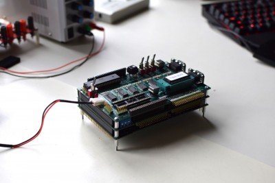

Wrestling the bad inter-card connectors off the boards proved a right mess. I ended up tearing a few annular rings from the plated through-holes and otherwise scarring the PCBs here and there - painful. Finally, though, I did get the new connectors on and the assembly properly stacked, with the SBC on top of the CPU. The whole thing is much tidier now, and should provide good signal quality for the 20MHz test:

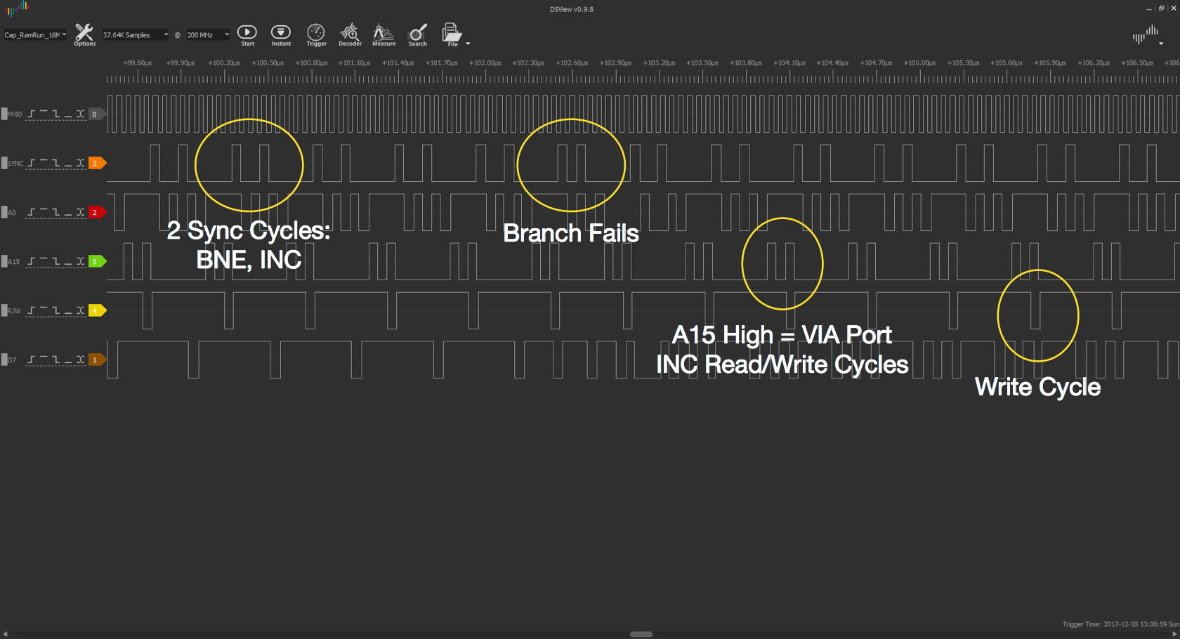

A quick run confirmed 16MHz operation even without resorting to the SLOW clock. That surprised me, since access to the 45ns ROM exceeds the available time. It suggests either the ROM or the CPU is faster than spec, which is good news either way.
I felt optimistic for the next step, but alas, the CPU refused to run at the target speed. Figuring out exactly why is likely to be very interesting, and I got started today by rigging up an USB Logic Analyzer to the various CPU pins. The test program consisted of a 16-bit increment of the VIA ports running from RAM (at 16MHz to begin with):
LOOP INC $A001
     BNE LOOP
     INC $A000
     JMP LOOP
Here's the capture:
Two Sync cycles in sequence, one 3 cycles long and the next 6 cycles long, corresponding to BNE followed by INC absolute. A little later in the sequence, we see a 2-cycle instruction, which means the branch failed and the loop will go on to increment the high-byte. During the INC instruction, we see A15 go high for the right Read and Write cycles of the RMW sequence. And Finally, the R/W line goes low for the write cycle.

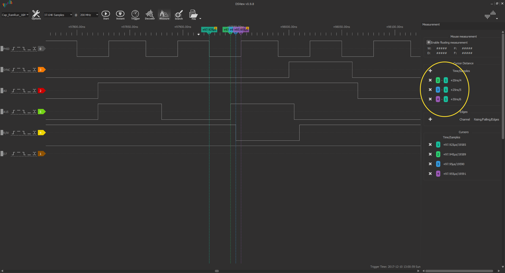

Looking more closely at the write cycle showed that the CPU was producing an address 20ns after PHI2 goes low and well before PHI2 rises again at the 30ns mark. Of course the half cycle is actually 31.25ns long, but sampling is at only 200MHz (which provides a 5ns resolution so we can't expect a more precise rendition of events. Even so, it looks great and the CPU appears to be running slightly faster than spec.
I couldn't make any sense of the 20MHz capture -- some very strange behaviour there. Definitely looking forward to digging into it. The Logical Analyzer can sample 4 signals up to 400MHz, so I'm hopeful it will do the job from here. More debugging to come ...
Fortunately 45ns is only the worst-case limit, and most parts are faster than specified.
Congratulations on the progress. That's a neat-looking sandwich! :D

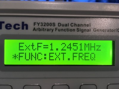

Gettin' ready to do some debugging this weekend with the Logic Analyzer:
I get lots of information by tapping the various CPU pins and using the frequency counter to measure the blink-rate of an output pin. I've started using a 16-bit blinky-light INC loop, which has (16 * 255 + 32)/256 = 16.0625 cycles per blink. It's a good test - the INC instruction runs a full pass through the ALU, with a read and a write to boot, and a BNE after that tests that setting flags and branching works. It's also very easy to see in the LA when the high-byte is incremented every 256 iterations. I managed to get hold of a 35MHz oscillator through the week and confirmed the CPU runs perfectly at 17.5MHz in the stacked configuration. Now it's time to really dig in and figure out what's wrong at 20MHz. On paper, it should work!

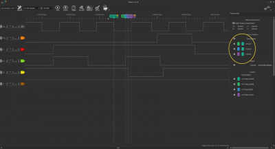

Before going on to the 20MHz tests, I re-worked the 16-bit blinky-loop to use the 6510 port for the low-byte. We know the time required for the TTL CPU to produce a valid address violates the VIA setup time at 20MHz. The 6510 port, on the other hand, has minimal setup time, and implements a full 8-bits internally (even though only 6 of those are presented at the CPU pins). It was an easy change to the code as far as it went, but of course the 20MHz capture I then ran still looked like nonsense:
Looking at it, though, it did seem like R/W was going low co-incident with the rise of PHI2. Without considering much else, that spells trouble, especially given that the measurement is accurate only within 2.5ns. R/W could in fact be missing the rise of PHI2 altogether, and worse, extending also into the next cycle to interfere with, say, an opcode fetch. That would certainly explain the erratic behaviour on the capture.

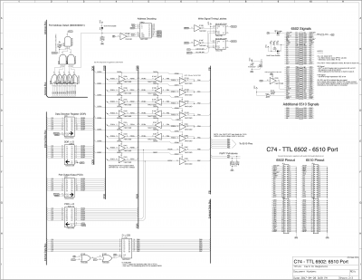

On the schematic, the signal path for R/W looked suspicious immediately:
The tolerances at play in the CPU are very familiar by now, and it’s safe to say three gates in series are just bound to cause trouble. Sure enough, MEM.W, which indicates a write-cycle, comes from the microcode through a decoder, and right-away, we’re beyond the 25ns half-cycle and in the red-zone:
Path      IC   tpd
MIR       74AC574   6.0ns (Microcode Instruction Register)
WR.MX     74AC238   8.8ns (Microcode Write Decoder)
OR        74AC32    5.5ns (R/W gate sequence)
3-AND     74AC11    4.0ns
INVERTER  74AC04    4.0ns
Total               28.3, or a max clock-rate of 28.3 * 2 = 56.6 => 17.6MHz
Interestingly, that turned out to be just fast enough for the 17.5MHz test that succeed previously, but it’s certianly not good enough for the 20MHz target.
The "DPH+1" signal going into the first (OR) gate in the sequence above is used only by a three undocumented opcodes. It allows the CPU to combine an increment of DPH with a write to memory in the same cycle. An easy fix, therefore, is to split the two operations into two consecutive microcode steps. Of course, that would make the CPU cycle-inaccurate, so a better option is to replace a couple of these gates with faster 74LVC1G equivalents and get R/W down in time. Now that requires a new PCB, so for now, I decided to just patch the existing board and bypass the initial OR-gate to put MEM.W straight into the 3-AND gate in the series. The next rev of the boards can include the permanent fix.
After the patch, the increment of the 6510 port seemed to work, but then the CPU went crazy on the high-byte. Just to validate, I limited the increment to 8-bits and took a capture:
This looked great! R/W is behaving itself and going low for the write-cycle of every INC instruction (which start at the second SYNC pulse of every pair). The low-bit of the 6510 port is also blinking nicely. All very encouraging, but what was wrong with the high-byte? The BranchTest signal-path was fine and so was the early BranchExit logic. Certainly there is nothing different about the second INC in the loop. Could be some sort of signal integrity problem? After a pause, the CPU seemed to run correctly just once before things went haywire again. Temperature? No way, really? ...
Then it hit me. I remembered the video Garth pointed out, which warns of the potential perils of probing a board that has high-edge rates. Suddenly, those test leads on the cheapy analyzer looked mighty long and noisy to me! I pulled them all off the CPU pins and left only the frequency counter on the low-bit of the 6510 port. Fingers crossed: if everything worked, it would cycle at just under 1.25MHz ...
Tada! ...
Man, it was the probes! Amazing! The blinky-loop was now running at 20MHz. Next up was the Dormann test suite, which I had re-jigged to repeat endlesley. I recall that each iteration had taken about two minutes at 1MHz. Now the TTL CPU was striding along, completing each in less than 5 seconds! Woweee ...
Ok, lots more validating to be done, but it may be root beer time again! :)

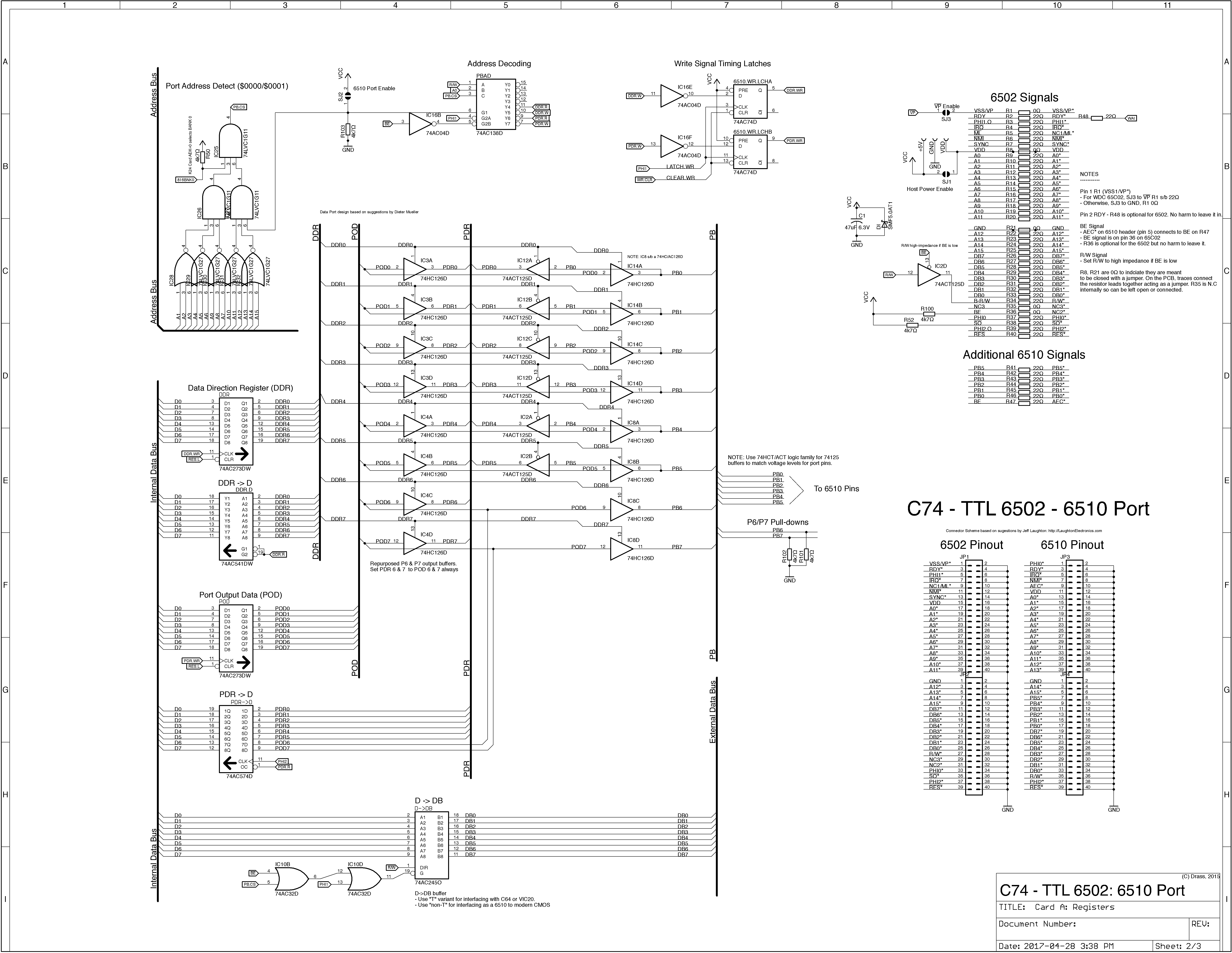

Thanks leepivonka! After a hiatus for the holidays, testing has now resumed. The good news is that 20MHz operation appears stable, which is great. But a problem surfaced with the 6510 port and it's got me stumped.
It has to do with the port's chip-select signal at high clock-rates. The address detector circuit driving the chip-select works just fine at clock-rates below 16MHz. Above that, it gets pretty interesting: if the code reading or writing to the 6510 port is executing below $0400, as with the blinky-loop above, it all works perfectly. However, if the code is running higher in memory, the chip-select does not turn on and the 6510 port fails. (Frustratingly, any reads and writes go to the RAM "behind" the port in that case, so everything seems well as far as the code is concerned. Tricky :evil:, I only noticed a problem when I hooked up some LEDs and saw nothing happening with the port).
The address detector circuit is top-left on the 6510 port schematic:
PB.CS is the chip-select signal in question. The address bus lines A[15..1] come in at the bottom of the detector circuit and pass through some 3-input NOR gates. Interestingly, addresses above $0400 have at least 1 bit high in A[15..10], and these bits go through the rightmost AND gate (74LVC1G11) above the NOR gates. For some reason, PB.CS fails to turn on when the bus address immediately preceding a read or write of the port is $0400 or above (as it would be if the code executing resides in memory at $0400 or higher) and this particular AND gate needs to transition it's output -- BUT, this only happens at high clock-rates.
Don't know why A[15..10] should be any different than A[9..1], nor why this IC misbehaves at high clock rates, but therein lies the mystery. I can't actually confirm exactly what's happening though -- the circuit fails the moment I touch a probe to the output of that AND gate, even with a slow clock! Probing anywhere else is fine, but that trace is very touchy for some reason. Digging deeper will have to wait until next weekend, but I thought I would share the adventure in the meantime. :)
