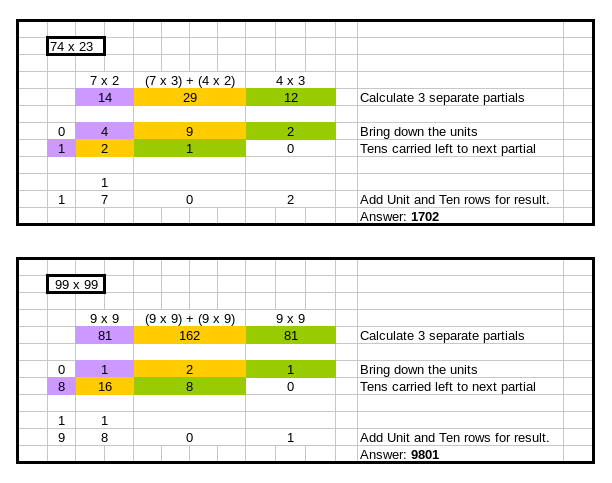

I started working on a test using the ūrdhva tiryagbhyāṃ Sūtra for multiplication, though ran into a 4bit shift issue of my own (too many).
I can probably expand the table to get around it.
Basically, the idea was to break the single 8x8 multiply into four 4x4 multiplies where the results can be fetched from a lookup table.
The table address consists of the high and low nyble to be multiplied with the data containing the result.
;     0    1    2    3    4    5    6    7    8    9  |---- Address  Padding ----|
.DB $00, $00, $00, $00, $00, $00, $00, $00, $00, $00, $FA, $FB, $FC, $FD, $FE, $FF   ; x 0
.DB $00, $01, $02, $03, $04, $05, $06, $07, $08, $09, $FA, $FB, $FC, $FD, $FE, $FF   ; x 1
.DB $00, $02, $04, $06, $08, $10, $12, $14, $16, $18, $FA, $FB, $FC, $FD, $FE, $FF   ; x 2
.DB $00, $03, $06, $09, $12, $15, $18, $21, $24, $27, $FA, $FB, $FC, $FD, $FE, $FF   ; x 3
.DB $00, $04, $08, $12, $16, $20, $24, $28, $32, $36, $FA, $FB, $FC, $FD, $FE, $FF   ; x 4
.DB $00, $05, $10, $15, $20, $25, $30, $35, $40, $45, $FA, $FB, $FC, $FD, $FE, $FF   ; x 5
.DB $00, $06, $12, $18, $24, $30, $36, $42, $48, $54, $FA, $FB, $FC, $FD, $FE, $FF   ; x 6
.DB $00, $07, $14, $21, $28, $35, $42, $49, $56, $63, $FA, $FB, $FC, $FD, $FE, $FF   ; x 7
.DB $00, $08, $16, $24, $32, $40, $48, $56, $64, $72, $FA, $FB, $FC, $FD, $FE, $FF   ; x 8
.DB $00, $09, $18, $27, $36, $45, $54, $63, $72, $81, $FA, $FB, $FC, $FD, $FE, $FF   ; x 9
I put together a couple of examples to help show the workings behind the math.
File comment: Urdhva Tiryagbhyam worked examples.
