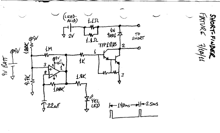

But a fat VCC trace can actually be a disadvantage in certain troubleshooting situations, such as when a chip or a bypass cap has shorted. You're better off to have skinny VCC traces because their resistance is high enough that there'll be a measurable voltage drop across the trace that feeds the shorted component. (Have been there and done this IRL -- a tidy solution to an otherwise nasty situation.)
I made myself a short-finder for this purpose, that puts 2A pulses through, at less than 2% duty cycle, and I can use the oscilloscope on the 5mV/div vertical gain setting to probe around the board and track down the short, even between planes (which usually means where there's a shorted capacitor that goes from one plane to another, but you can even detect where a short is in the board itself!). Here's the sheet in my 3x5" workbench quick-reference guide:
The op amp is just a cheap LM358 8-pin dual op amp.

Pulsing the current- I like that. Would an infrared camera help at all?
PostPosted: Fri Nov 10, 2017 8:09 pm
Posts: 8540
An IR camera might help if you don't pulse the current but limit limit the current to the highest level the traces can safely handle. A 2A pulse for less than 2% duty cycle is less than 40mA average which will only raise a .008" trace's temperature by about 1.5°C (and take a long time to do it). If the traces are underneath components though, or on an inner layer, it will be extra difficult. For a short between planes (which hopefully will be at a component), depending on the component, the current may have to be awfully high to find the short with an IR camera.
