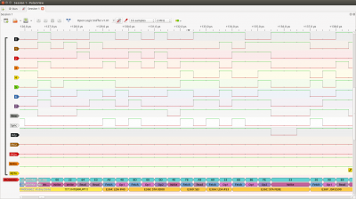

It's possible to capture the same data graphically using pulseview:
Zooming in slightly, you can see we have annotated individual bus cycles.
You can see each instruction starts with a fetch cycle, followed by optional operands, then finally any memory accesses. At least most of the time, as JSR is a little different. You can also see that the Master makes use of RDY to extend reads and writes to certain I/O addresses.
What's quite neat here is that even without any connection to the address bus, the protocol decoder very quickly starts predicting what the current program counter value would be. The algorithm for doing that (mostly down to Ed) is here.
