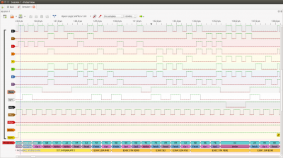

This was produced from sigrok-cli, and you might recognise it as the first few instructions of a BBC Master after reset.
It's possible to capture the same data graphically using pulseview:

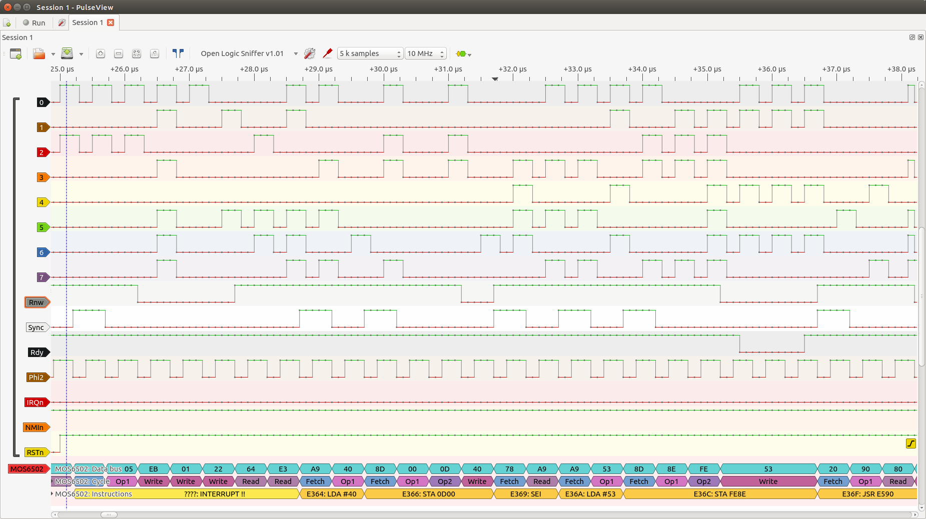

Zooming in slightly, you can see we have annotated individual bus cycles.
You can see each instruction starts with a fetch cycle, followed by optional operands, then finally any memory accesses. At least most of the time, as JSR is a little different. You can also see that the Master makes use of RDY to extend reads and writes to certain I/O addresses.
What's quite neat here is that even without any connection to the address bus, the protocol decoder very quickly starts predicting what the current program counter value would be. The algorithm for doing that (mostly down to Ed) is here.

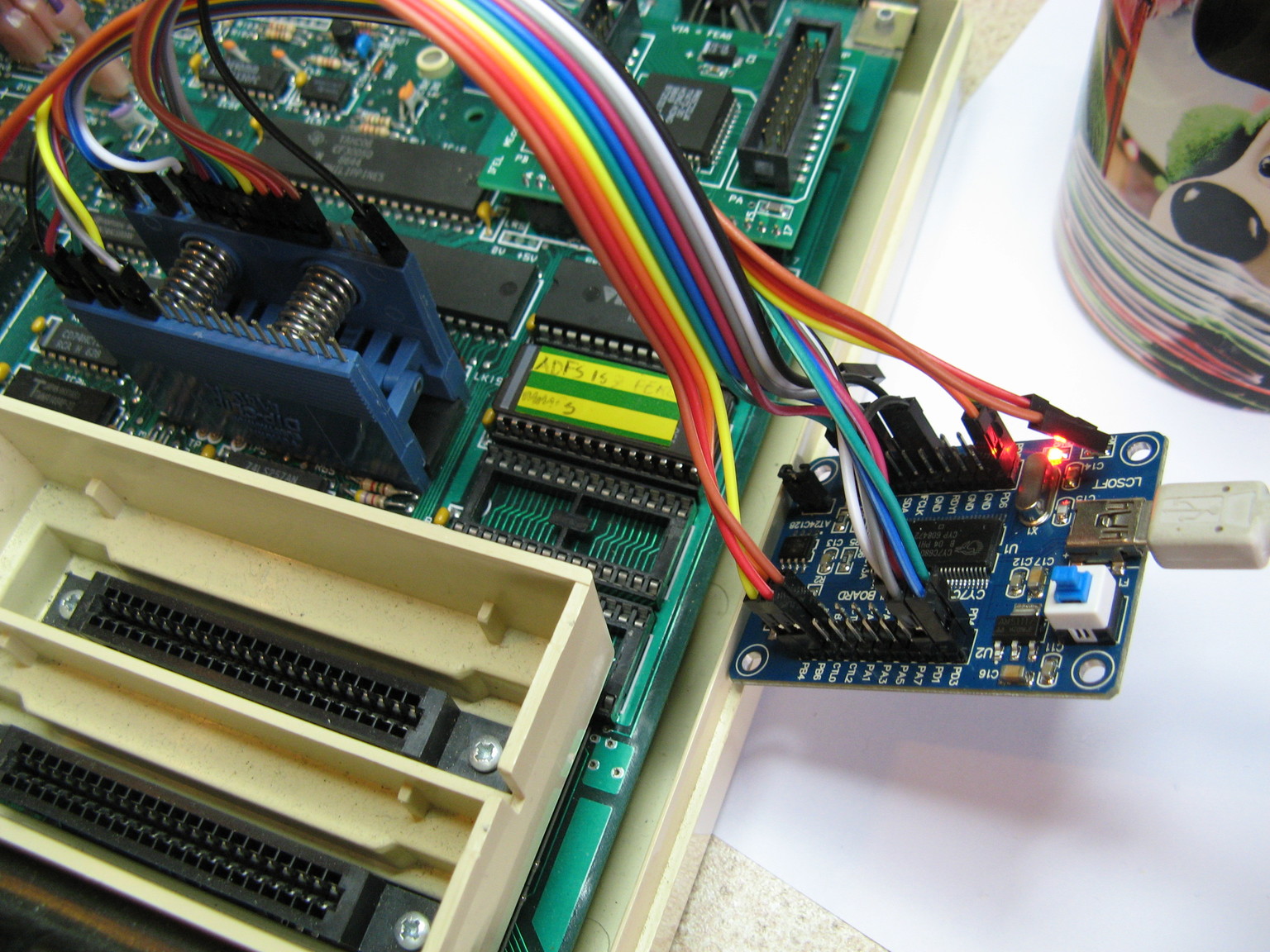

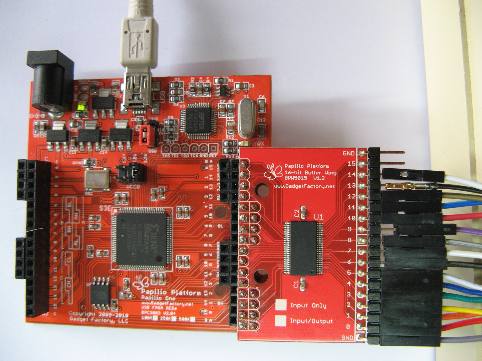

In terms of capture hardware, this should work with anything that is supported by Sigrok that has at least 12 channels and can sample at ~5x the CPU speed. I've tried out a couple of different logic analyzer implementations:
The first was a version Open Bench Logic Sniffer that I recompiled for my Papilio One FPGA board:
This supports sampling at up to 200MHz, and allows for synchronous sampling (where Phi2 is used as the sample clock). But it stores samples in FPGA block RAM, so the capture depth is quite limited (a couple of thousand instructions).
The second was a cheap (£12.49 from here) Cypress FX2 development board:
This streams data directly to host memory, so supports much longer captures. But it's limited to 12MHz sampling, and doesn't support synchronous sampling. I've successfully captured in excess of 2 million 6502 cycles, which is more than enough for the complete startup of the BBC Micro.
Both interfaces work very well in practice, and the 6502 protocol decoder supports both synchronous and asynchronous sampling (based on whether Phi2 is wired up or not). A decent 40-pin DIP clip is highly recommended, as most cheap test grabbers are absolutely rubbish.
