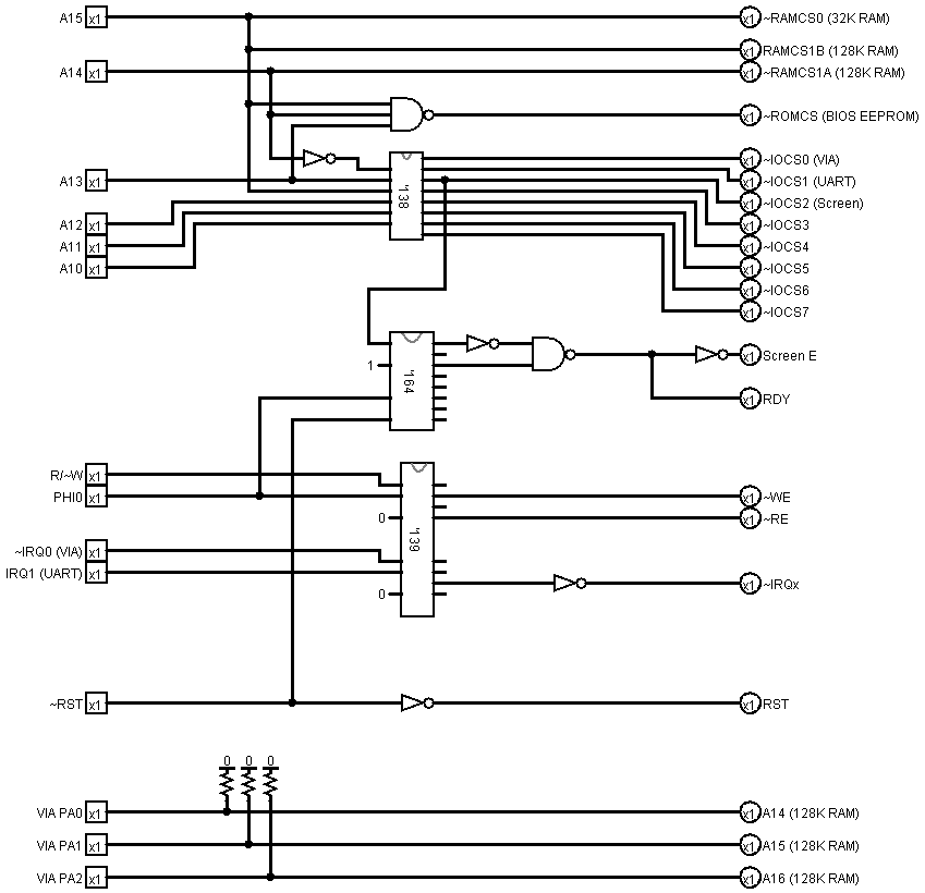

Alarm Siren wrote:
Its down to three chips and three inverters [... ] I doubt we can make it much simpler.....
Not much simpler, no. At first I thought we could dispense with that inverter on the input of the '138, but that turns out to be a dead end (despite a '138's otherwise versatile complement of active-high and active-low enable inputs).
Yea, it is most irritating.
However, the 4-input AND can be deleted. Instead, /CE for the EEPROM can be generated by a 3-input NAND fed by A15-13. A single 14-pin DIP holds three 3-input NAND's, so there are two left over... which can function as inverters. So, we're down to down to three chips and one inverter. Maybe you'd like to eliminate that last inverter by just using a transistor to complemet Reset?
Yea, I was going to use the second quad AND gate as an inverter but, well, I had a senior moment and forgot that of course an AND gate can't invert... The NAND works better anyway, less prop delay and we get two inverters out of it instead of just one.
So, the final count is a 74x138, a 74x139, a 74x10 and a 74x1G00.

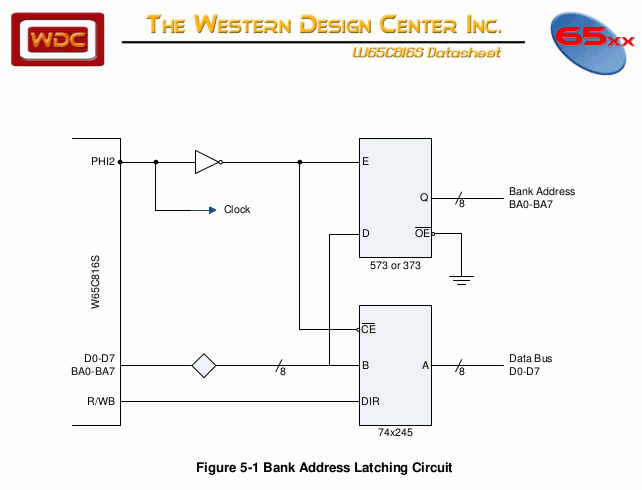

Alarm Siren wrote:
As for the '816, I'll note in passing that it doesn't force you to jump into the deep end of the pool; it has mode bits which turn off its 816-ness by default. Later you can progressively enable those bits one by one and wade into the pool at your own pace.
Yep, and it will be easier both in hardware and in software.
Its not the software side of the '816 that concerns me; I'm fully aware that you need only use as much of its extra features as you want to. Its the hardware that concerns me, particularly that multiplexed data bus.
From the data sheet:
Pretty simple.
The W65C265S exposes all 24 bits of the address bus.
Probably a bit overkill to save the wiring and two chips in order to decode the bank register (there's a suggested circuit in the '816 data sheet to decode the bank/data bus), but it's there. Also need to jump through a couple hoops to just use it as a raw CPU (notably disabling ports and what not). It's also slower (8Mhz v 14Mhz) and more expensive (~$24 vs ~$9).
You can also look at the schematic of the W65C816SXB to see it in action. BD's POC v1 schematic I'm sure has that logic laid out as well.

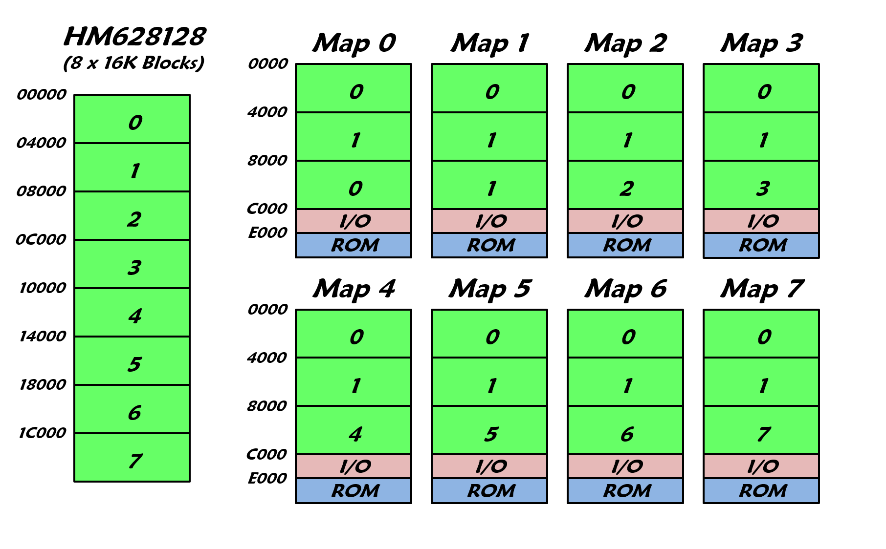

Was your original mapping with a single 128K RAM chip something like the diagram below, and now you're simply adding an additional 32K RAM chip and mapping it into address space at $0000-$7FFF unconditionally for each map?
Mike
PostPosted: Wed Sep 27, 2017 10:14 am
Posts: 362
Yes Michael, that is an exact representation of the original map. I'm pretty happy with the new map though, it significantly simplifies the glue logic and gives me an extra 32K to boot.

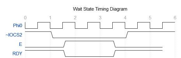

So, here's my attempt at adapting André Fachat's Circuit to my immediate needs, the new parts being the '164 in the middle and the logic connected to it. I have also attached a timing diagram showing how I believe this circuit will work with respect to the relevant signals for the wait stating. In particular the E Period between cycles 1.5 and 3.5 should be roughly 500ns, which would meet the Tpw requirements of the LCD. Provided my timing diagram is an accurate representation of what will occur, I believe that this would allow it to work in a 4MHz system.
File comment: Wait State Timing Diagram
File comment: Glue Logic Diagram
