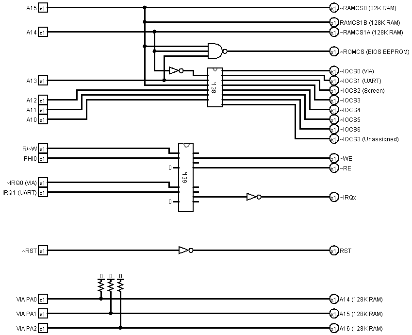

Alarm Siren wrote:
Its down to three chips and three inverters [... ] I doubt we can make it much simpler.....
Not much simpler, no. At first I thought we could dispense with that inverter on the input of the '138, but that turns out to be a dead end (despite a '138's otherwise versatile complement of active-high and active-low enable inputs).
Yea, it is most irritating.
However, the 4-input AND can be deleted. Instead, /CE for the EEPROM can be generated by a 3-input NAND fed by A15-13. A single 14-pin DIP holds three 3-input NAND's, so there are two left over... which can function as inverters. So, we're down to down to three chips and one inverter. Maybe you'd like to eliminate that last inverter by just using a transistor to complemet Reset?
Yea, I was going to use the second quad AND gate as an inverter but, well, I had a senior moment and forgot that of course an AND gate can't invert... The NAND works better anyway, less prop delay and we get two inverters out of it instead of just one.
So, the final count is a 74x138, a 74x139, a 74x10 and a 74x1G00.

And now I discover that the screen has a minimum cycle time of 1.2ms; given I intend to dangle it off the CPU bus and my target CPU speed is 4MHz/250ns.... yea, I'm going to have to put in wait-states for that. Lovely :roll: .
Though having said that, I'm not 100% certain that it really does require such a cycle time. I'll get the relevant datasheet and discuss my thoughts on the matter tomorrow.
DerTrueForce
Posts: 483
Joined: 04 Jun 2016
Location: Australia
Re: Monster Decoding Logic
Post by DerTrueForce »
An idea might be to put in a pulse-stretcher and a latch.
By which I mean, put latches between the bus and the screen, and have a timer, triggered by the inactive edge of the enable signal, that holds all the signals in a valid state for long enough that the screen can respond. Then when the timer runs out, it deasserts the enable signal that the LCD sees.
The only problems I see with this are that that's a fair amount of hardware, and you'd have to wait between accesses.

I only have one VIA and there isn't enough pins left on it to drive the LCD screen. I would very much rather not add a second VIA to the system if I can avoid it as VIAs are not cheap components, and they take up a lot of space (relatively speaking compared to a couple of logic gates). Also this is as much a learning experience for me as it is an attempt to make an efficient system. I've never done wait states before (more on that below), so its an opportunity to learn.
the next thing is to check its busy bit before writing to it again.
I know about the busy bit, but it won't help for this issue. With the LCD directly on the CPU bus at 4MHz, the read/write timing specification is violated so I won't even be able to read the busy bit, let alone read or write anything else.
Link to LCD Screen Datasheet
Link to LCD Controller Datasheet
If you look at the timing diagram on page 30 of the controller datasheet and the AC Characteristics table on page 32, one can see that the two critical timings for this purpose are Tc and Tpw. Tc is the total time between rising edges of E, minimum 1200ns; Tpw is the minimum width between the rising edge and the falling edge, minimum 480ns.
Overall I don't think that Tc is an issue because (with the possible exception of RMW instructions) I don't think its possible for the 65C02 to access the same memory I/O device quicker than once every four cycles... e.g. STA $C002 takes four cycles to execute, only the last one of which is an actual write to the I/O device. So, for the purposes of Tc, one could argue that the access rate has dropped from a potential 4MHz to a potential 1MHz. Yes, technically 1MHz is still too fast for Tc, but it certainly a lot better.
Tpw is a bigger problem though. E would be high for only 125ns on a 4MHz system (ignoring prop delays) and there really is no way around that. Not to mention Tdsw requiring a data setup time of 80ns before E's falling edge, so with prop times it'd be cutting it close. So, I think that for accesses to the screen I would need to stretch the access over three cycles. 125ns + 2*250ns = 625ns > 480ns. This has the additional bonus of increasing the total length of the cycle for the purposes of Tc and should therefore keep that in spec too, taking into account the stuff I've already stated.
Two options for stretching the screen accesses: 1. stop / disconnect PHI0 for a specified period. 2. Use RDY. I prefer the latter option, gating the clock seems like a bad idea. That brings me to André Fachat's RDY Generator Mini Project, which looks like it will do what I want, but I'll be honest, despite staring at it for hours I have no idea how it works, and I am uncomfortable using glue logic that I don't understand. Also there might be a simpler way to implement wait states that you lot have hidden up your sleeves; this one appears to require a minimum of three extra chips.
I'm going to do some thinking and experimenting in the mean time, but I shall await your collective wisdom with anticipation.

Was your original mapping with a single 128K RAM chip something like the diagram below, and now you're simply adding an additional 32K RAM chip and mapping it into address space at $0000-$7FFF unconditionally for each map?
Mike

Yes Michael, that is an exact representation of the original map. I'm pretty happy with the new map though, it significantly simplifies the glue logic and gives me an extra 32K to boot.

So, here's my attempt at adapting André Fachat's Circuit to my immediate needs, the new parts being the '164 in the middle and the logic connected to it. I have also attached a timing diagram showing how I believe this circuit will work with respect to the relevant signals for the wait stating. In particular the E Period between cycles 1.5 and 3.5 should be roughly 500ns, which would meet the Tpw requirements of the LCD. Provided my timing diagram is an accurate representation of what will occur, I believe that this would allow it to work in a 4MHz system.
