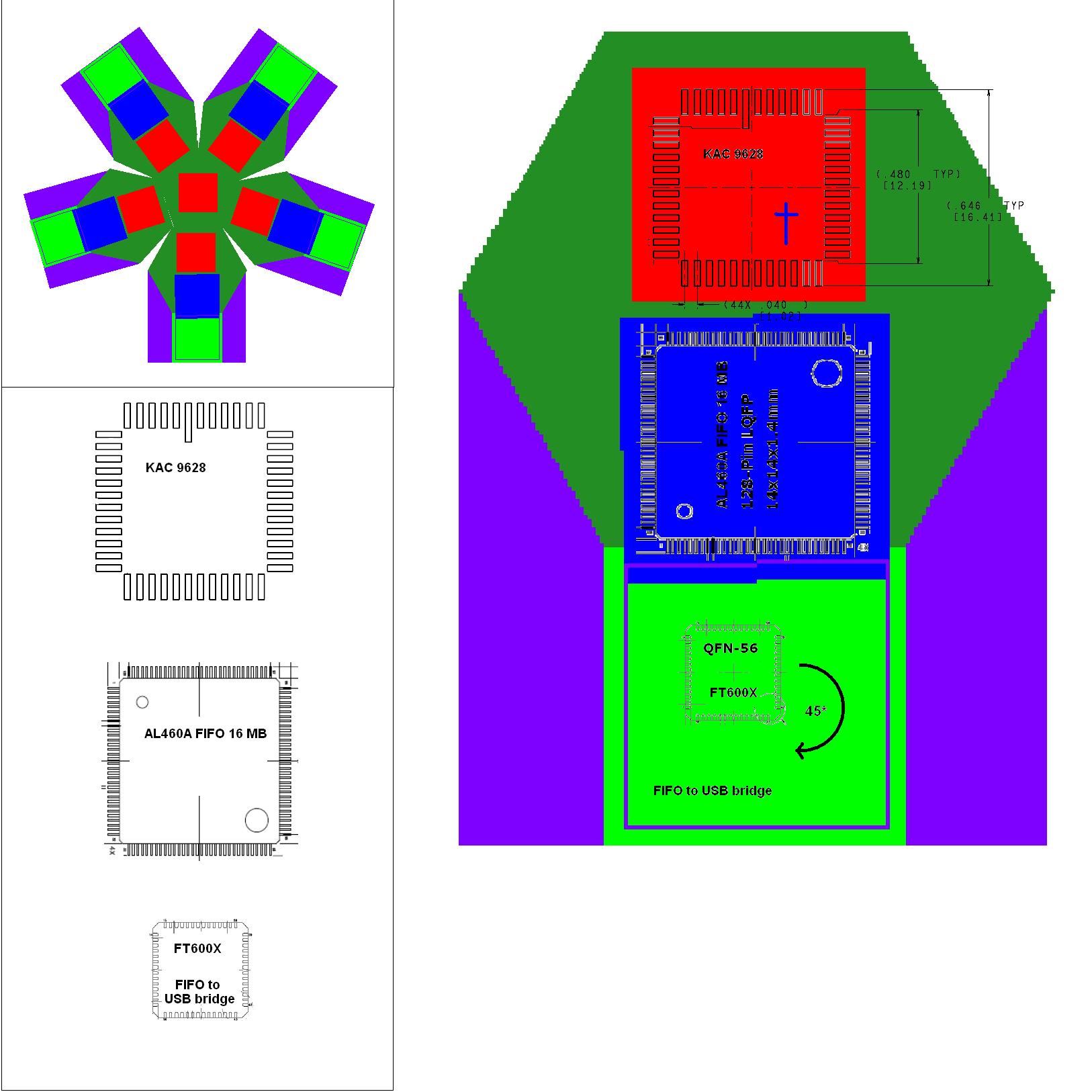

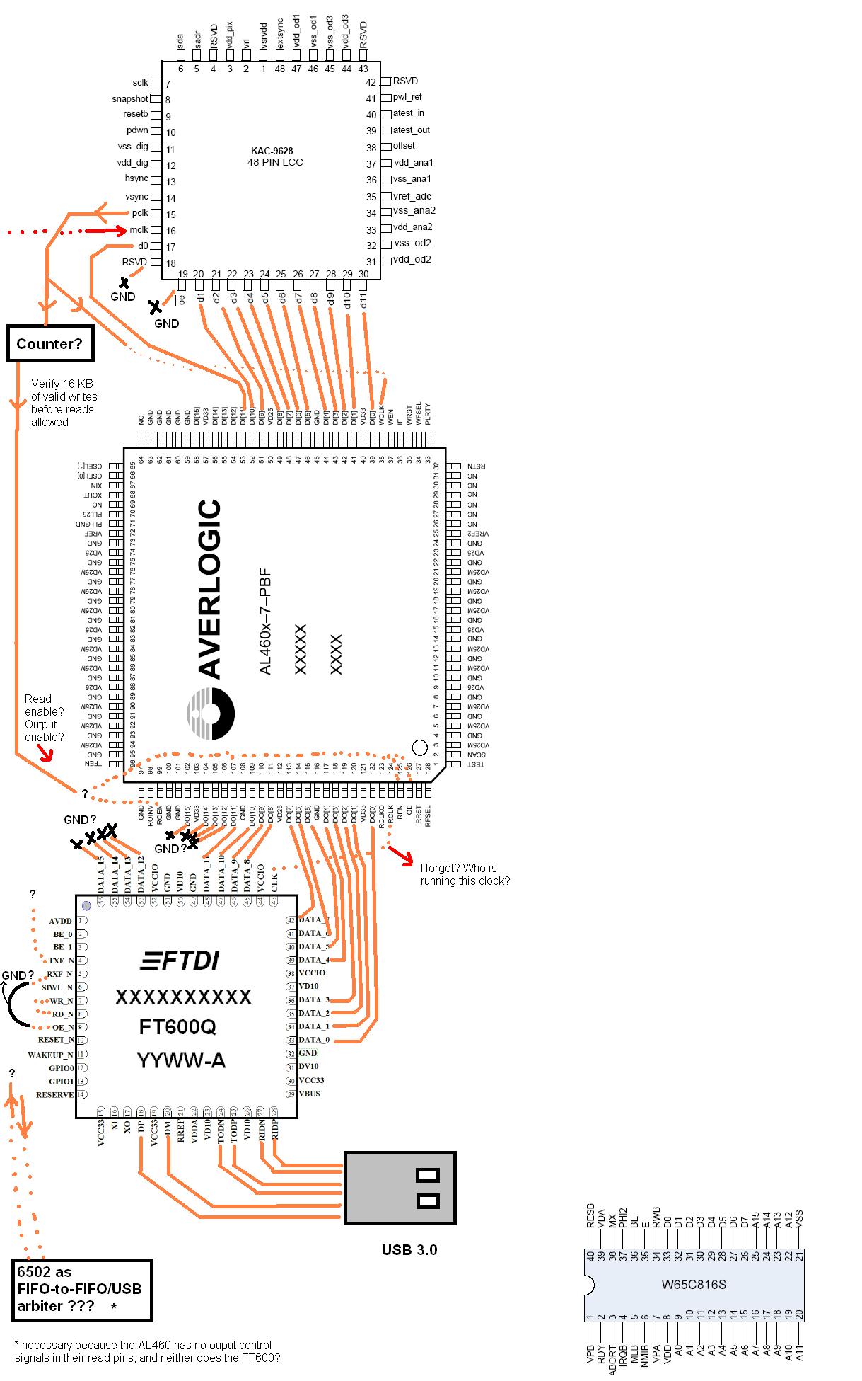

PostPosted: Thu Aug 31, 2017 5:14 pm
Posts: 255
Twelfth times a charm ?
A Ha! Easy Peasey Japon-esey ... Voila!
Rudimentary sketch. I have done more, but had to run off and see the kid got on the bus this morning. First day back to school, and he is old enough to notice if I'm not there. Speaking of, now that I am done screaming at the computer, I must run to see that he gets a snack when he gets off the bus!

PostPosted: Thu Aug 31, 2017 6:14 pm
Posts: 255
OK, just a quick post explaining the inadequacies of my previous post/schematics.
Of course, obviously, no power or clock sigs, yet, as my brain has yet to solidify around any solutions. I think one or two good, standard linear regulator ICs, should do the trick.
Clocks are easy for the FT600 and AL460; just a GOFXTAL (Good Old Fashioned XTAL). KAC uses a funky discontinued Cypress PLL fanout/thingy, but they have a replacement part on their website. I'll probably not rock the boat and just use their recommended thing.
No control signals yet? You see the fuzziness of my brain on the FIFO to FIFO-USB interface. Also, note that the 6502/65816 in the schematic is one or the other. I happen to own an '816, but would probably purchase '02 for the project (or just use the Z-80 some guy just gave me). I dunno.
And, on the other diagram, the colorful one, please note that things are approximate scale; approximately scaled to the KAC. That's about it, for now.
PostPosted: Sat Sep 02, 2017 5:43 pm
Posts: 255
OK, there shouldn't be too many more postings here, for awhile. I think I got most of my initial (electronics) design roughed out, and most of the remaining work can be done by me. Thanks for all your help.
Unfortunately, it will NEVER function as I had hoped it would. Maybe it will. But I think not. The off-the-shelf imagers have a cover glass over each one, and might stymie my efforts to interface with a customized lens.
For now, I should go and try to build/design the customized lens, anyway (sort of abandoned my efforts to do so, back in 2008, and again in 2011. Not for lack of success, but for lack of a curved imager to "co-design" it with).
I consider the above schematic to be enough of a "proof of concept" that I can try to solve other problems associated with anthropomorphic cameras. Of course, I will still build it, I just won't obsess about prooving it or obsess about back-of-the-envelope calculations and such!
