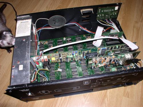

This is just a shot in the dark, but who knows, maybe we have the same machine.. I have an old Norwegian Apple ][ clone called West PC 800. It has both a 6502 and a Z80 on the motherboard, you can see pictures of it here:
http://multinet.no/~skurk/westpc/
All comments are in norwegian, but to sum them up:
It was shipped with an internal 300 baud modem, burglar alarm for your house, disk controller with 5.14" floppy drive. and some more nifty stuff. This is the West PC production number 426 out of a couple of thousand, and today, it's probably one of a handful left in the world.

Ernest wrote:
That is a very cool clone! I've never seen or even heard of it before, but it's on the site now. Skurk, you should definitely add more pictures and information for it as you have time.
Thanks! I got this machine in 1987 (I think) and this was the computer that introduced me to assembly programming - and have been stuck there ever since. I'll upload more images of this computer later, let me know if you want to see anything in particular.
Ernest wrote:
I wonder if your clone was sold as a home security system, rather than as a desktop computer?
I don't remember, I think this computer was marketed as both. Apparently noone got the security system to work (or at least I've never heard of anyone who did). The introduction price back then was about 20,000 NOK (~$3,000).
Ernest wrote:
If so, that might explain why no one has heard of it (as an Apple clone.)
I believe only a couple of thousand machines were sold before West Computers got sued by Apple for producing unlicensed clones (IIRC).
This computer isn't working at the moment, a separate card in front handling the keyboard is physically broken - yes, it's cracked and missing a piece! :-o Until I find a replacement, I'm stuck with about 50 floppies filled with memories waiting for an evening filled with nostalgia. Getting such a card these days may be hard, so I'm currently browsing eBay for an used Apple ][. If anyone's got one spare and want to sell it cheap, then let me know :-)
