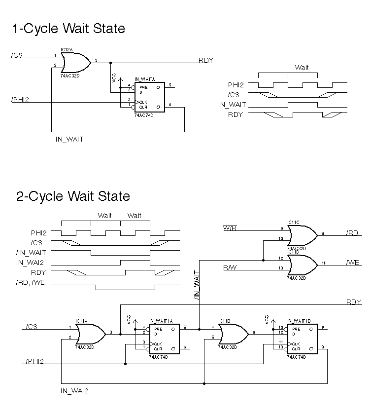

It'd be better to increase the address setup time seen by the peripheral by having the OE and WE pulses endure for only half of the 2-cycle period.
Sold! Love your circuit.
The whole question of the right split between address setup time and pulse width is key ...
Address Setup time is quoted as 10ns for SC26C92 UART, whereas the minimum pulse width is fully 70ns! By those figures, it seems favouring the pulse width in the tradeoff may be best here. At 20MHz, a 25/75 split feels just right (100ns cycle with a wait-state), especially considering how quickly the WDC 65C02 gets an address on the bus. But the TTL CPU is much slower on that score. It takes 21ns for it to produce an address (in theory that is) and it really needs the additional setup time that a 50/50 split affords. However, that ratio likely would put the pulse width offside for the UART (I know the UART works with a 62.5ns pulse, but 50ns seems like a stretch). I need a 50/75 split :mrgreen:
But I'd be happier if it also allowed extra time after OE and WE go false.
Me too! An extra half-cycle would be just great ...
I'd recommend putting a 22pF capacitor across that resistor

Just stick in an extra half-cycle after OE and WE go false. Of course an entire extra cycle would do the trick, but that's more of a performance hit.
It does seem one potential solution is to go ahead with an RDY wait-state circuit and add a second flip-flop to extend the wait-state to three cycles for the UART, one cycle of address setup and two cycles of pulse width. Or were you suggesting a hybrid approach, using RDY to pause the CPU but the also pausing the clock to stretch the pulse width in the middle of the wait-state?

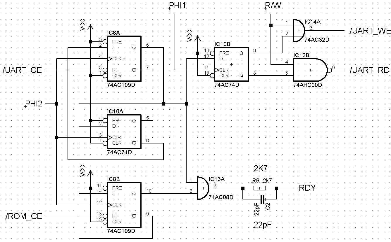

Spent some more thoughts on making use of Jeff's circuitry.
IMHO running the 6522 with PHI2/2 isn't a good idea...
because if we would be (hypothetically spoken) using the SBC later for testing a TTL implementation of the 6526,
we can't test if it would be working at 20 MHz.
I'm attaching a schematic about how I would be trying to build the RDY wait state circuitry "if it would be my project",
the schematic adds wait states for UART and ROM access only:

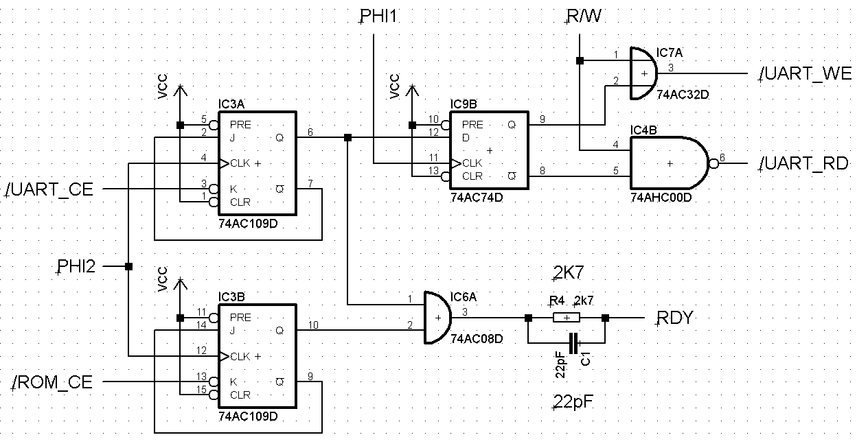

PostPosted: Fri Aug 04, 2017 12:26 pm
Posts: 1429
Dang !
From the datasheet of the SC26C92C1A UART in the SBC,
it appears that /WE and /RD for that UART have to be active for >70ns !
With the schematic in my posting above...
if the CPU would be runing at 20MHz, /WE and /RD would be active for one cycle, and that's 50ns.
So the UART needs two wait states, and /WE and /RD need to be active in those two wait states.
Fortunately, Jeff did a circuitry for two wait states:
So after modifying my schematic to have two wait states, it looks like this:

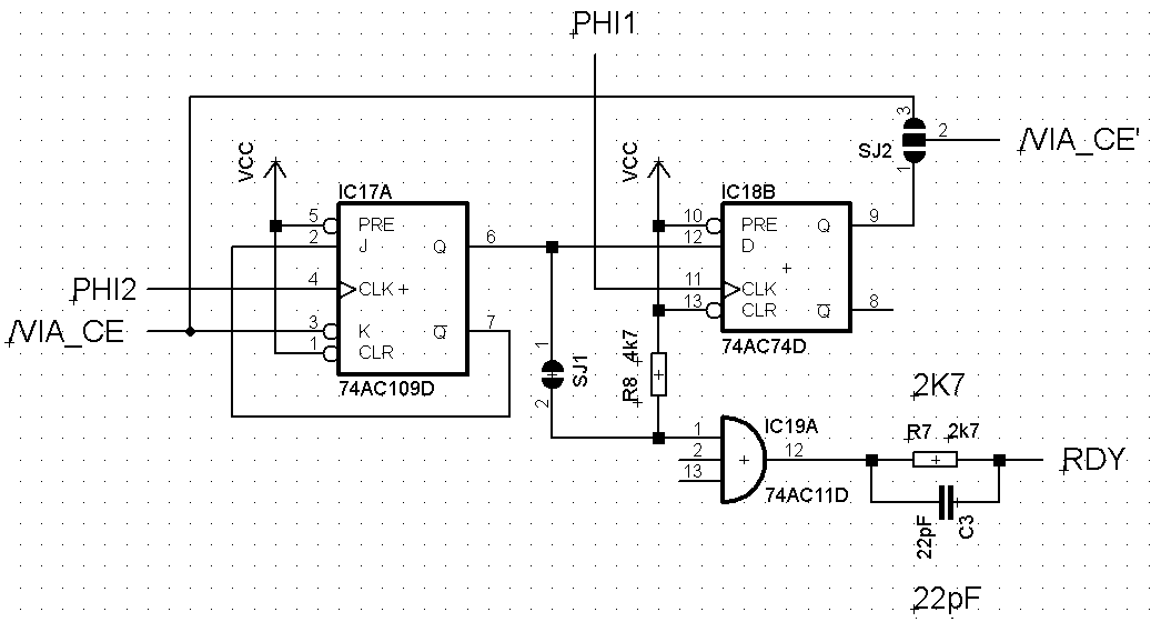

PostPosted: Fri Aug 04, 2017 3:18 pm
Posts: 1429
Houston, we have a problem.
The W65C22 datasheet says, that address and /CS are supposed to be stable >10ns before the rising edge of PHI2.
If the CPU is running at 20MHz, PHI2 would be low for 25ns.
This gives a setup time for TTL CPU plus address decoder of <15ns after the falling edge of PHI2.
WDC datasheets might be on the conservative side, since there are rumors that a W65C02 could be overclocked to 20MHz.
That's 42.8% more than specified. When considering this for the W65C22 VIA timing:
There might be (in theory) a chance that >7ns before the rising edge of PHI2 might do for the VIA,
what would give CPU plus address decoder a setup time of 18ns after the falling edge of PHI2.
Maybe one would want to check if the TTL CPU works at more than 20MHz,
so we should consider the option to add a wait state for VIA read/write access.
On the other hand, if we would be (hypothetically spoken) trying to build a TTL implementation of the 6526 later,
it would have a setup time relative to the _falling_ edge of PHI2, and that's why we need jumpers to disable that wait state.
IMHO the best trick is to tinker with the VIA /CS signal, so the VIA still can be clocked with PHI2.
A little schematic of what circuitry might be required:

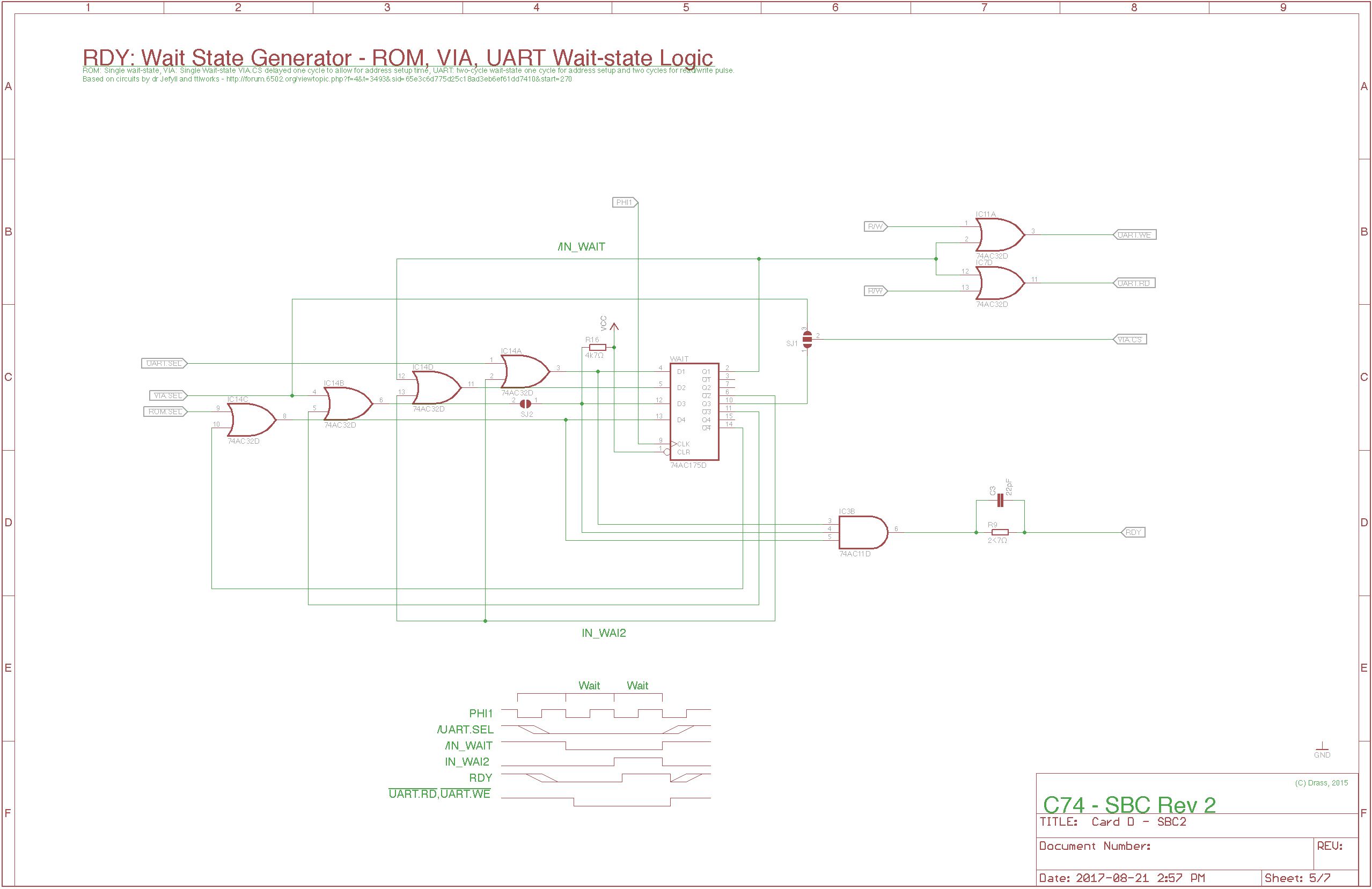

PostPosted: Wed Aug 23, 2017 2:20 am
Posts: 428
Location: Toronto, ON
I finally had a chance to implement the wait-state circuit above on the SBC, and only then did it dawn on me that it will not work with the TTL CPU after all. The problem is that the J-K flip flops require that chip-enable signals be available before the rising edge of PHI2, and that runs into the same issue as before: namely that the TTL CPU takes too long to generate an address and leaves no time for the downstream logic. At 20MHz, the /CS signals just don't get there in time.
But in fact RDY doesn't have to go low until just before the falling edge of PHI2 in order to take effect, so there is considerably more time here to react. Kicking the issue around with dr Jefyll and ttlworks produced the following alternative circuit:
Notice in the timing diagrams that the /CS signal can arrive after the rise of PHI2, and the circuit allows it to continue through the OR-gate to bring RDY low in time to pause the CPU. The flip-flop then looks after bringing RDY high again in the subsequent cycle. As expected, a two-cycle version of the circuit chains two flip-flops together, and we can generate the delayed /RD and /WE signals for the UART just as before.
Similarly, the CE signal for the VIA can be delayed also as before to prevent spurious reads or writes to that chip. ROM presents no issue in this regard, but we do have to be careful with writes to RAM. Fortunately, the TTL CPU does supply a valid address just prior to the rise of PHI2 and the setup time for RAM is mercifully short. In addition, the single gate-delay between PHI2 and /WE provides a little additional comfort in this respect. All told, I'm fairly certain no writes to RAM can occur with an invalid address. Even so, fingers are firmly crossed on all this. The hope is that if the TTL CPU can actually manage 20MHz, it will do so with all supporting ICs fully functional. :)
Below is the circuit as adapted to the SBC, using just an additional 74AC32 and a 74AC175 to make it work. I've now run a couple of tests with the 65C02 on a breadboard and finished re-routing the SBC. (Incidentally, my only evidence that the RDY circuit works correctly is that I observed A15 cycling every ~32.5ms with the data bus fixed at $A9 and a 2MHz clock - 65,536 addresses at 500ns each - and then saw the interval double with single wait-states engaged. Not exactly proof, but it'll have to do). I also took the opportunity in passing to rewire the RS-232 ports as DTE ports and also made sure /OE is qualified by PHI2 for the UART, among other things.
... and, I'm happy to say, THAT IS THAT - all four cards in this crazy project are now ready for manufacture (REGISTERS, ALU & CU, K-24 and SBC cards). With some luck, I'll be posting a pic of a 4-board panel soon! :shock:
Cheers for now,
Drass
