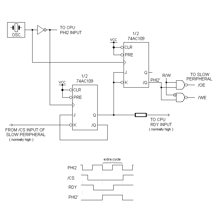

I was thinking about using RDY to implement the wait-state circuit for Rev 2 of the SBC. Since I have Rev 1 to use for debugging the TTL CPU, Rev 2 can dispense with a lot of complexities and just focus on speed - no need for single-cycle or step clocks. That should make for a faster wait circuit to handle a 20MHz clock.
Clocking a "divide by two" flip-flop wth PHI2 seems to be enough to generate the right timing for RDY. But for touchy peripheral ICs, it seems /WE and /OE must also be kept low throughout the wait-cycle even as PHI2 rises and falls. Otherwise, the peripheral will "see" two short read/write operations rather than one long one. It seems that if /OE and /WR are left qualified only by PHI2, either the minimum pulse width requirements would be violated or spurious reads and writes would be made. Either way, the wait-state would fail.
I'm thinking the solution is to derive /OE and /WE from PHI2', where PHI2' = (PHI2 OR /RDY). That should keep the read and write enable signals low for the extra cycle and give peripherals enough time to respond.
Do I have this right?
Almost.
RDY is it is a bi-directional signal. If the MPU executes a WAI instruction it will also pull RDY low until the interrupt comes. Hence your logic has to know whether RDY is low because of a wait-state or because of a WAI instruction.
Rather than try to explain everything, attached is a copy of the glue logic for POC V2, which includes wait-state generation.
glue_logic.txt
CPLD Source Code w/Wait-State Generation
(16.71 KiB) Downloaded 83 times
Hey, wait a minute! Recently you said you were resisting the urge to develop new software because it would distract you from the main project -- the TTL 6502. But now you're getting distracted with new hardware!? :wink:
I like the PHI2' idea but I'd generate it differently. If I understand correctly your method gives OE and WE pulses which endure for 1.5 cycles -- they begin very soon during the 2-cycle period devoted to the access. It'd be better to increase the address setup time seen by the peripheral by having the OE and WE pulses endure for only half of the 2-cycle period.
Posted below are the original wait-state circuit discussed elsewhere and a revised version with added logic to generate PHI2'. Extra sets of eyes welcome -- I'm up past my bedtime!
Darn! -- I overlooked that. But after blinking my eyes for a while I concluded you must be getting sleepy, too, BDD. The logic we're talking about is in charge of generating OE and WE for the slow peripheral. And WAI doesn't address the slow peripheral. WAI's bus activity only involves code memory.
However, you're right about RDY being bidirectional, which means a resistor as shown may be desirable to limit current flow. Details of this are hashed over in the post I linked to. :)
simple wait-state generator.gif (4 KiB) Viewed 1161 times

I'd recommend putting a 22pF capacitor across that resistor to get rid of that pole that would otherwise cause some delay.
ttlworks
Posts: 1464
Joined: 09 Nov 2012
Re: TTL 6502 Here I come
Post by ttlworks »
@Garth:
Resistor with a 22pF capacitor in parallel sounds good.
The question now is: how big the resistor should be to make sure that the WAI instruction still works.
Inside the TTL CPU, a 74ACT125 (IC5C) tries to pull RDY low through a 470ohm resistor (R48) in case of a WAI instruction.
Would be interesting to know, how much current a W65C02 would sink from the RDY pin to GND in case of WAI,
because the WDC datasheet doesn't seem to go too deep into detail here.
Hmm... when placing a 2.7kOhm resistor between the output of a gate\flipflop and the RDY input of the TTL CPU,
the WAI instruction still might work...
but I'm not sure about what resistor value would be good for the W65C02, somebody would have to check.
@Jeff:
That's a nice schematic, and I think this will work. //wait-state generator with OE + WE.png
Downside of this approach is, that there _always_ would have to be a wait state for generating the PHI2' signal,
even if the CPU is running at 1MHz in "slow mode".
But the only peripheral which needs /OE and /WE generated from PHI2' is the UART.
There won't be too much read/write cycles for the UART, so I think a little loss of speed there won't hurt...
Would say, that having waitstates for the ROM even if the CPU is in "slow mode" would simplify
the wait state generator circuitry for the SBC a lot... if Drass could live with this.
Edit: Dang !
If everything but the RAM would have a wait state, the 6522\6526 would have a wait state, too...
and I think this would generate two successive read cycles (or write cycles) to the same address on the chip.
This probably would give us _another_ problem.

Yeah, definitely worth mentioning, Dwight -- that approach may require less logic than using RDY. There are downsides as well as upsides. Suspending the entire system distorts the timekeeping of devices which use PHI2 as a timebase, such as the timers in a 6522 VIA. But of course not all systems include such devices.
Another consideration: using RDY means the extra access time can only be an integer number of cycles. So if you needed 1.5 extra cycles, for example, you'd be forced to round that up to 2 cycles. By contrast, if you suspend the entire system you can do whatever you want. And here's another example where a fractional delay would've been desirable.
The circuit I posted allows, after the bus is stable, extra time before the peripheral's OE and WE go true, and it allows extra time for the actual period during which they are true. But I'd be happier if it also allowed extra time after OE and WE go false. Dunno if Drass's UART requires this extra time, but other vintage chips might (you need to consult the datasheet). Regarding OE it's plausible that the vintage peripheral won't let go of the data bus promptly when OE goes false. If the delay is large enough there'll be bus contention during the cycle *following* the peripheral access. And -- more critically -- the peripheral has a minimum spec regarding how long the data bus and the address bus must remain valid after WE goes false.
I didn't address this issue of delay after WE and WE go false. With many chips it won't matter, and finding out for certain requires some datasheet diving. Otherwise, seat-of-the-pants rules! :) If there's any issue then probably a fractional-cycle delay would be perfect. Just stick in an extra half-cycle after OE and WE go false. Of course an entire extra cycle would do the trick, but that's more of a performance hit.
ttlworks wrote:
@Garth:
Hmm, if the capacitor is included then the resistor value is not so critical. I'm beginning to think this needs more thought (ie; a low value is still desirable). But without the cap you'd definitely want the resistor value to be quite low -- low enough to charge the capacitance of the RDY pin within the time available.
Garth, would you mind suggesting some actual part numbers of suitable capacitors? For some reason caps in the pF range seem to be quite esoteric and expensive.
For this application, even Z5U dielectric is acceptable. You don't need NP0 or anything else special. In thru-hole, Jameco has one for eight cents each in qty 10, and in SMT, down to one cent each for 4,000 (!). Mouser has them down to ten cents each in singles, and SMT ones down to six cents each in singles and $.007 (0.7¢) each for 10,000. It looks like Digi-Key is a little more expensive in singles. Still, most people on this forum probably won't be buying more than ten, so it's two or three bucks max, or well under a buck minimum.
