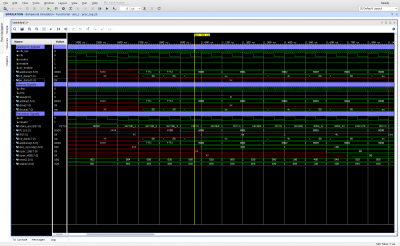

I've been developing a cycle-accurate 6502 core that I plan to implement in a Xilinx FPGA using the internal block RAM as the full 64KB address range. The design uses two clocks, one for the processor and another for the memory, which runs 10X the speed of the processor. To test it, I've been building memory maps containing instructions that I've manually placed throughout the file. Right now the program is extremely simple:
8000: EA EA 4C 00 80 EA EA ....
FFFC 00
FFFD 80
The general idea is that the processor comes out of reset, gets the reset vector, and then just executes two NOP instructions followed by a JMP over and over. I'm having a hard time figuring out if the timing is correct though - does anyone see anything wrong with what I've got now? The code for it can be found here: https://github.com/gmcastil/6502.
PostPosted: Fri Jul 14, 2017 4:31 am
Nice project! I haven't studied your waveforms very closely, but for comparison here's how to use visual6502 for this kind of question:
http://visual6502.org/JSSim/expert.html ... ogmore=res
Edit: it looks like JMP should take three cycles, but you have five.

DECODE and OPER_A1 happen in the same cycle. The 6502 always fetches the second byte of an instruction, wether it is needed or not. The decode (PLA) then decides, wether the PC must be incremented or not. So after a one byte instruction the next instruction is fetched a second time.
EXECUTE and the next FETCH happen in the same cycle. If you need to run a byte through the ALU it happens in parallel with the next instruction beeing fetched. In case of the JMP abs EXECUTE is not needed. The address is plugged into the PC without going through the ALU. I am not sure however, if the 6502 skips the EXECUTE part or if there is a dummy EXECUTE with the next FETCH.
There is more parallel operation when it comes to address generation. Address generation also needs the ALU. For example: During indexed addressing the index is added to the low address during OPER_A2. If the result has a carry (page crossing) then an extra cycle is needed to add the carry to the high address.

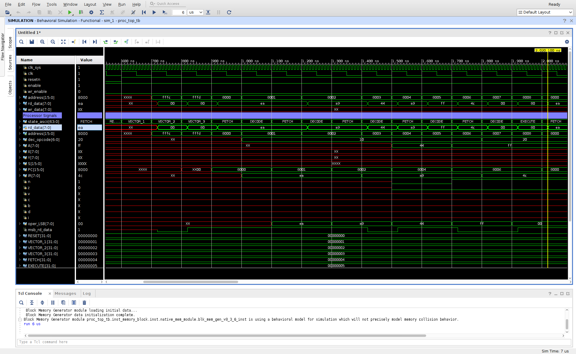

Yep, I noticed that - I went back and removed some of the states I had and I think I have it now. I'm posting a revised waveform.

Thanks for taking a look - I revised the FSM and pipelined everything so that I'm basically always reading one state earlier than I need it. Check out the updated waveform and the code here: https://github.com/gmcastil/6502/blob/master/src/proc.v.

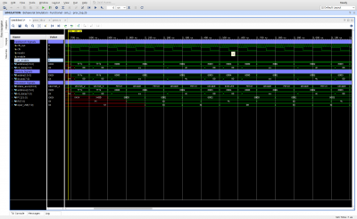

So I've got the following program at $8000:
8000: NOP
8001: NOP
8002: LDA #$44
8004: LDA #$FF
8006: JMP $8000
Does the timing look correct for what I've implemented so far? If it looks good, I'm going to take a little bit of time to start working out some regression tests to add to the core so that as I add more features and support for more opcodes, I can make sure I don't break something. Also, if anyone has any additional suggestions or advice, I'd really appreciate it. Thanks.

I think that's right. There's already a number of 6502 test suites. See
