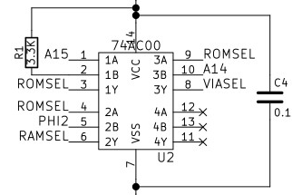

It would be convenient if you could post the schematic here instead of making us deal with Github. I'd like to help but have never had much success getting anything from that site.

Gladly! Nice to make your acquaintance, BDD. There's now a JPEG of the schematic in the repo here: https://github.com/contrarian-computing/pinky-8/blob/master/pinky-8.sch.jpg

(A small note—monochrome, black lines on white background, seems best for diagrams. BDD is one of our colorblind members. He can correct me if I'm wrong, but I think the light green disappears into the white background for him.)
Good call, I've updated the JPG in the repo: https://github.com/contrarian-computing/pinky-8/blob/master/pinky-8.sch.jpg

Some things I noted:
  • You have BE, NMI(B), RDY and SO(B) all tied to the same pullup resistor. RDY is a bi-directional pin and should be on its own pullup. If the 65C02 executes a WAI instruction it will drive RDY low, which in turn will drive the others low, causing the MPU to high-Z the buses, think it should service a non-maskable interrupt and set the overflow bit in SR (status register), all at the same time. Just think about how confusing that would be to the MPU, not to mention the poor bloke who's trying to get the contraption working. :D
    Now, you may not have used WAI in your code, but a program error could cause the MPU to encounter $CB and think that it is a WAI instruction opcode.
  • You have pins 12 and 13 of U2 unconnected, leaving those inputs floating. That is a no-no with CMOS hardware. You should either ground them or pull them up to Vcc.
  • Are you sure that USB power source you are using to run your machine has enough nuts for the job?
  • A design hint for the future: the first gate in U2 is being used as an inverter. You can delete R1 and instead tie pins 1 and 2 together, thus saving on a part and a little bit of PCB real estate.
  • A second design hint for the future: do not use the clock outputs of the MPU. WDC doesn't test the performance of those outputs and in fact, doesn't even state how much they lag the clock input, how hard they drive, or the rise and fall time. All clocking should be derived from your Ø2 oscillator (X1).

Echoing BDD's last point I was having a whole stack of stability problems with my own 1st design that I couldn't figure out for the life of me. Cutting the trace from the MPU's Clock output and driving everything directly from the oscillator can fixed that.
Re: Pull-ups, any WAI instructions will also generate an NMI immediately as it shares the same pull-up
If I'm interpreting this correctly, your address decoding is going to select the RAM whenever the VIA is selected too, any time you write to the VIA you're going to write to the ram too?
Your ROM CE and OE are tied together, you can instead tie CE to ground to save a bunch of time for ROM accesses, looking at the datasheet the CE access time is 70-90ns while OE is 30-40ns though doing so will increase power consumption as the rom will never go into standby mode.
Yes. That's a subtle part of doing the entire address-decoding scheme with only three sections of a 74xx00. There's 16KB of addressable RAM; but there are no 16KB SRAMs, so you use a 32KB. When you write to I/O, you're also writing to the upper half of the RAM; but it doesn't matter, because it will never be read out and cause bus contention, because anytime A14 is high, the RAM's output will be disabled. I've been using that scheme on my workbench computer for 24 years.
I made poor assumptions about the independence of gates on the 74xx00. Remedied it with bodge wires but it wasn't sufficient to fix the stack corruption. Again, thanks for the correction - it'll be in the next PCB revision.
Makes sense! I don't know why I didn't do that...perhaps I was worried about additional load on A15?
So this, it turns out, was root of the problem. The best places to cut the traces from the '02's PHI2O to the 74AC00 and 65C22 were under the sockets so I started over on a second board, transferring components from the first. With bodge wires in place to transmit the clock directly from X1, I'm no longer seeing stack corruption and spurious BRKs. PHI2O must be sufficiently out of phase to cause RAMSEL to be low at an inopportune moment. Without an oscilloscope it's hard to dig deeper.

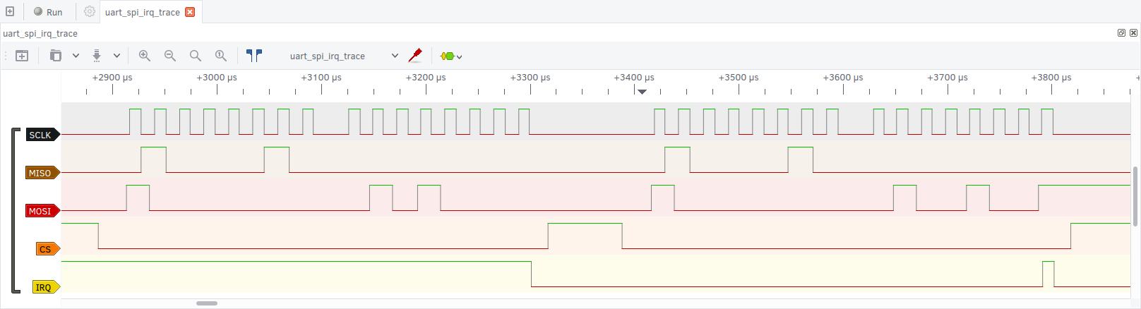

PostPosted: Tue Jul 11, 2017 11:08 pm
Joined: Mon Jul 03, 2017 1:15 am
Posts: 6
Which UART are you using?
As I was working from Garth's primer I used the MAX3100 SPI UART he recommends. It's flexible, has a simple interface and comes in a breadboard-friendly package for prototyping. I had a lot of fun writing the routines to big-bang a duplex'ed SPI interface using the 65C22.
It took me a while to get everything working with the PiGFX UART, mostly because I didn't trust my own ability to properly interface with the MAX3100. Characters weren't showing up on the Pi and I couldn't figure out what the problem was by inspecting my code. I decided I needed to get serious and invest in proper hardware development tools, so I bought a 32-channel logic analyzer and proceeded to port the entire Sigrok open-source analysis suite to my Linux distribution of choice, which is Solus. After doing this I got some very nice traces out of the 65C22 and MAX3100 which showed that my SPI routines and the MAX's UART were spot on. Only after spending a week on this did I Google issues with PiGFX and discover, from an archived mailing list discussion, that I was simply using an incompatible version of the the Raspberry Pi's bootloader. Swapped one file on the SD card et voila, everything worked as it should.
File comment: 65C22 bit-banging SPI to MAX3100 sending the first two characters of 'PINKY-8'
