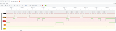

As I was working from Garth's primer I used the MAX3100 SPI UART he recommends. It's flexible, has a simple interface and comes in a breadboard-friendly package for prototyping. I had a lot of fun writing the routines to big-bang a duplex'ed SPI interface using the 65C22.
It took me a while to get everything working with the PiGFX UART, mostly because I didn't trust my own ability to properly interface with the MAX3100. Characters weren't showing up on the Pi and I couldn't figure out what the problem was by inspecting my code. I decided I needed to get serious and invest in proper hardware development tools, so I bought a 32-channel logic analyzer and proceeded to port the entire Sigrok open-source analysis suite to my Linux distribution of choice, which is Solus. After doing this I got some very nice traces out of the 65C22 and MAX3100 which showed that my SPI routines and the MAX's UART were spot on. Only after spending a week on this did I Google issues with PiGFX and discover, from an archived mailing list discussion, that I was simply using an incompatible version of the the Raspberry Pi's bootloader. Swapped one file on the SD card et voila, everything worked as it should.
65C22 bit-banging SPI to MAX3100 sending the first two characters of 'PINKY-8'
