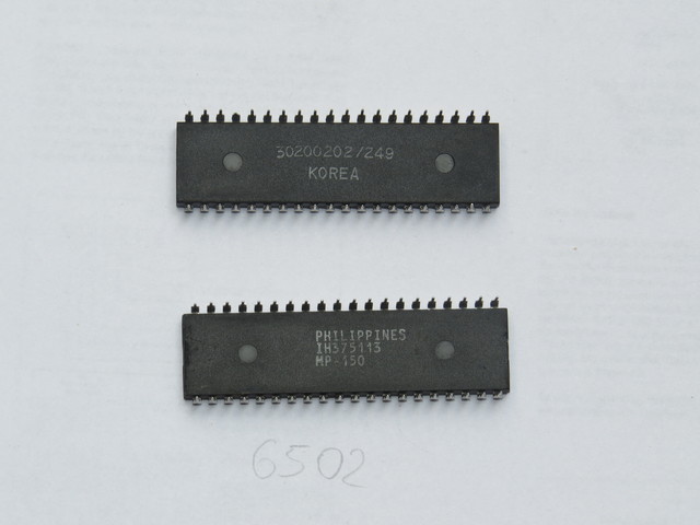

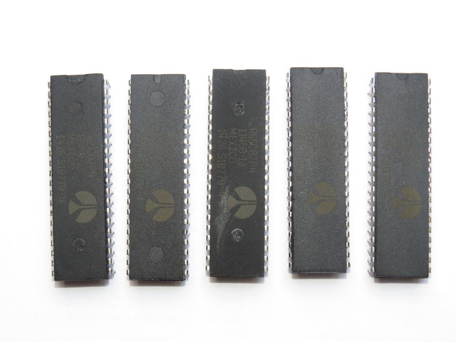

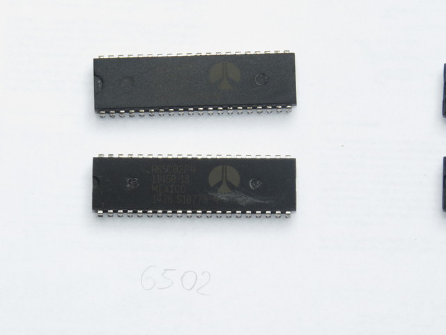

While I was getting materials for my computer, I stumbled upon some 4MHz Rockwell 65C02 chips, allegedly produced in 2014. Hmm. The same seller had NMOS Rockwell 6522 chips, also produced in 2014. Do I smell a fish? Or maybe I am wrong?
I ordered some: "5pcs" of R65C02P4. Here is what I got (they shipped very fast):

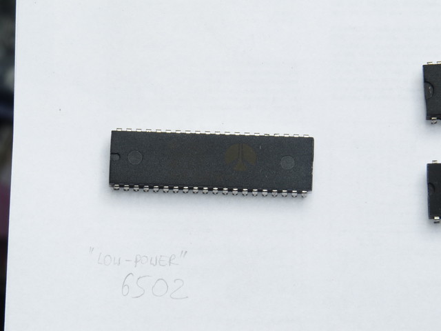

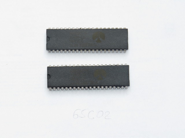

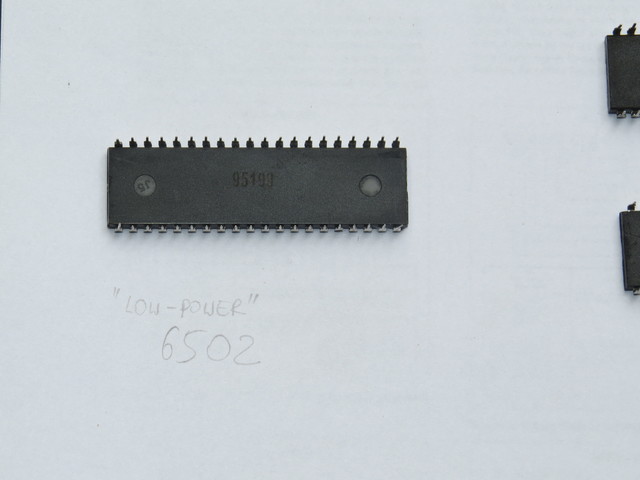

As you can see, every package is slightly different. Some have those two shallow holes near the ends, some do not. I tested them. Three chips appear to draw less power than other two (those act just like my old MOS6502AD). I tested them for BRA instruction: NMOS 6502 treats it as NOP with operand. Two chips appear to be real 65C02, three are 6502. One of them is "low power" though, drawing same amount as 65C02s do.
This one was also able to run at 6.667MHz, all the others (including my trusty MOS6502AD) were able to reach 5.333MHz. Tried searching for "CMOS 6502 without BRA", but you can imagine what are the results :)

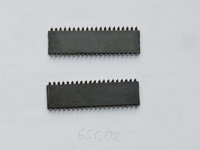

Let's take a closer look at the chips now:
Bottoms are scratched, notches at the edge all look different, there are signs of sanding on tops, some corners are rounded too. Leads are shiny, not mat, as it is the case of new WDC parts. Also: MEXICO on top, KOREA / PHILIPPINES on the bottom. Right. Are those real chips? Yes. But not new, and labels on top are bogus.
https://www.youtube.com/watch?v=j9nasajve1o

Not really fake, then, but (probably) recovered from old equipment and not very carefully screened and labelled - the sellers not too concerned about the difference between 6502 and 65C02.

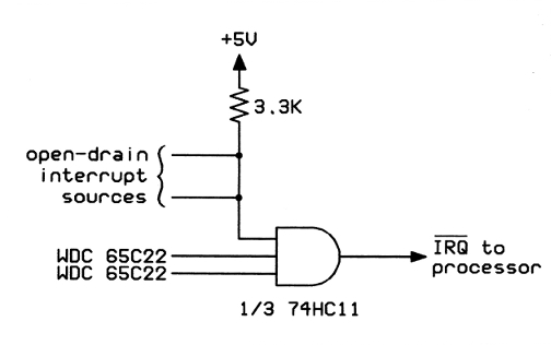

The 1N4148's forward drop is too high to reliably pull the MPU's IRQB input down to where an interrupt will be recognized. This is where a Schottky diode should be used, such as the attached.
Another method if you have multiple 65C22s is to wire each one's IRQ output to an input on a multi-input AND gate, and let the AND gate drive IRQB. One of the gate's inputs should be reserved for a wired-OR interrupt circuit to take care of devices with open-drain IRQ outputs. The below illustration, copied from Garth Wilson's 6502 website, shows how to do it.
File comment: Mixed IRQ Circuit
However, I would use a 74AC11 or 74AC21, not a 74HC11.

74AC logic is generally three to five times faster than 74HC, plus can source and sink more current. The only thing you have to be mindful of when designing with 74AC are the extremely fast output rise and fall times.
Using some programmable logic could make identifying IRQ sources simpler (reading one register), not to mention guaranteed delays. Just a thing to consider for the future, and there is a pretext to.
As the design gets more complex it becomes more difficult to implement all the desired features with discrete logic and not hit a performance wall due to cascaded propagation delays. A CPLD gives you much more predictable performance, as well as the ability to handle complex logic without having to use a washtub full of gates.
