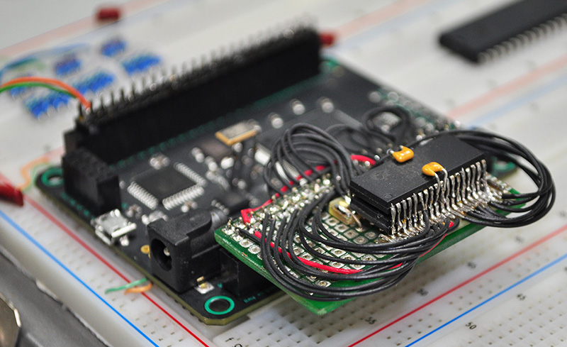

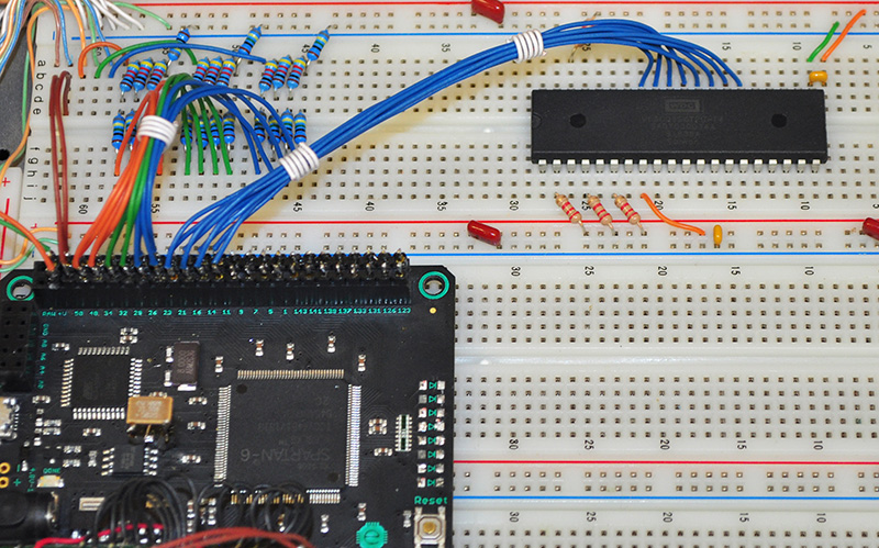

Here is what I have done so far...

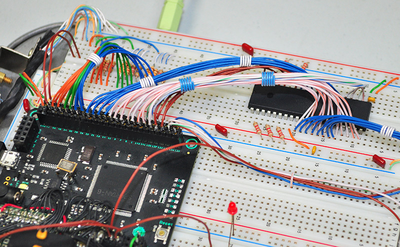

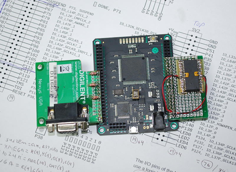

An FPGA board with a Spartan-6 will be become the "Chipset".
I will eventually move to an Artix-7 FPGA, but for now will work around the slower Spartan-6.
By doing V1 using lesser parts and as more of a "hack", V2 will be guaranteed to work!
For now, I just slapped down two 512K 10ns SRAMS, but will eventually add eight so I have 4MB in total.
Fast SRAM is important since my bus sharing system will be intense, sharing the memory with...
1) The 6502 - gets access to all non protected SRAM whenever the GPU is not using it.
2) The GPU - gets exclusive access whenever a graphics command is issued by the 6502.
3) The Sound System - grabs 4 bytes on each horizontal line for its 4 voices.
4) The VGA Generator - Reads a line of 400 pixels @ 40 MHz so it can send them later at a slower rate.
If you thought the bus sharing and timing in a C128 was hairy, just wait until I detail this beast.
The bus arbiter inside A65 will be like an 8 bit digital orgy!

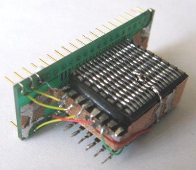

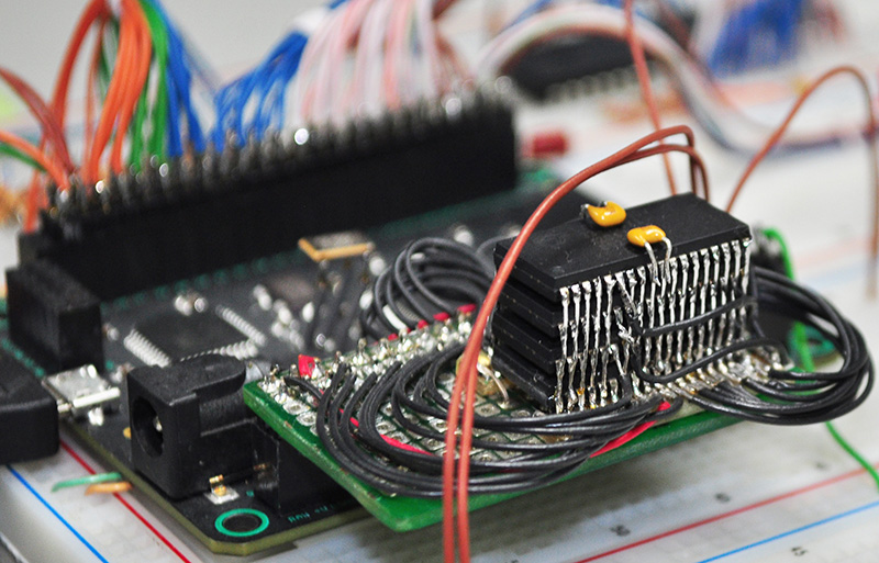

Here is the SRAM wired to the carrier board. Did I mention that V1 is a total hack job?...
1 MB of fast SRAM, soon to become 4MB using 8 ICs instead of 2.

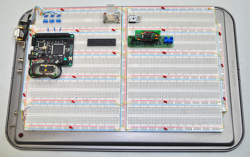

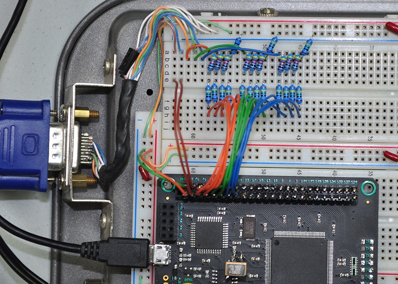

Here are the separate components that will make this system work.
Wow, this breadboard looks so tiny compared to my other MOABBs....
The different components that will make up Anvil-6502.
Starting from the top left, the components on the board are as follows...

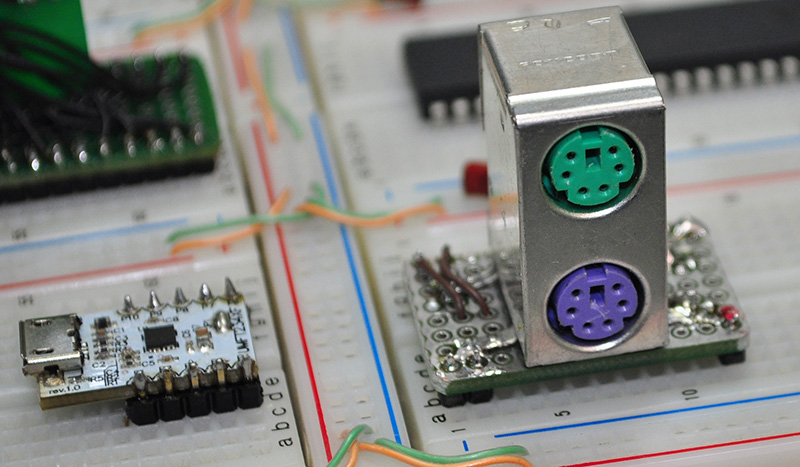

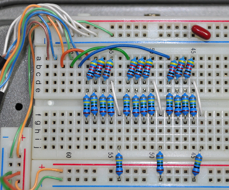

1) R2R resistor DAC to generate 4096 colors using a RRRR-GGGG-BBBB color space.
2) A PS2 keyboard port ripped from a mainboard I found at the local dump.
3) An FTDI USB to serial DIP board that will allow importing and backing up internal data.

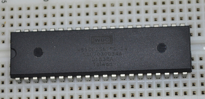

4) The MOJO-V3 FPGA board that will host my Verilog GPU code.
5) The one and only 65C02, as delivered from the Western Design Center.
6) An AVR that will talk to the mass storage device (probably an SD card).
I will start soldering up wires as soon as the rain drives me indoors for a few hours.

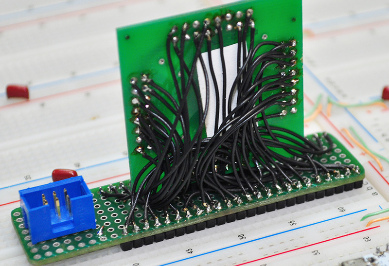

Most of the key components I already have mounted to carrier boards the fit the breadboard, so it will be just a matter of wiring them together. The real work will be in creating the HDL for the GPU, and then making all of the external systems talk to each other at high speed.

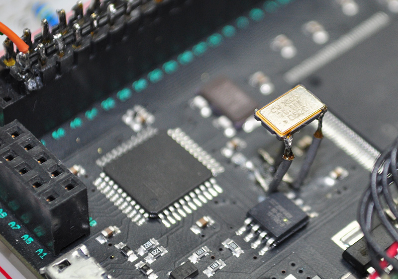

The MOJO board came with a 50MHz oscillator, but I prefer a 20MHz for VGA applications.
Using the PLL is easier this way, as there are no divisions, just clock multipliers.
In this case, I am going to start with 20MHz X 2 for a 40 MHz main clock.
Once things are working, I will try 20MHz x 3 for 60 MHz, but that may be too fast.
The external SRAM is 10ns, but considering setup and hold for a 2 way trip, 60MHz may not work.
Another ugly hack. Ocsilator standing on wires after I razored off the traces...
The FPGA oscillator is now 20Mhz

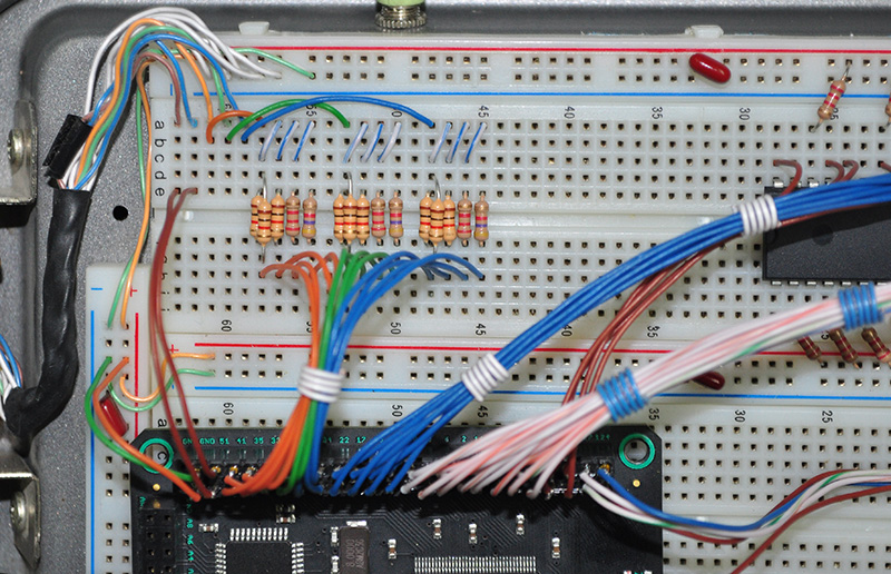

Threw a 12 bit DAC together as well...
Each of the 4 bit segments can generate up to .75 volts.
Each of the primary colors has 4 bits, so I can have 16 shades of 16 colors for a uniform palette.
A65 will have a fully programmable palette as well so I can create any 256 of 4096 possible colors.
This will allow of color cycling effects and demo effects like plasma.

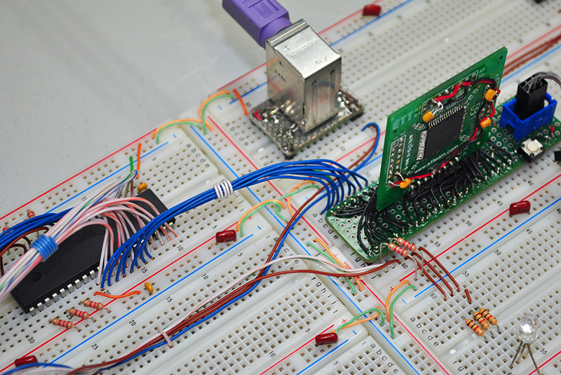

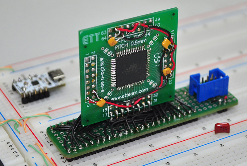

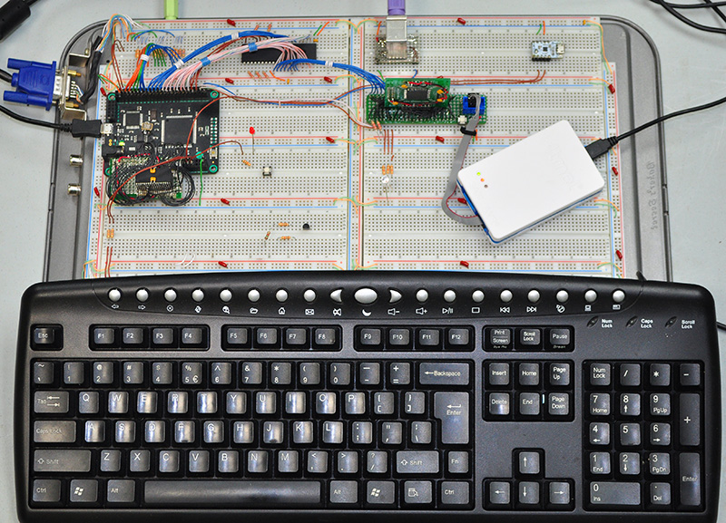

In order to load up the 6502 during development, I am using my DIP adapted Atmel Xmega-384...
This is my rapid development superstar - 384K with a programming plug.
This uC is way overkill, but it does have 384K of program memory, so I am using it as a fake SD card right now.
To develop my OS and IDE, I will code on my PC using the great Kowalski Assembler, then load the through the AVR to the 6502.
Once the IDE and OS are working, they will be pre-loaded to the 6502 SRAM at power up by the FPGA.
In the completed design, the AVR will only have the task of streaming bits from the SD card to the 6502 OS.
At that point, I will choose a very small AVR, as I only need 10 IO between the FPGA and AVR.
You can also see the USB to serial adapter board in the background.
This will allow importing of assets such as sound data or graphics data from a PC.
Backing up of 6502 created SD cards to a PC for sharing will also be possible.

Here is the spaghetti side of my ultimate breadboard AVR...
48 IO lines and a programming port.
I made this thing because I am always needing to load SRAMs with data, mostly on 6502 projects.
I can cram about 383K of data into the XMega, and it can stream this to any SRAM and then hide.
Right now it is holding the code for what will become my A65 OS, called BMOS... Bare Metal Operating System.
I have a PC program that takes the Kowalski Assembler output and then sends it to the XMEGA.

Here is my PS2 port and the USB to serial chip that will deal with all IO.
I am only using a single PS2 port, as I have no use for a mouse in A65.
... real programmers type in their code and don't need to click ****!
Here is the guest of honor...
65C02 as made by The Western Design Center.
Normally, I overclock EVERYTHING, even if it isn't necessary, but not this time.
I will run the 6502 at 8Mhz, which is well within the legal limit.
I have developed an interesting clocking scheme to allow optimum 6502 performance and memory sharing.

Finally, things are starting to look real, as wires get soldered onto the header pins...
The VGA port is now wired to the board.
The wiring above is all that is required to drive any VGA monitor.
Horizontal Sync, Vertical Sync, and the Color Bits.
I am reworking the VGA generator from my Fusion-6502 project, so I already know it works.
VGA is drawn as 400x300 pixels over an 800x600 VGA standard screen by dividing by two.
The generator can also do 800x600, but that is just too much screen for a retro system.
Look who came to the party...
The 65C02 gets jacked into the Matrix.
Normally, I develop everything first and then drop in the 6502, but this time I am doing it the other way.
Since the FPGA will take commands from the 6502, I need code running on the 6502 right away.
There will be no help from the AVR of FPGA when it comes to the OS... the 6502 is driving the bus!
I still have some address lines, and the data transfer lines from the AVR to connect, but that's about it.
6502 code will be up and running as soon as I get the FPGA boot sequence and SRAM stuffing code done.
I look forward to having a 6502 based computer again.

Scattered showers so far this morning, I I managed to get some soldering time in.
Since everything hinges on having the 6502 up and running, I completed the adress bus and control line...
The 6502 is now fully connected to the Chipset.
This nice thing about FPGA design is that an IO pin is nothing until you define it.
For the most part, you just connect wires and then tell a pin what it is anywhere on the device.
A65 will use almost all of the IO on the Spartan6 144 pin device, so I won't need a BGA package this time.
Here is the 6502 part of my "UCF File", which is the file that tells the FPGA what IO pins do what....

I also noticed that a used my 5 volt DAC design, which runs too "cold" for 3.3 volt operation.
I find that the best voltage for analog vga is fomr 0 to .75 volts, just a bit more than the spec.
I adjusted the resistors to get the proper voltage at 3.3v operation...
The new RRRR-GGGG-BBBB DAC is much closer to the analog spec.
Since I had the soldering iron hot, I decided to stack on 2 more SRAMs so I have 2MB to work with.
A65 will eventually have 4MB, but 2MB is more than enough to test everything out.
The 3-8 multiplexer is made in the FPGA, so no external IC is required, just one line of simple code.
512K SRAM stacked 4 high makes 2MB of 8 bit memory...
Parallel memory with their CE lines running to the FPGA
Here is the current prototype setup, hardware complete.
This should all fit nicely on a small PCB when ready...
A blank 6502 computer waiting to be defined.

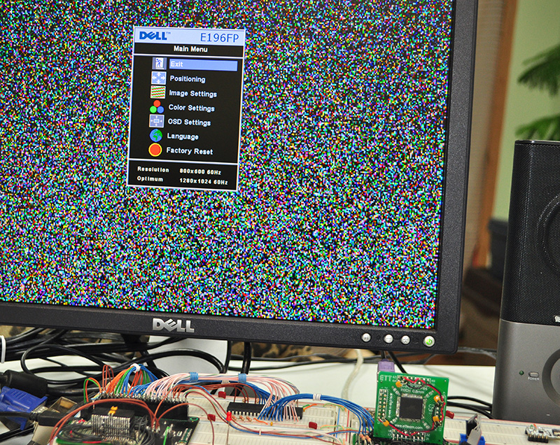

I dropped in my VGA Generator code, and redid the SRAM IO definitions.
Withing a few minutes, my monitor showed the 120,000 random pixels in the Video Buffer Memory...
Hello World... GPU Style.

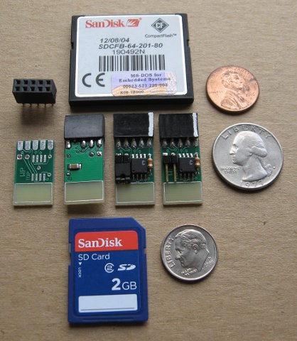

Ten months ago, I started a topic on super simple file systems for flash, at http://bradsprojects.com/forum/viewtopi ... =17&t=1233 . It's on the Brad's Projects forum rather than here since it was not 65-related, but in your case it is, so go ahead and discuss it here on 6502.org, and/or discuss over there. [Edit, spring 2022: Something about the Brad's Projects forum is broken, and Brad says he doesn't know how to fix it; so it's apparently not possible to post there now.] BDD and Ed were helpful, although I have not carried out the plan yet. I hope you do bring more discussion about it. I will be using my SPI-10 flash modules shown on the front page of my site and in the middle of this picture:
Here's my first try at a 4Mx8 SRAM module, pretty much like yours:
Now of course I offer the PCB-based module on the front page of my site, with 4 ICs on each side, and the bypass capacitors in the board, under the ICs. Even though they're not stacked, the module actually takes less space this way.

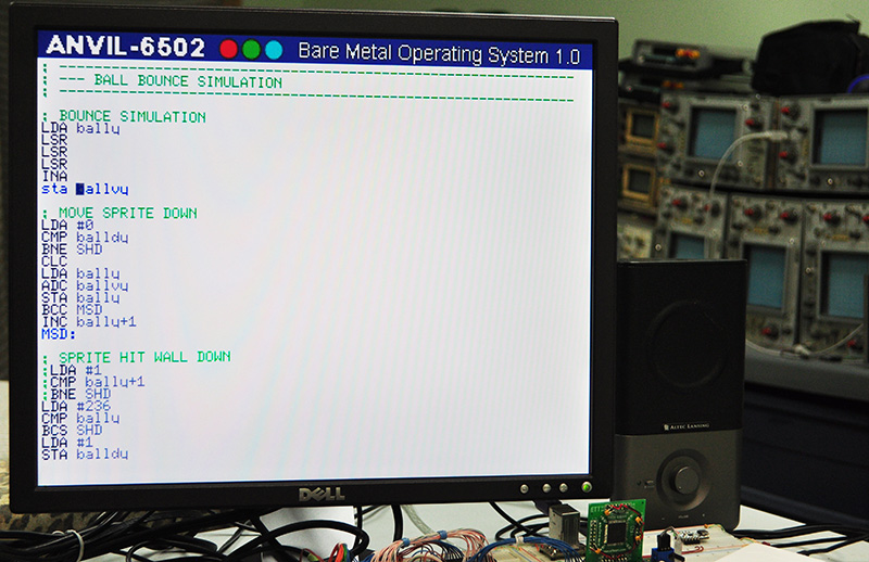

This is what I managed to get done tonight...
1) The 6502 can now boot it's OS code on power up.
2) I have a workng (but very basic) IDE that can display and colorize source code.
3) The OS can do a simple assemble into another bank above the OS code space.
4) The OS can then swap to that bank and execute the assembled code.
5) The chipset can swap back to the OS when I press ESC-F1 on the keyboard.
Everything is controlled now by the 6502. There is no other processor or uC running.
I cannot edit the code in BMOS yet, just scroll around in it and then press F12 to assemble and run.
This is a great amount of progress though, as it completely proves out all of my ideas and untested code.
Most of my code was done in fragments (Verilog / 6502) in notepad on my lunch breaks!
BMOS is far from done yet, but here is what gets displayed on my screen right after power up...
Source code auto displayed and formatted directly from SRAM.
The square block is my flashing cursor, and it does the typical XOR type thing to the text.
All code is stored in the SRAM as a color and character byte. BMOS formats the line.
My font is not perfected yet as you can see by the cut-off small case Y on the screen.
I can scroll through 32,000 lines of code!!
That should be enough code for any 6502 program.

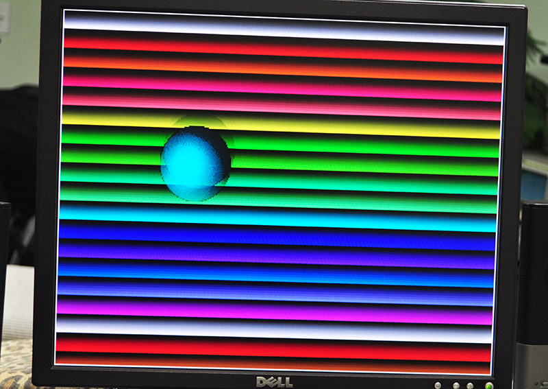

When I press F12, BMOS reads the code and assembles it to the "EXE" bank...
The assembled program running in another bank in the SRAM!
The assembler is very basic at this point as well, and only about 1/4 of the 6502 instructions assemble.
It is enough to make the basic Ball Bounce Demo though.
