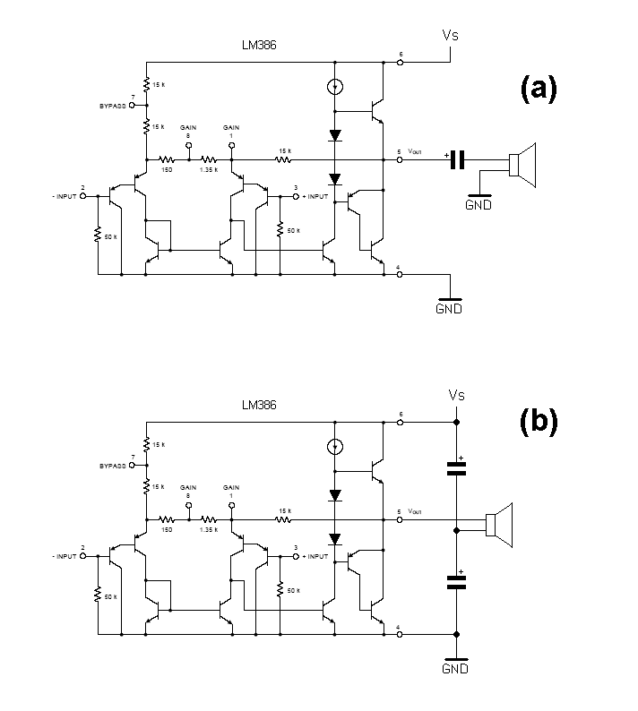

Whilst looking through some old magazines (1968 to be exact), I found a cure for the turn-on thump created by IC amplifiers.
The thump is caused by the speaker coupling capacitor charging through the speaker.
To cure the problem, connect two capacitors in series across the power supply. Each capacitor should have a value half that of the normal speaker coupling capacitor. Then connect the speaker between the IC output and the junction of the two capacitors.
At turn-on, the capacitors charge in series from the power supply and no charging current passes through the speaker if the two capacitors have the same value. In practice this greatly reduces the turn on thump.

Remember that there's unbalanced preceding circuitry feeding the power amplifiers' inputs which will also cause a pop. A bridged amplifier shouldn't cause its own pop, but it will faithfully amplify the pop fed to it at its inputs, unless there is some kind of power-up mute feature.
You've described it nicely, though.
To cure the problem, connect two capacitors in series across the power supply [ as in (b), below ]. Each capacitor should have a value half that of the normal speaker coupling capacitor. Then connect the speaker between the IC output and the junction of the two capacitors.

A problem with that is that the power supply may not be very quiet. Even if it's a regulated linear supply, the regulation may not be as quiet and tight as you'd like, and you may be referencing your speaker output to signals or noise from other circuits. For the same or less board space though, you can use two 386's per channel in a bridged configuration (eliminating the output capacitors) and connect the - input of one to the + input of the other and vice-versa. You'll get four times the maximum output power. It also takes care of the problem of the power amp itself producing a pop, but not the circuitry that precedes it and feeds its inputs.
