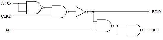

Sleeping on this I think I only need to do the following:
7F0x = /7F0x NAND /7F0x
/BDIR = 7F0x NAND CLK2
BDIR = NOT /BDIR
/BC1 = A0 NAND BDIR
BC1 = /BC1 NAND /BC1
The reason I don't need CLK2 for BC1 is that if CLK2 is low, then /BDIR will be high. This is in turn inverted which yields a low BDIR. Since BC1 is essentially ANDed with BDIR I know that a low BDIR will result in a low BC1.
This means I only need to use the one unused NAND gate and a single transistor inverter.
Update: added a schematic.
BDIR = NOT /BDIR
/BC1 = A0 NAND BDIR

Re: Connecting a AY-3-8910 to the 6502 bus.
BDIR = NOT /BDIR
/BC1 = A0 NAND BDIR
BDIR = NOT /BDIR
/BC1 = A0 NAND BDIR
PaulF wrote:
Yes, this will work correctly. Good luck!
