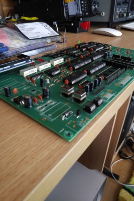

Hi!
I've spent a couple of days designing my first board (after messing about with a bit of breadboard so I almost know what I'm doing) using some of the info on here and around the net as well
Haven't done this before so it seems like an interesting project to do and learn stuff whilst I'm at it
It probably won't work (see attached pic) when I get it back from the fab, but that's all part of the learning expierience! :D

It's beautiful, Ian! And it's a very ambitious first attempt. You have my sincere congratulations if it works, and my condolences if it turns into an expensive paper weight.

Do you have a schematic you can post as well ?

Welcome! I'd be interested to know more about the memory map and system architecture. Looks like you have big ROMs and a big RAM for each ROM - some kind of multi-tasking idea?

I do see something about the physical PCB layout that might cause a bit of trouble. There are a lot of filled planes in between traces and furthermore, it appears they are not grounded. Grounded fill planes on the top and bottom layers are usually poison to good AC performance. Ungrounded planes are even worse, as they act like antennae and radiate noise all over the place. Filled planes serve no purposes in a digital device except to muddy up waveforms. I'd get rid of them if it were my design.
That's a bit strong. I make all my boards with ground pour on top/bottom layers, and I've never had a problem, even at 100 MHz frequencies.
I do agree that you want to avoid disconnected islands. The first step would be to place the traces so they don't needlessly cut the planes into pieces, and second step would be to stitch top and bottom planes together with vias. Also, make sure the traces, vias and clearance are set correctly so you don't have overly big gaps.

Yes on the ground planes - it's only the top pour which didn't get grounded (the bottom one did). The board is already in the process of getting fabbed and I'm not to worried at this point about it, but yes the next version will be fixed (and better checked for that) as well as all the improvements I've learned from the first iteration

Boards arrived today - lots of checking to do then lots of soldering! :-)

Hmmm. It's understandable if you're eager and are feeling inclined to do all the soldering at once. But you might want to consider a staged approach instead, as follows. First do only what's needed to get the 5 Volt supply working (and see that it does work). Next solder only what's needed to run a NOP test (ie, CPU in place but no memory or I/O), which will let you verify that the address & data buses are free of shorts. Then solder and (again using the NOP's) verify that the memory decoding is working as planned. And so on. At each stage do only what's needed for the next test.
In the event of a problem there's reduced risk you'll have to un-solder anything (as may be necessary to access the traces under an IC socket).

I'll second what Jeff suggested. That's the approach I use and it's never failed me.

Unfortunately not the road I'm taking this time... Important logic is socketed though, and will be fairly straightfoward to debug (have most of the kit to do this fortunately). The only big issue is if I need to do track mods (it's a 4 layer board) though there are ways around that too for the prototype.
Ran out of parts for the moment, the rest of the PSU side and missing chips come next week from mouser so hopefully I will be able to post more progress here once I've done that (unless you think I should move it to another thread, which is fine just let me know). I'll post more as I get things working and also any 'learning' mistakes :)
