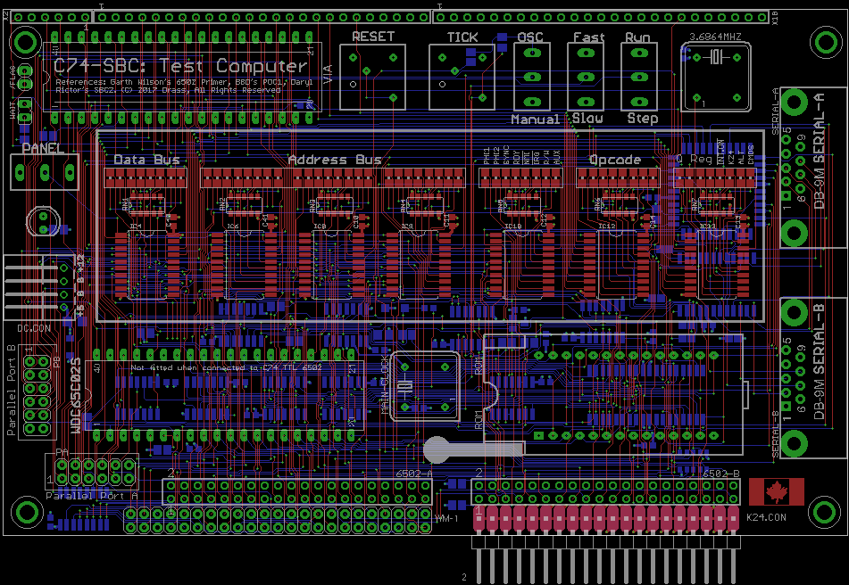

I've been making some progress on finalizing the SBC. At Dieter's suggestion, I changed the 6522 VIA to a DIP package and added a little address decoding logic to accommodate a 6526 being used in it's place (the 6526 has a /FLAG input signal on PIN24 where the 6522's CS1 positive logic chip-select is. A pull-up on pin 24 plus the added glue logic makes the socket compatible for either a 6522 or a 6526).
It took a little re-routing to manage the much larger DIP package and the DIP pads ended up making a rather lively frame on the silkscreen title. All in all, it was all done in reasonable order:
Other changes included adding a jumper to make WAIT states on peripherals optional, and other fixes and clean up items. I'm going to do some final desk checking and I'll post up a final schematic shortly.

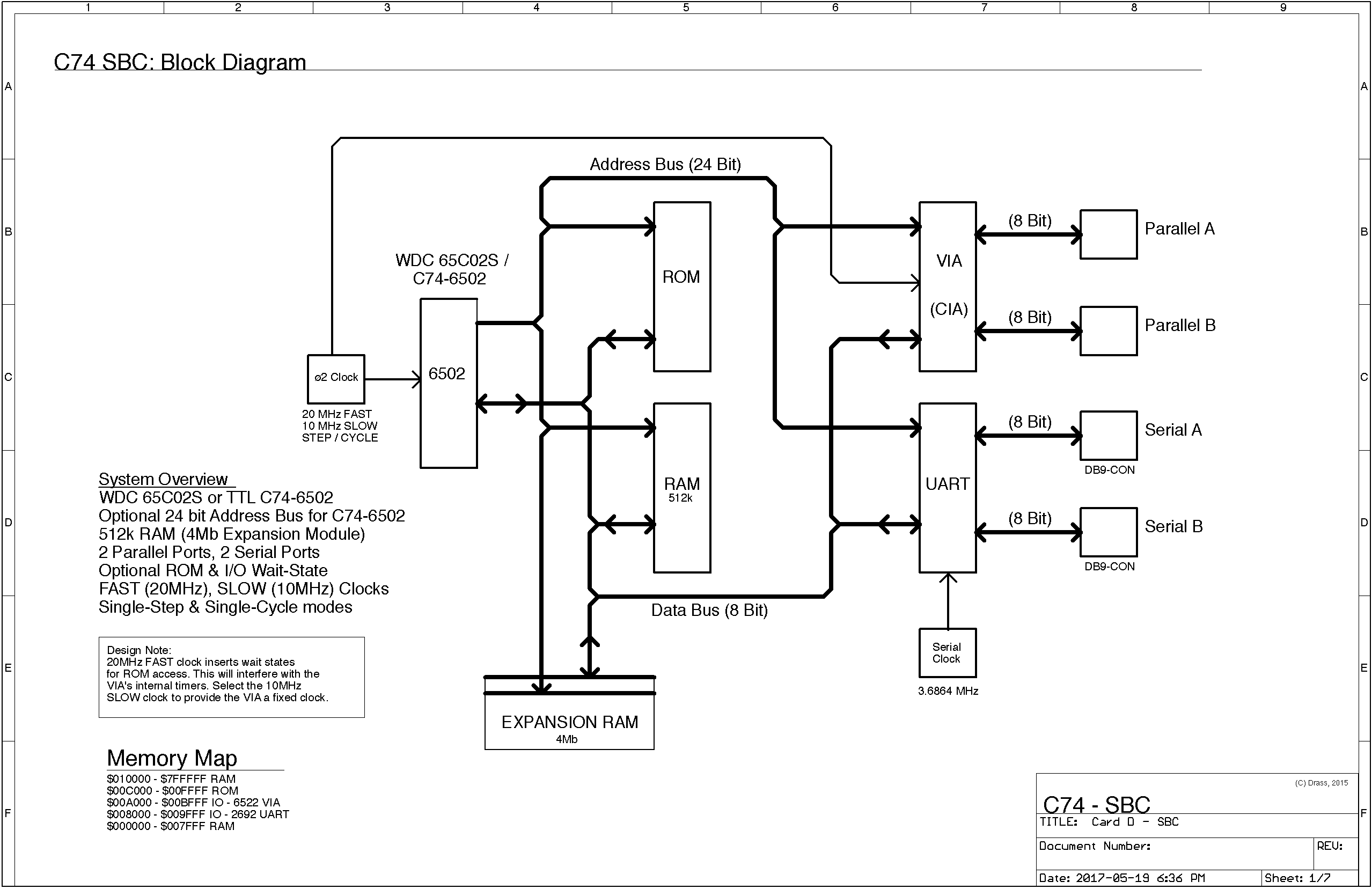

While validating the ROM cycle-times on the SBC, I noticed an unfortunate side-effect of my implemetation of wait-states. Rather than using RDY to pause the CPU (as I had seen in other designs), I opted instead for stalling PHI2 for a cycle. It seemed the simpler option, and allowed RDY to be reserved for the Single-Step clock. However, the SBC has an on-board VIA which relies on the clock, so pausing PHI2 makes real-time processing with it all but impossible. Something as simple as a regular IRQ from the VIA will have variable timing, depending on whether a wait-state happens to be triggered by, say, a ROM access. Thankfully, the SBC can disable wait-states with a jumper, or by switching to the SLOW (Div 2) clock under software control. That will do, but in truth I would have preferred the more elegant RDY-based wait-state design.
On another note, I stumbled upon Garth’s WM-1 memory expansion module, which seems a very fitting way to put the TTL CPU’s 24 bit address bus to work. After a quick chat with Garth, I added a WM-1 pin-header to the SBC, and thereby equipped it with an optional 32Mb RAM expansion card - nice! A freshly made WM-1 module is on it’s way and it's going to be a lot of fun to get that going with the TTL CPU once built. Thanks Garth!
Beyond that, there were a few more changes: I swapped the 70ns DIP ROM for a faster 45ns one and the 128k RAM chip for the same 512k variant Garth uses in his memory module. I also had to move the DIP VIA from the underside of the board to the top layer as it would bump up against the microcode-ROM PLCC socket on the Registers Card below when mounted on the TTL CPU. And finally, I was able to tidy up an issue with the STEP clock which would have caused problems at faster clock rates. Naturally, all that meant lot's of re-routing of traces :roll:
I think that may be it for changes. The PCB mockups look pretty good now: :D
The two 40-pin receptacle headers shown above actually go on the bottom layer and will connect with the TTL CPU below. The glue logic and UART are on the bottom layer as well, and those footprints check-out nicely:
Taking a look at manufacture: I decided to go back to OSH Park since I’m not panelizing and it looks like PCBWay.com may have a challenge with the vias I’m using (10mil drill, 4mil annular ring). I can probably make the SBC work with larger vias, but certainly not the other cards, so I’m sticking with them for now. (Not sure I like the purple OSH Park PCBs though - what’s wrong with the standard green?)
OSH Park takes Eagle BRD files directly, which is nice, but I also tried to generate the Gerber files. I’m not sure that’s working correctly as the gerber viewer (Pentalogix ViewMate) shows all the pcb data miniturized on the bottom left corner of the pcb while the remainder is blank. Some sort of scaling issue which I’ll have to sort out. If anyone has run into something like this with Eagle, please let me know.
Latest schematics, and what I hope may be the final layout attached. (Incidentally, I added some additional parts to the schematic and put in sourcing info so the BOM is complete. As it stands, the BOM Eagle generates uploads directly to Digikey, which is nice)
Cheers!

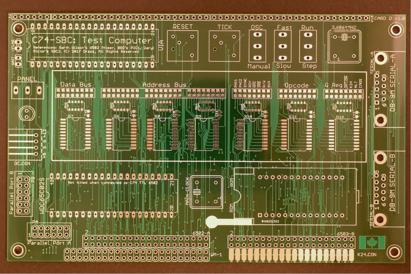

As you'll notice: green solder mask, rather than the OSH Park purple and gold. pcbway came back saying they could manage the via sizes after all, and it certainly seems that way from what I can tell. I wanted to given them a try just in case I do end up looking at a panel later on, and, I have to say, the pcb looks quite nice. Of course, I can immediately see things I might have done differently, but I'm very happy on the whole. :D

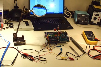

While the pcb was being made, I took some time to set up a little work space and get some tools sorted out ... power supply, soldering station, rom burner, etc. Very nice to get these things going. I've been putting in some practice with one of those SMD soldering kits as well. Things were quite dismal at first, but I'm beginning to get the hang of it. The biggest issue was using too much solder (and not being able to see the darn things!). It all proved much easier with smaller diameter solder and a magnifying glass. It's going to take a little time, and lots more practice, but it's beginning to look feasible. I may yet conquer those 0603 caps! :)
That's it for now ... can't wait to get started on the real board!

In the meantime, here is a pic of my workspace with the specimen under observation ...
